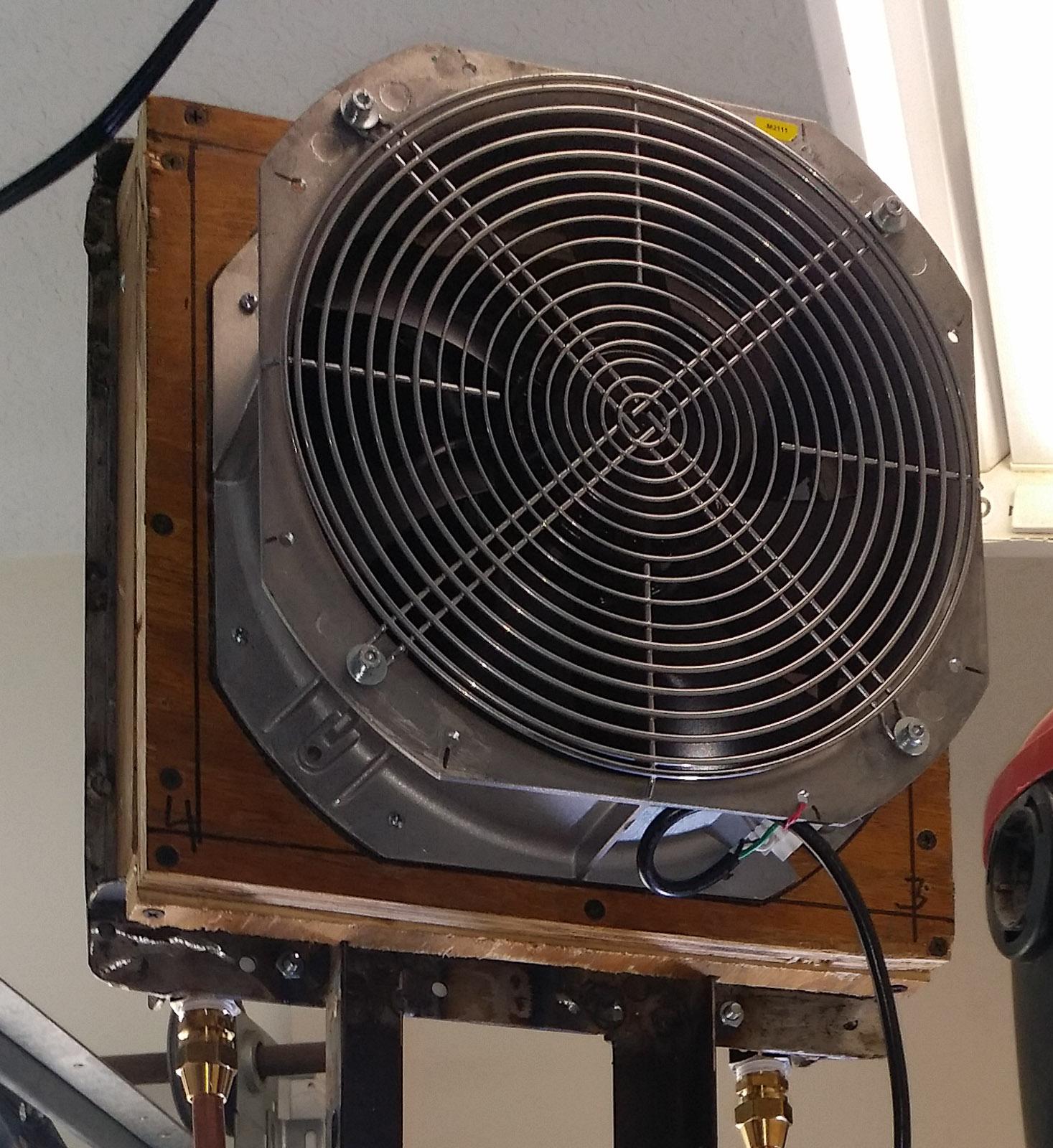

Another thing to consider is moisture removal. The longer the compressor runs, the hotter the air charge will get which will lead to ever increasing amounts of water condensing in the tank and eventually working its way to the tools attached at the end of the line. One thing you can do to minimize air temperature is build or buy an aftercooler to go between the pump and the tank. This will reduce air temperature considerably (from ~290 down to room temperature + ~10*) and will help the compressor run cooler as well. The other cooling option is to run a 50' zig-zag length of pipe after the tank to cool the air before it reaches your tools. Both of these solutions will require a water separator post-cooling to remove the condensed water.
Here is the aftercooler I built using a transmission oil cooler and a 220V/1150CFM fan. I also plan on building a shroud and fan setup for the pump and motor.

The compressor outlet temperature can and will climb to around 300*F; the heads will be slightly cooler. Dissipating as much of that heat as possible will protect the valves, which are the most likely point of failure. The problem is not reaching excessive operating temperature but rather reaching maximum operating temperature for extended periods beyond those the system was designed for. A 70% duty cycle means the system should run for 7min. and rest for 3 min. The problem we face is that most tools will consume enough air to make the compressor fire before the full rest period has been reached. Your compressor should take about 7.5 minutes to fill from empty and about 3:20 to fill from 110 PSI to 135 PSI. Writing this response just gave me the idea that using an Arduino to control run time would solve the duty cycle problems. It could be programmed to cut power after 7 min. and keep it off for 3.5 min. That would force adherence to the duty cycle rating. Look up Hannah's Bug on YouTube. She built an Arduino based system to control several compressors she chained together. Here is the link to the episode: https://www.youtube.com/watch?v=YGYgQO5TFto
In one of the responses to the thread I mentioned above I added links to one project where the owner uses muffin fans to cool the heads. The benefit of having a fan continue to cool the heads and motor after the compressor has stopped working is that the unit will take longer to climb to max temperature when it fires up again.
I don't want to hijack your thread but if you want details on the aftercooler I will provide them. I can supply part numbers and a Sketchup drawing of the bracket I built to hold it.

Now I plan to add a condenser between the pump and tank. Gonna try to find a big automotive one cheap at the local scrap yard.

To bring this back up.
At work we have 4 old air dryers that are not in use. The surface are of the cooling "radiator" is about 24x24" so it is pretty beefy. And I would like to put it between my pump and tank.
The compressor line is about 1/2" copper.
The dryer inlet and outlets are about 1.75" dia copper.
I'm sure I can find whatever pipe reducers I need to plumb it up, but will I have problems going from 1/2 line to a larger line, into the grid, out a larger line and then back to a 1/2" line?
It is scrap so they gave it to me and it has a large fan built into it. I'd like to make it work and save a few bucks.

PostPosted: Mon Jun 18, 2018 1:22 pm    Post subject: Re: Compressor heat questions Reply with quote
I don't know if you came across this info but you have to source hardened tube because the soft stuff has a low temperature rating of about 150 degrees.
