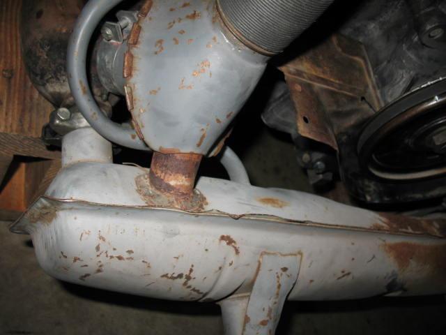

CB Maxi filter pump does not play well with a stock muffler that has the return heater tube for the intake on the left side, well the pump fits, the filter doesn't, found that out the hard way.

PostPosted: Thu Dec 07, 2017 7:52 am    Post subject: Re: Mexican oil pump worth it or leave it alone? Reply with quote
Was it diameter of the filter or it's length? If it was the length of it, could a shorter filter work?

PostPosted: Thu Dec 07, 2017 8:01 am    Post subject: Re: Mexican oil pump worth it or leave it alone? Reply with quote
Length, even tracked down one of Fram's (spit when you say that word) mini filters, they make one that is like 3" long, will not fit.

PostPosted: Thu Dec 07, 2017 9:41 am    Post subject: Re: Mexican oil pump worth it or leave it alone? Reply with quote
Here is a picture of the offending tube that keeps the Maxi Pump from being used. Headers do not cause an issue, just the stock tube is in the way.

PostPosted: Thu Dec 07, 2017 10:48 am    Post subject: Re: Mexican oil pump worth it or leave it alone? Reply with quote
Yea, EMPI made a pump for that
https://www.thesamba.com/vw/classifieds/detail.php?id=1991252
