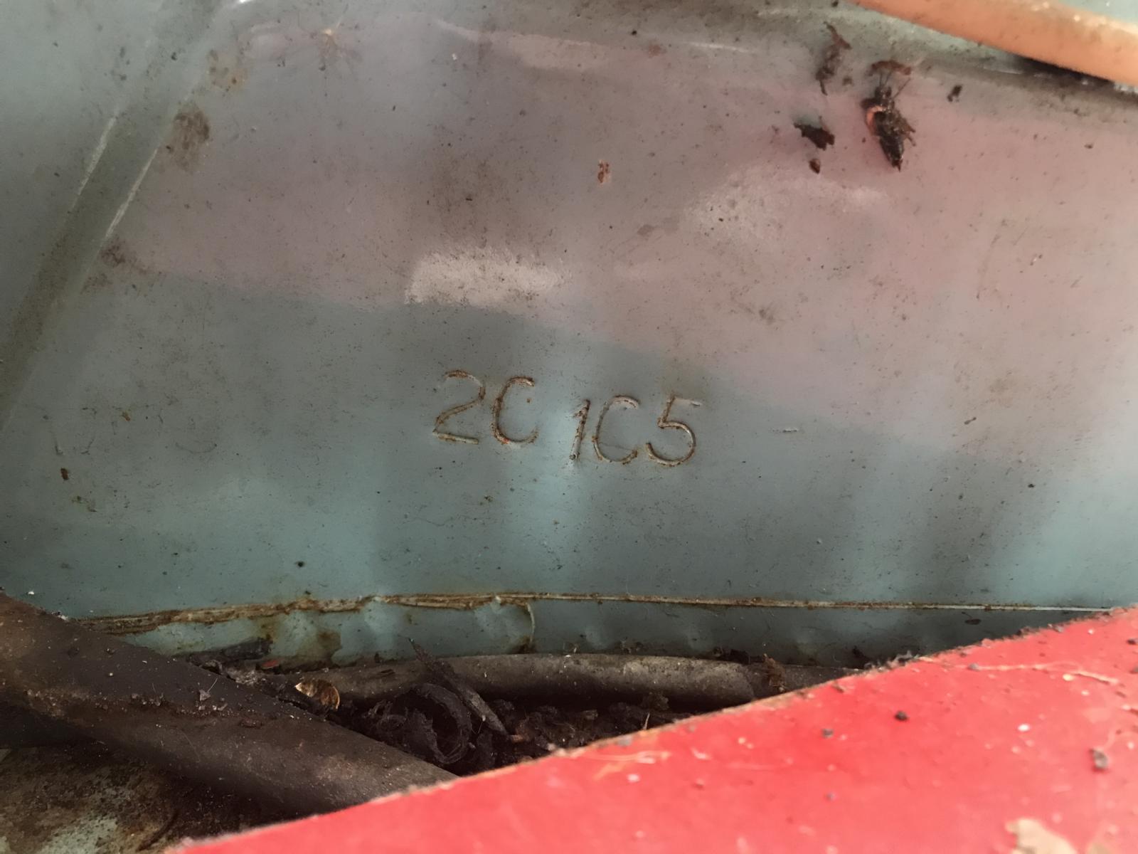

First the 69 Sedan, I am the 3rd owner but the 2nd owner never drove it.
ID plate
Body stamp
2C 1C5
Paint sticker

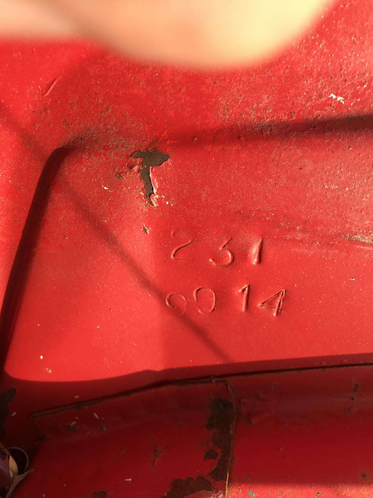

1970 Ghia Convertible.... only God himself only knows how many had this wreck before me! I dragged it out of West Virginia one Winter many moons ago..... Dang! New Years week 2010!
Body stamp
231
9014
Just adding to the knowledge base about our Ghia's origins.
