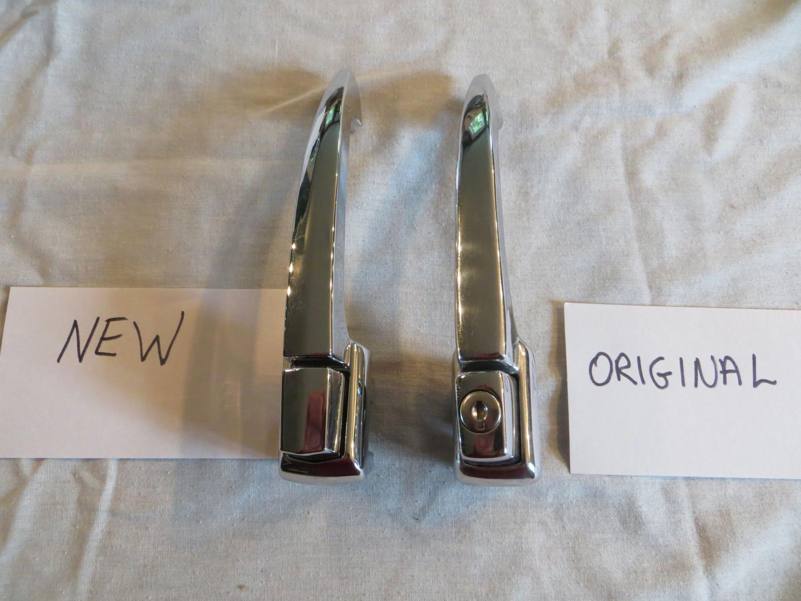

63 beetle
The PO has a lockable handle on the drivers side, and an non-lockable handle on the passenger side of the car.
Although I see this as an option that you can buy from WW, what is the advantage of having only one lock? Defeats the purpose of the one door being locked....yes?

The passenger side still locks. It just doesn't have a key hole to unlock it. You have to use the inside handle to lock/unlock.
My guess would be costs as well.

From the inside push the passenger door handle forward. Should lock the door.

Money saving, yes.
Also makes vehicle security the driver's responsibility, as it's the only door you can lock from the outside, thus making locking keys in car difficult.

Passenger, can also get out, push it forward and close the door, locking it. I have to be honest in that I kinda forgot this until just recently.
If the door handles are in good condition, keep them. WW aftermarket are supposedly decent, but not much is as good as OG when it comes to handles.

I've never owned a `63 Beetle. Do they normally come with a key slot in the passenger side outside door handle? I know that for the 1966 Beetles, US cars did but Euro Beetles had to be locked using the interior door handle.

no key slot like the one on the left

Car is a 61. Wanting to replace with better condition ones. Can I use up to 64 handles with no issue? TIA
Yes you can. Early in 1964 the USA models got revised door handles but before that they were the same back to 1961. ( And 1960 were about the same but the key slot on the driver's side handle was vertical instead of horizontal that year )
