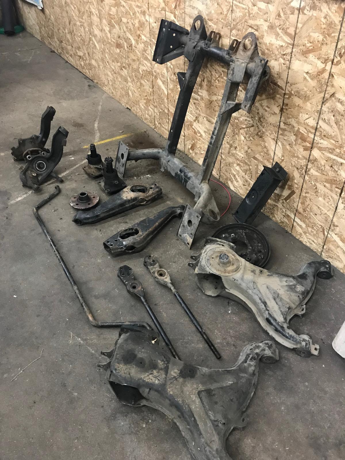

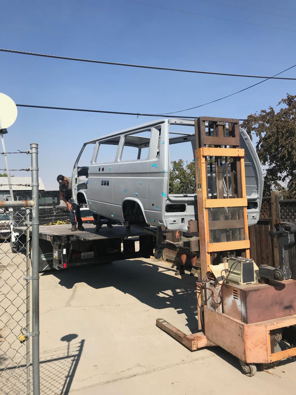

We picked this up as an abandoned project. It was a syncro westy shell with no doors, drivetrain, or anything at all really. The body was rust free but it had its share of dents and dings. The shell was epoxy primed and the undercarriage was brushed with POR-15 before we acquired it. This POR did not adhere and was pulling off in sheets. POR15 bonds to rust and rough metal but I've never been a fan of it. If there's rust, cut it out and weld in new end of story. It has no place on nice clean metal / finish no matter how it's prepped IMHO. Lets not turn this in to a POR15 debate. Some people love it. You still can. We removed all of it with compressed air and razor blades. We then shot the undercarriage with 8 bottles of 3M body schutz (over epoxy primer) after brushing all of the seams with sealer. It's pretty bomber. This will see a lot of winter driving so keeping things corrosion free was my biggest concern.
undercarriage after first coat of Schutz
I had a syncro tin top VR6 stored back in Michigan I acquired years ago that had a usable drivetrain but was beyond repair rust wise. I had it shipped to Santa Cruz and dismantled it a few months ago so we had just about everything to get this project underway. I brought the all of the suspension parts, sub-frame, etc to a Zinc plater over the hill, and then sent it for high gloss clear powder afterwards. The trailing arms and front subframe will be satin black powdered to break up the zinc look a little.

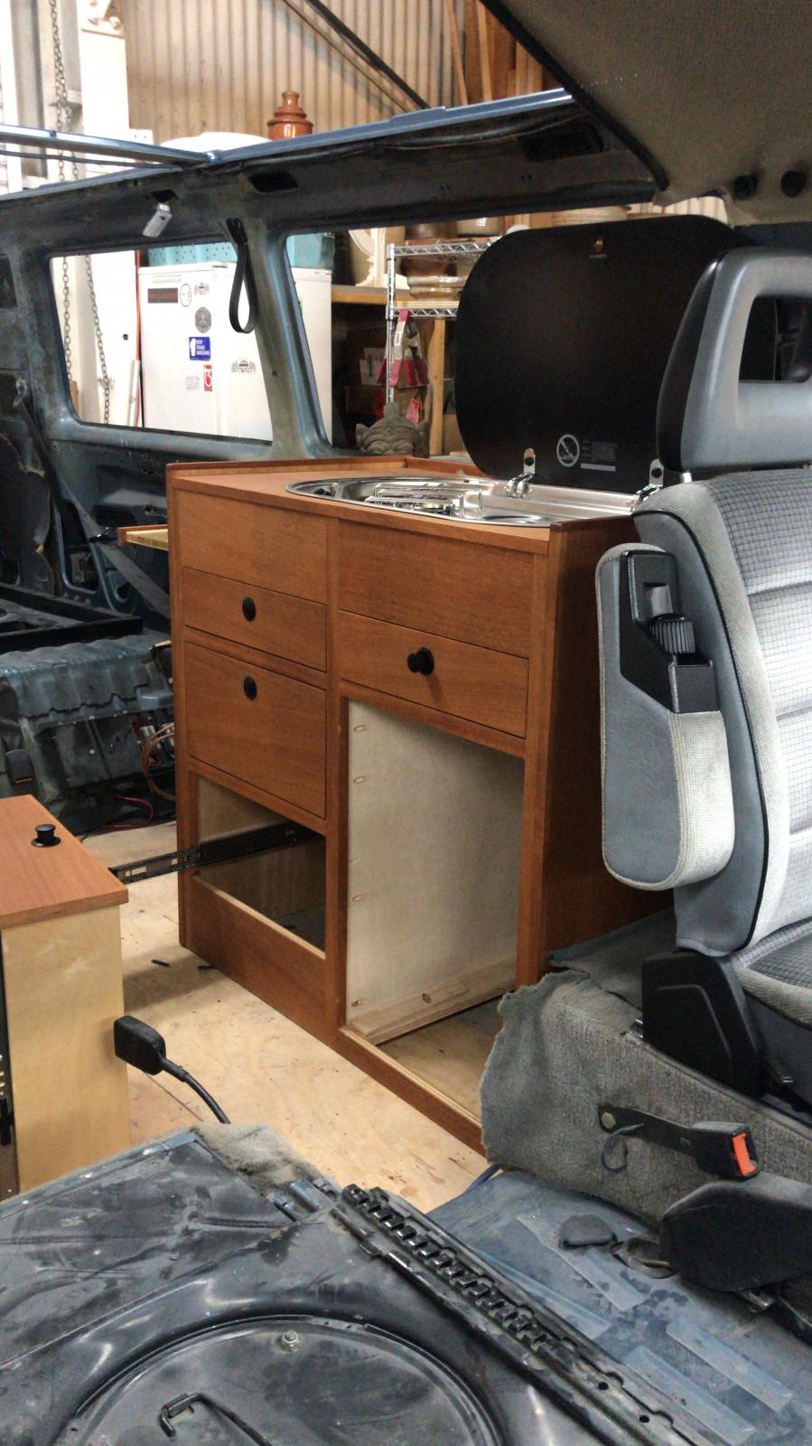

Custom built interior cabinetry.
Mercedes G Wagen factory gray plaid interior upholstery
Recaro LXF armrest captains chairs

The stock westfalia interior really is pretty great as it is. I actually bought a complete gray westy interior for this but after having spent over 700 nights in a westy there were a few things I've always wanted to change to make it a little better / spacious. Here's a prototype we've been working on for another van. The kitchen for this van will be a little more slim than this one.

Just curious, how much did it cost to have those parts zinc plated? I usually have my stuff powder coated but would definitely consider this route if it isn't that much more.

The Zinc won't stay shiny if it isn't cleared over. You're looking at around $1500 to have it zinc'd and clear powdered....but it should last forever.

Coating the stub axles with zinc and clear changes their diameter and I wonder how the bearings and hubs will deal with that size increase?

We wondered that too but it hasn't been an issue. It's only about .0005 If anything it helps on the rear hubs as that bearing fit is not usually very snug anyway.

Dave, I doubt they sprayed clear coat on the inside of the hub. Cool
