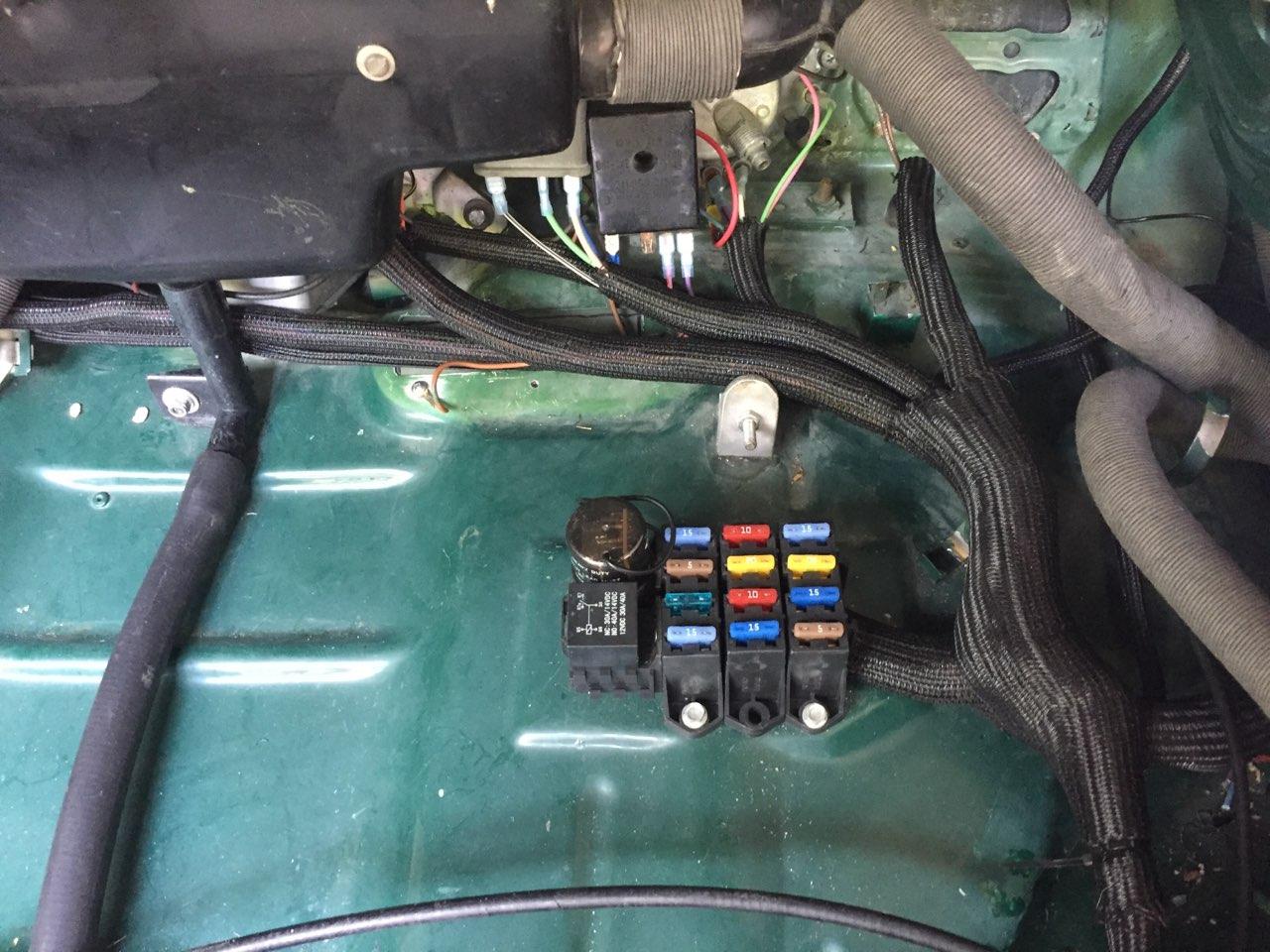

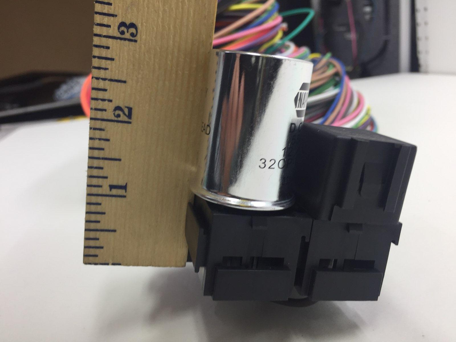

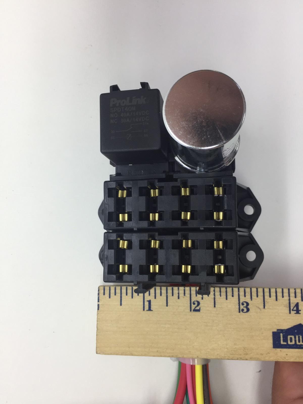

1) There's a horn relay on the panel, wired as a keyed hot (because some of the VW columns ground out the steering shaft when you take out the key). So the relay is powered and hot triggered off the panel, and is just waiting on the ground trigger from the horn button. We have a black horn switch wire in the harness coming off of the relay to go to the column bearing wire, or tube terminal, depending on the column. So when you ground the horn switch wire, it triggers the relay, and sends power out to blow the horn. You could switch it, but not easily, well...depending on your wiring experience. It's already wired for a ground trigger and fed off the panel.

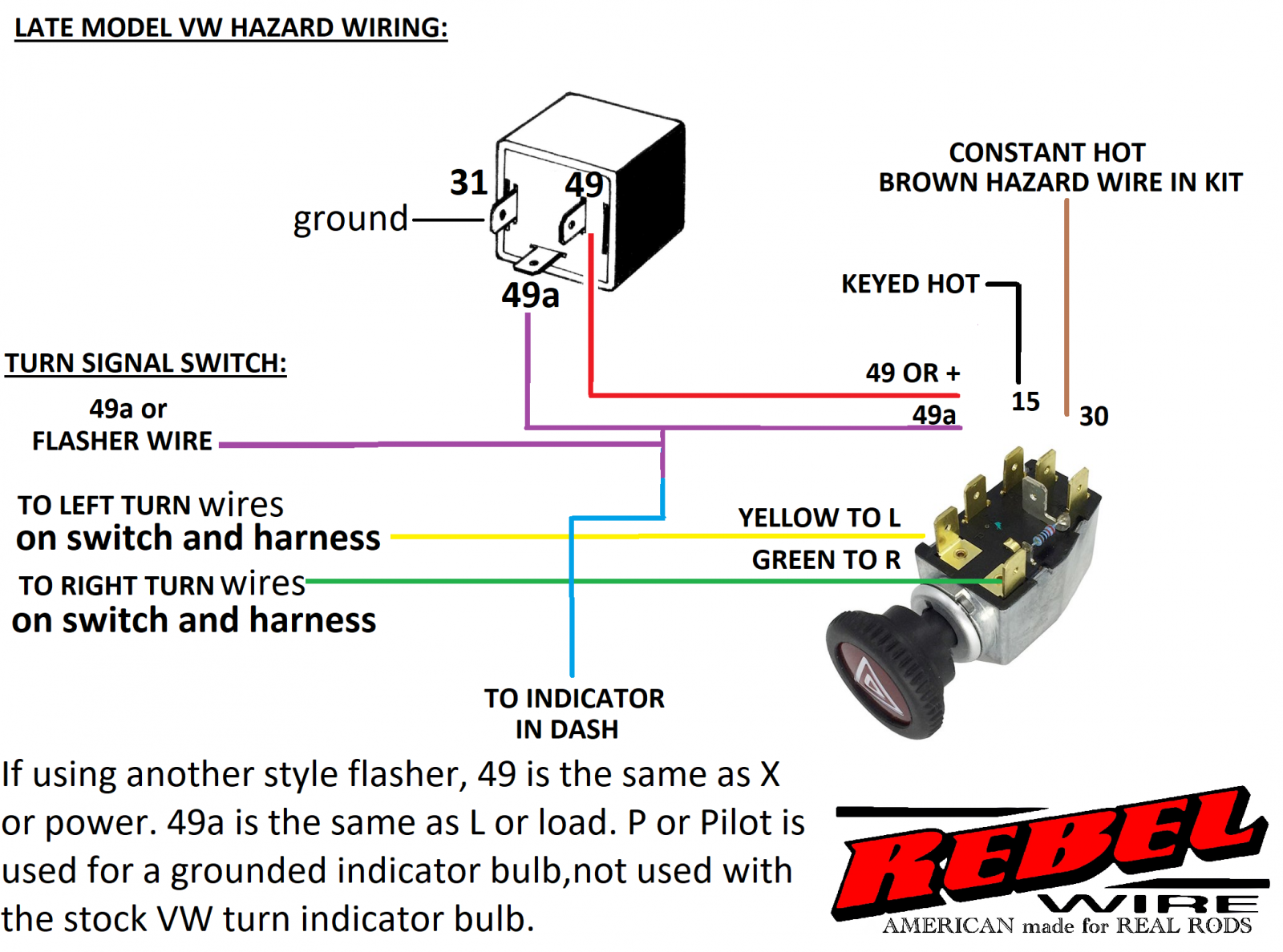

2) The turn signal flasher being used is the old thermal style 3 pin flasher (X power, L load, and P pilot). If you want to use all LED bulbs you can swap it for an EF33RL LED version of the flasher. Due to the different hazard switches and relays used, we only set up the harness for turn signals, and put in a constant hot hazard wire to go to terminal 30 of the hazard switch (later setups) or terminal 30 of the relay (older ground triggered setups). To wire in hazards you can either use your old flasher and make a small harness to tie into the turn signal wiring and switch, or wire in another style flasher just for hazards. There's a lot of different ways to do it, that could probably be it's own write up! Basically when you're done the Left turns are tied together, the Right turns are tied together, and your load wires (49a) are tied together, on most setups. So the flasher has a P pilot terminal if you're using an add on turn signal switch, or a grounded indicator bulb. If you're running the stock single indicator you can just come off of our purple flasher wire (stock black/green/white 49a) and jump it up to the indicator bulb. No diodes needed. I think the American Autowire kits used 2 wires and diodes. I just come off the load wire like the stock setup did. The indicator bulb will flash and alternate with the turn signals like stock. If you ever wanted to run 2 indicators, you could just splice in to the left front and right front turn wires, had guys do that before with custom dash setups. Here's a simple hazard wiring diagram that I made and sent to someone. I use to just edit the flasher part for whatever flasher they had, as long as the power and load terminals are kept straight it still works.

    1) Is there a diagram of the fuse box and which fuse supports which circuit/wire color? Are the wires individually labeled?
    2) How easy/difficult is it to add a new circuit? Are there any spare fuses or spare spots for additional fuses/connections? Think radio and/or fog lamps.

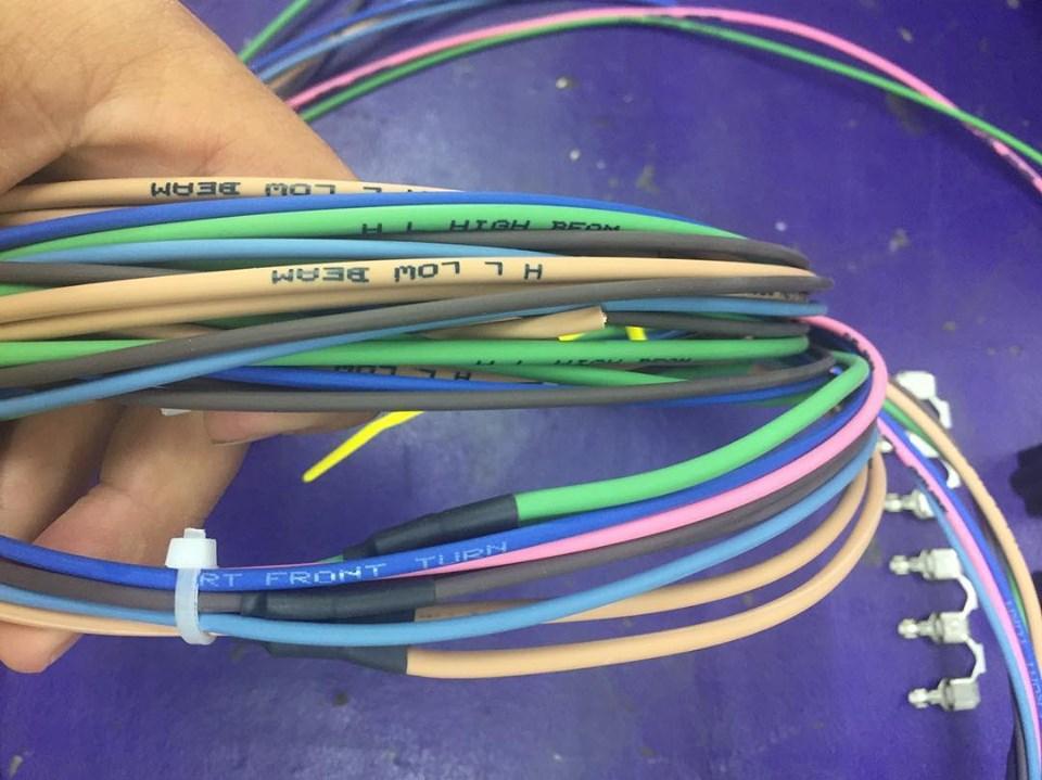

1) There's a sticky backed decal that shows which fuse is for which circuit.
The wires are labeled, printed every six inches the full length of the wire. Also the wires are already sorted into switch bundles, front and rear sections.
This is the front section showing the labeling:
So if you were wiring the headlight switch you'd have a bundle of wires that would be labeled: headlight switch power, park lights, dash lights, tail lights, dimmer power... and you'd wire whatever switch you have according to it's function. Normally headlight switch power to 30, park and tail lights to 57 or 58, dash lights to 58b, dimmer power to 56.

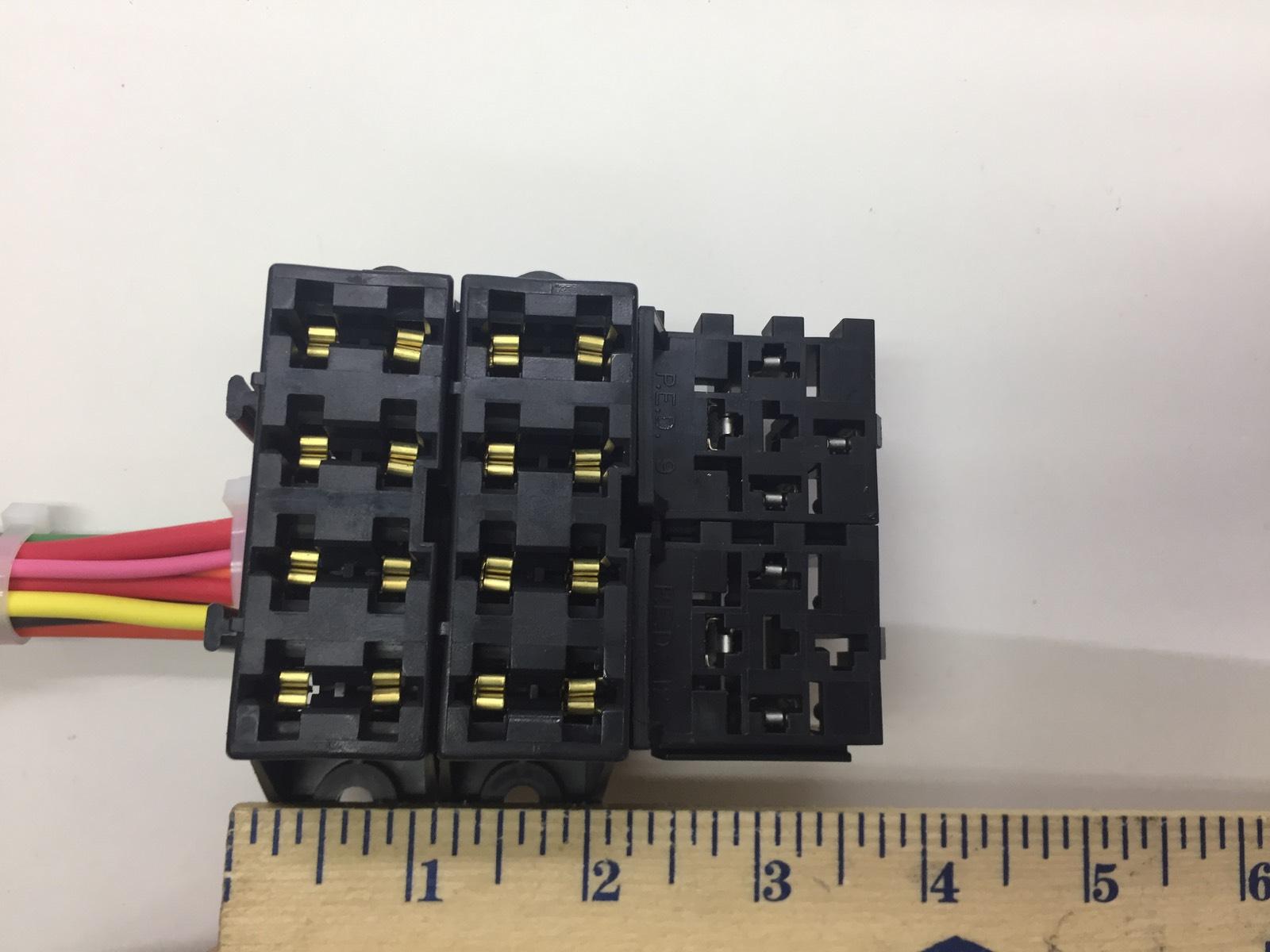

2) In the basic kit there are already wires for radio (keyed and constant hots), Lights, signals, gauges, brake lights, horn, wiper power, and an Ac/heat power wire, like for a fresh air fan, or that gives you an extra 14ga keyed hot. In the deluxe version of the kit there are all of the above circuits, plus trunk/dome lights (constant hots) and 2 extra 14ga keyed hot accessory wires for later. Of course it basically comes down to they are mostly keyed and constant hots, and could be used for other things besides what they're labeled for. You could add in relays for higher loads and use a hot wire off the panel to trigger a relay. Just depends on what you were doing.

Here's another picture of the Deluxe VW kit, with extra accessory wires. The extras are bundled into the front and rear sections.
So you'd just mount the fuse panel, route your wires to the front and rear, then pick a place to start (front, rear, dash). If you were wiring the ignition switch: you'll have the bundle of wires in the harness labeled (Ignition Switch Power, Ignition Switch Ignition, Ignition Switch Accessory, Coil, and Start). If you were wiring a stock switch with 3 wires, you'd connect the ignition switch power wire to the stock red wire on terminal 30 (that's power into the switch), the purple start wire to the red/black on terminal 50 (50 is hot in crank position), and you'd need to connect all 3, orange ignition, brown accessory, and pink coil to the stock black wire on terminal 15. Terminal 15 is your keyed hot coming off of the switch. It's hot in run and start positions. So your feeding the keyed fuses on the panel, and the coil +. If you're adding a lot of accessories and are worried about the draw on your ignition switch, you could change out the switch, or relay it, letting the relay carry the load of the accessories, and just using the stock black wire on the switch to trigger the relay. In most cases, you're still operating the same amount of accessories, we're just using heavier gauge wires than stock and dividing up the circuits more. Either way, stock switch or aftermarket, you just connect the wires to the switch going by their labels, and the operation of your switch.

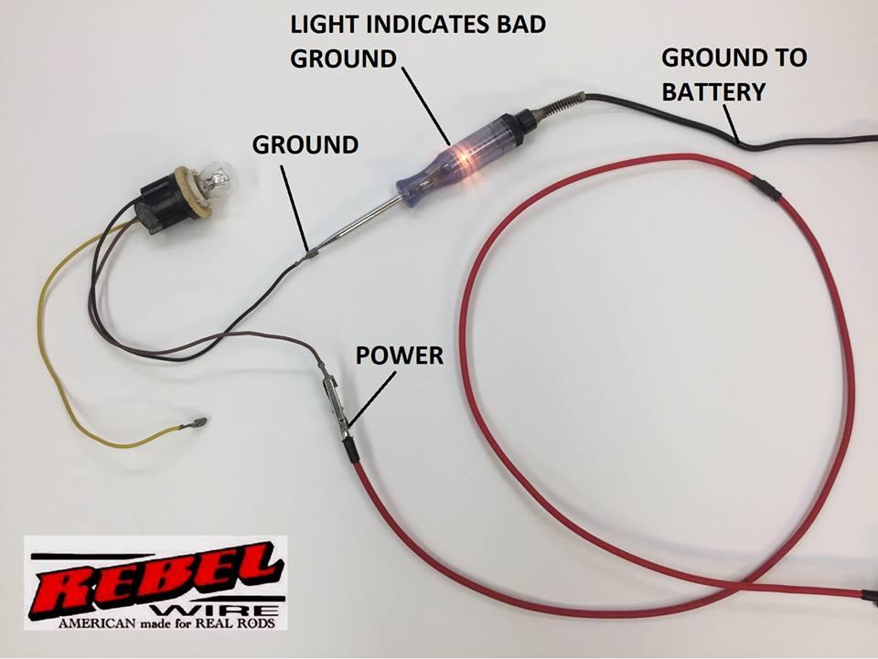

Grounds! I know this is at a random point, but I end up doing a lot of tech on bad grounds. Most guys will look at the ground wire they've made or where a socket is mounted in the body and go,"I know the ground is good, that's not the problem". Well, how do you really know? You could use a meter and check for continuity to the battery ground, or my handy Power Probe tells me I've got a good ground, but you can also use a simple test light. I have people do this a lot and figured I'd post it here.
So if you have something going on that just doesn't make sense: like you blow the horn and an indicator bulb lights up, or you pull on your lights, and one side is brighter than the other (provided your powering the same filament of the bulb), you turn on the hazards and 3 out of the 4 bulbs blink... you can check that ground more than just visually. A simple test light will work. If you turn on the suspect circuit, power up the bulb that's not working,whatever it is. Take your test light and ground it to the battery ground (because that's the best ground you've got) and take the probe end of the test light and probe the suspect ground wire, bulb housing, spot on body, engine block, whatever it is.. and if the ground is bad, or not as good as the battery ground, the test light will light up. The reason is that the power will flow through your test light trying to get to the good battery ground you're connected to. You may need a long piece of wire to get your test light grounded to the battery, that's fine. Then you can move the test light around probing for bad grounds (with circuits powered up)

PostPosted: Thu Jul 11, 2019 11:27 am    Post subject: Re: Rebel Wire Questions and Pictures Reply with quote

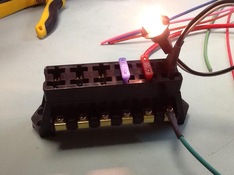

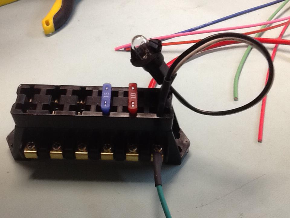

Finding a short without going through a handful of fuses: So this is another trick I'll use. It again uses a light bulb as a visual aid to find a short to ground. If you keep blowing fuses and you don't know what the problem is, or if you have a parasitic draw that's draining your battery (maybe for another time) you can take out the fuse that keeps blowing, and replace it with a simple 2 wire bulb. Doesn't need to be fancy
So you take out the blown fuse, and replace it with the 2 wire bulb. Turn your power back on, since there's power on one side of the bulb, and the other is shorted to ground, the bulb will light up.
You know which fuse is blowing so you know the general areas to look. Say it blows when you pull on the headlight switch. Ok, does it blow when you pull it out for running lights, or only when you pull it out all the way for headlights? Whatever it is, go to that area and start checking them. Pull bulbs out of sockets, unplug wires if you can one at a time... whenever you find the problem, and disconnect it, the bulb will go out telling you that you've disconnected the short to ground.
Finding shorts in lighting can be tricky. A bulb plugged into a socket, even though it's fine, will light up your test bulb, because it does have a path to ground through the bulb filaments. So if you remove the bulb from the socket first, you can tell if it's in the socket itself or the wiring. It still takes some trail and error to learn it, but this can be a useful trick.

Testing your turn signal switch and wiring:
First thing, if you think you'll be testing for a while and have the coil wired already, unhook the coil while you have your key on. You don't want the coil hot for extended periods of time without the engine running.
Here's an easy trick I use a lot. Let's say you wire everything up on your car and you use the turn signal switch and nothing happens. Where do you start? On the Rebel Wire kit, I would check the fuse, sometimes you may have had a short or your flasher wire touched metal and blown the fuse. If the fuse is good, where do you go next? You can put a test light on your flasher wire, but the flasher needs to have a load drawn on it to pull power through, and your test light may only give you a faint glow, making you think it's a voltage issue, bad ground, etc. Where you actually want to start checking for power would be at the X (power) side of the flasher. Unplug the flasher, underneath it's stamped X,L, and P. The X terminal is the power into the flasher, L is the load side out to the turn signal switch, and P is the pilot terminal for a grounded style indicator bulb. We just need X and L for now. So you unplug the flasher and check for power at the X terminal.
If you don't have 12v there, most likely you blew a fuse and it just didn't look blown, or it carried enough continuity to show good, but won't carry a load.
If you have 12v on the X terminal (49 on stock flashers) you can put in a short jumper wire and jump from X to L, L is (49A on stock flashers). With that jumper wire in place you're sending the 12v to your turn signal switch so you can move on and test the switch. Here's a picture of the Rebel Wire panel with the flasher out and jumper wire in it's place:
So now you're sending a keyed 12v into the turn signal switch. The Rebel Wire purple "turn signal flasher" wire should be connected to the stock black/green/white wire on your stock turn signal switch. That's how power is getting into your switch.
So with the switch turned off, your black/white (left turn) and black/green (right turn) wires should be dead. If you turn the switch to the right, the black/green wire should show battery voltage. If you turn the switch to the left, the black/white wire should show battery voltage. These right and left turn wires stock would run out to your bulbs front and rear. In the Rebel Kit, they are shortened and connected to the yellow and blue left turn wires, and dark blue and green right turn wires. Then they still run straight out to your front and rear bulbs.
So if you operate the switch and have power coming back out, and the connections are good into the new Rebel wires, then you can move on and test for power at your sockets. If you have power out at your sockets and the grounds are good, your bulbs should light up solid, not flash, because we've unplugged the flasher. If you get solid power out at the bulbs, you should be able to remove the jumper wire and plug the flasher back in and everything should blink like normal. Remember if you changed out to LED's you'll need an LED flasher, not just an electronic, but an LED flasher like an EF33RL with a ground pigtail on the flasher.

I just made a short video of how to bench test your bulb sockets and how to tell between the turn signal and park/running light wire on 1157 bulb sockets. Thought I'd post a link here. There's pictures earlier in the thread using a 9v battery, this is using my Power Probe. The dim filament would be the running light, and the bright filament is your turn signal wire. On 1156 single filament bulbs, they can do one or the other, or backup...brake light...just one function, not both. One of these sockets is self grounding, the other has a 3rd wire for a ground. I'm not trying to direct anyone to our Facebook page, I'm just better with old car tech than posting Confused
https://www.facebook.com/rebel.wire/videos/2405362456153260/

I had a customer building a Manx buggy and needed some dimensions on the fuse panel. Thought I'd post them here if anyone needed them. This is the Bug universal panel, the rail buggy kit would be one row of fuses and 1 inch shorter, the Deluxe Bug panel would add another row of fuses and 1 inch longer.
