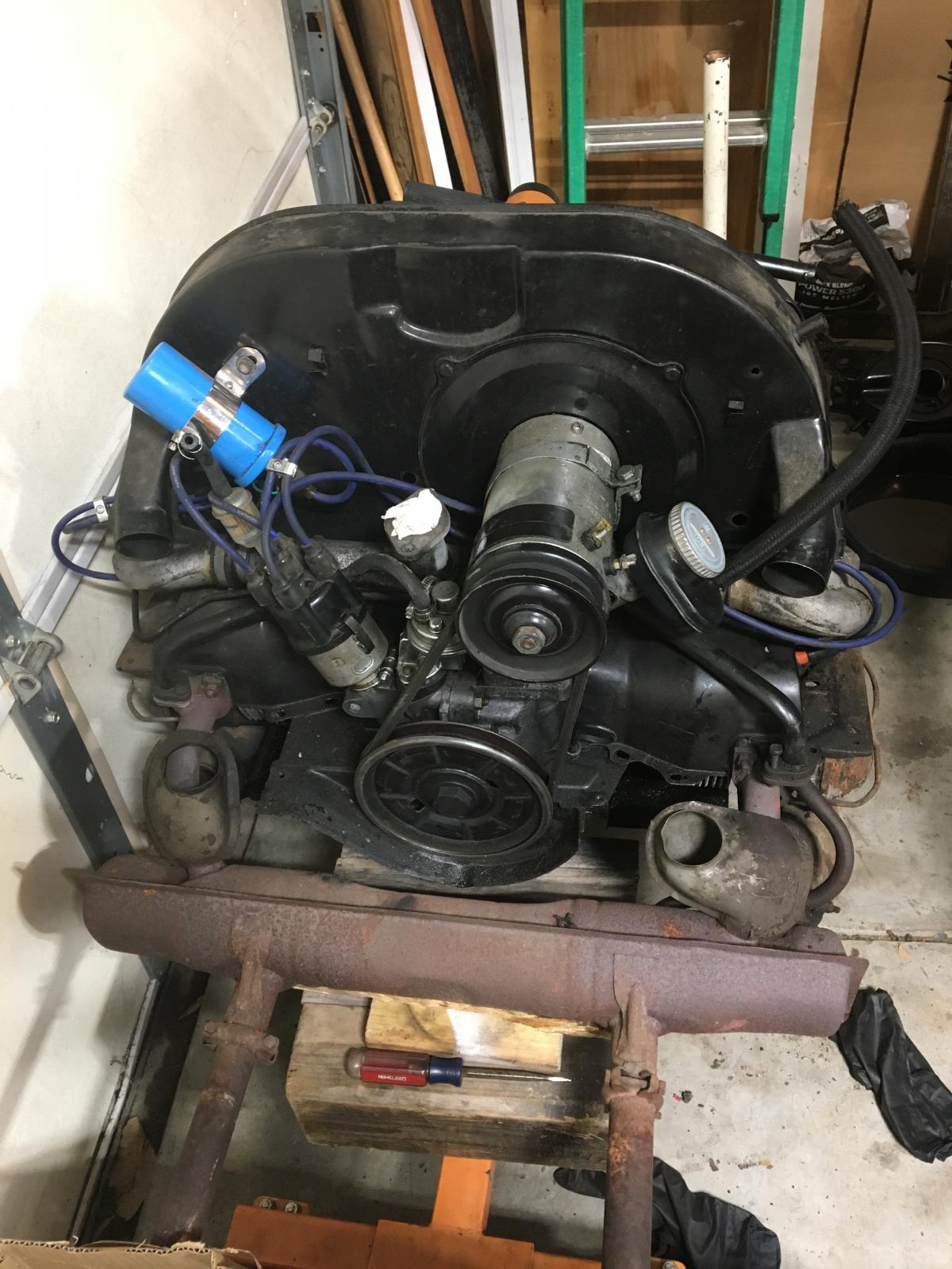

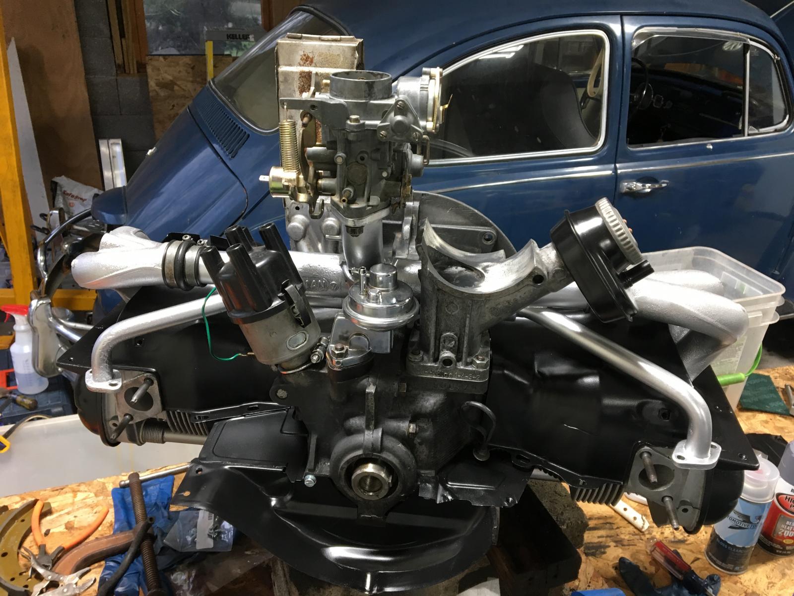

Hello Guys! After looking on Craigslist for about 1 year, researching about VW restorations, and VW's in general, I finally got my first VW Beetle. It's a 1967. After looking on Craigslist for a while, I finally found one that is close to me for a reasonable price. I picked it up for $2000 last November from a guy who lives about 15 minutes away from me.

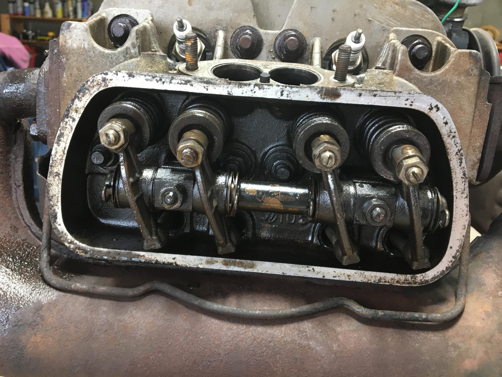

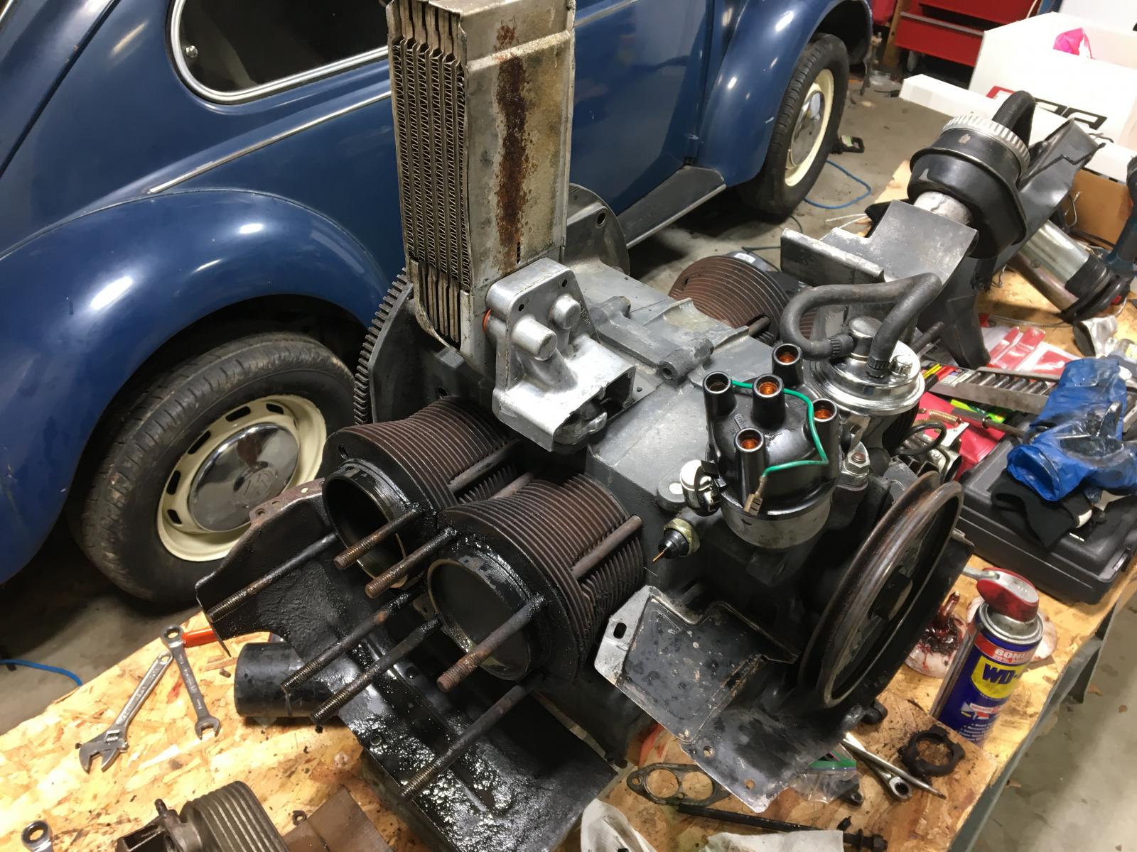

Fast forward to now, I took the engine out, re-honed the cylinders, installed new rings, and cleaned all of the grease off.
I also rebuilt the solex 34 pic-t 3 carb and had the heads rebuilt

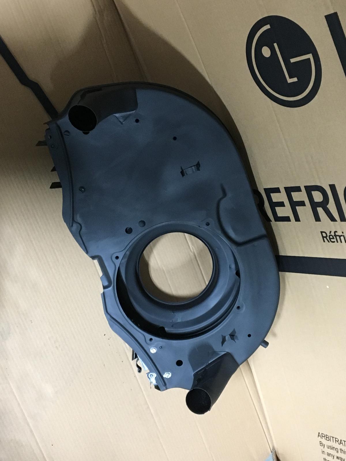

I am now also in the process of repainting all of the engine tins
I'll post more pictures once I'm done assembling the repainted engine

Your tin work looks nice and clean.
Get a distributor that matches your carb. The dual port 1600(assumed) will run sooooo much better.
I installed a Bosch 034 German distributor on a friends 66 with the same carb a year ago. He loves how the engine runs.
This was after he insisted his engine ran great with the Oh Oh 9.
I carry a Oh Oh 9 as a backup. For those just in case roadside moments.
Good Luck.

I finished repainting the engine a while ago, but this is what it ended up looking like. Now it’s time to remove the body and repair all of the rust.

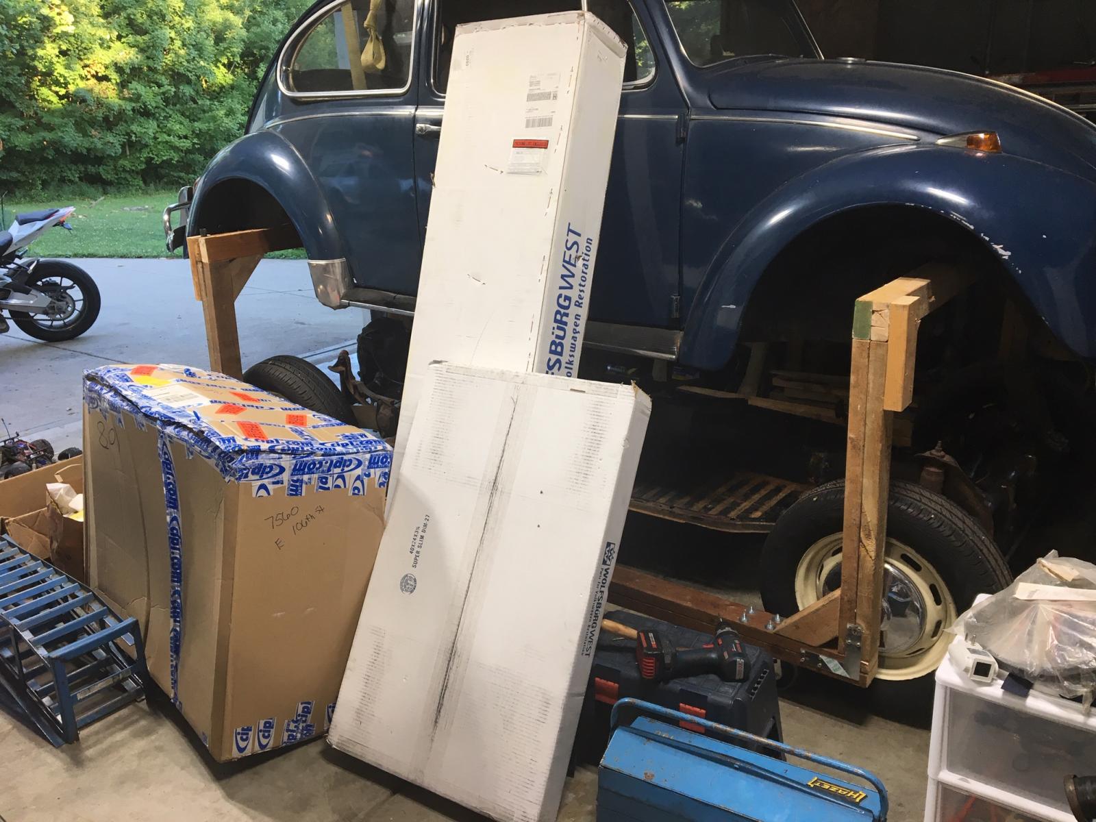

I’d save the body work for the winter months, but I’m in school during that time and I’ll be studying a lot.
Over the past week it has been pretty rainy, so I wasn’t able to get too much done. Sad
I was able to build the dolly for the bug during the rainy days. This picture doesn’t show the finished product, but it’s the best I have.
Yesterday, I removed the body from the chassis with help from my brothers and hydraulics.
I’ll get a parts order going, so that I can get to the body work as soon as possible!

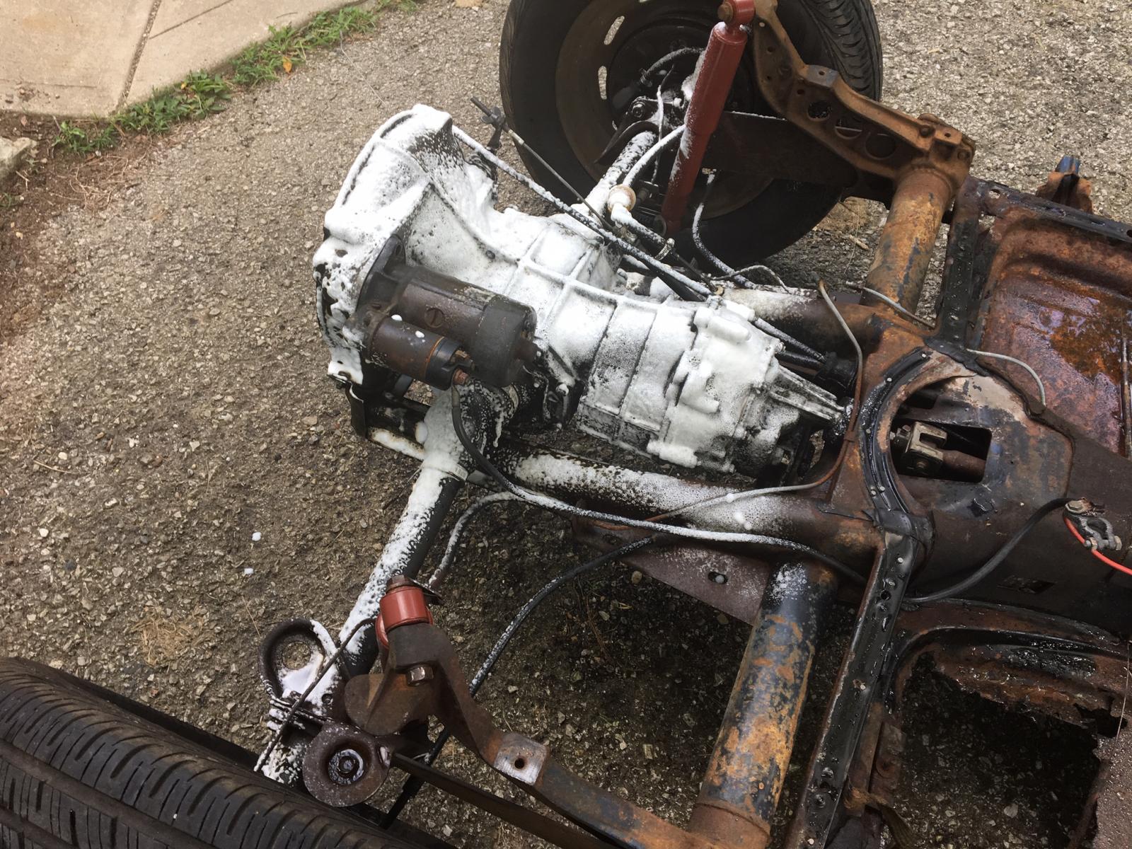

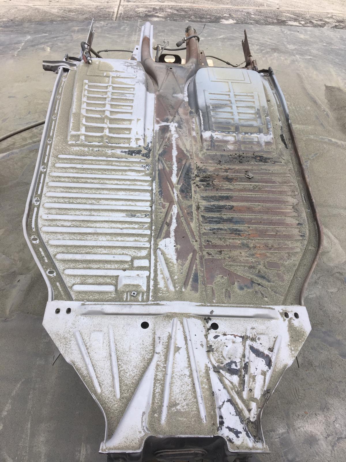

Once the chassis was removed from the body, I power washed it and cleaned the really greasy parts with oven cleaner.
My family and I flew to Germany to visit family for 3 weeks. The landscape is really pretty over there. Plus, we saw a bunch of cool old German stuff that my relatives own.
We visited relatives in Berlin. Saw some pretty cool stuff at Checkpoint Charlie.
After visiting relatives, we went to climb a couple mountains. These are pictures of Herzogstand and Heimgarten.
...it's supposed to say Weissbier, but the guy we ordered it from messed the shirt up haha
The last week being there, we visited family friends who own a carpenter shop and he had these cool old motorcycles that he restored. I believe that the green one is a 1935 motorcycle.

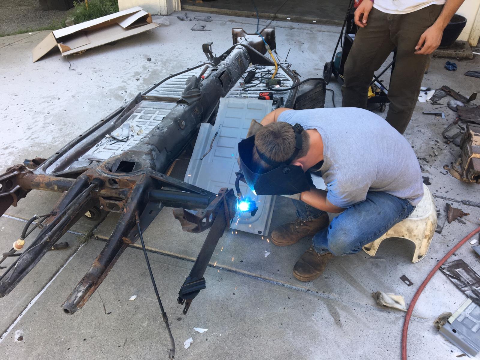

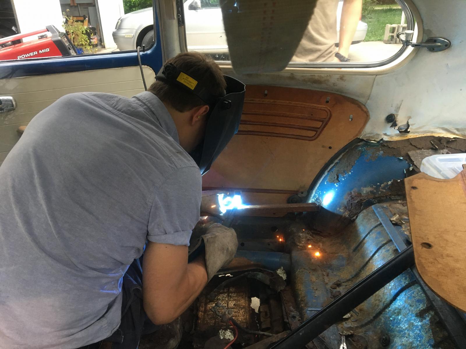

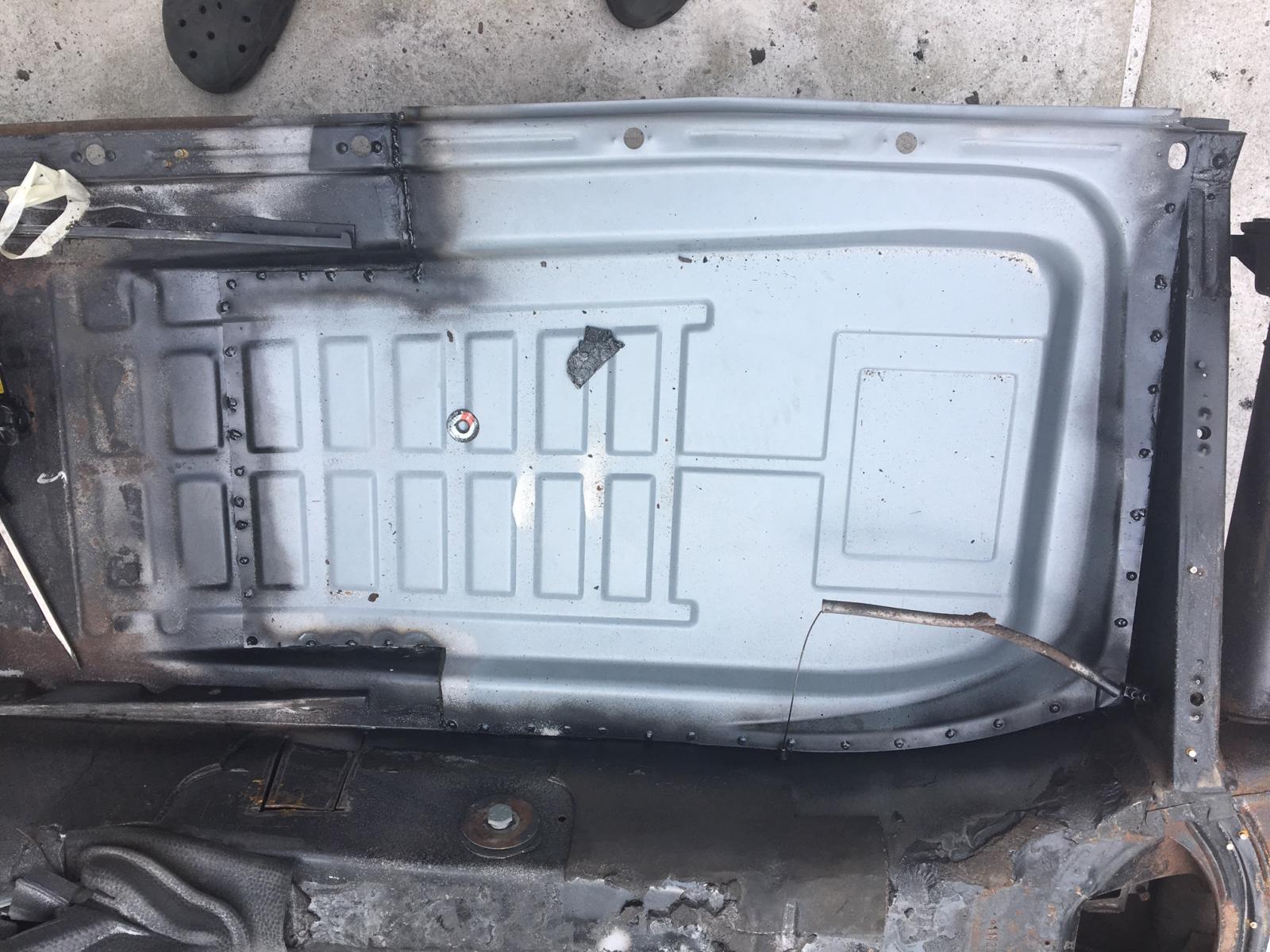

When I got back to the US, my parts arrived and I could finally dig in. Sadly, I only had 3 weeks left of the summer.
These were terrible welds, so I cleaned them up. This picture was before I did that.
I got quite a bit more done, I just need to take pictures of it. The chassis is now fully painted, and I've removed one heater channel. Additionally, I removed the rear quarter panel of that side, and I sand blasted/painted that side. The next load of pictures will show that...when I get around to taking them.
