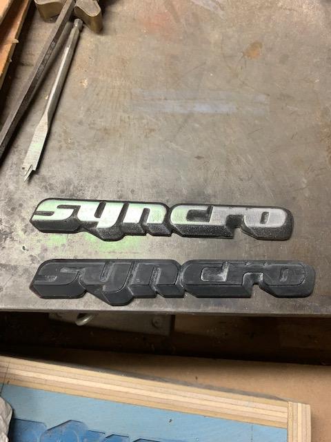

Some teaser pics for original large Syncro rear deck emblem in-work. These larger ones are no longer available. These will be cast in aluminum instead of plastic, with high polished lettering and darkened shadow area as original. I hope I'm not going against forum policy showing off these emblems. I just want to share something new Cool - not mine BTW.

My original emblem was flat with 2-sided tape. This sand casting it made the same way. I may drill 2 shallow holes that will accept screws, or just use tape like the factory did...
Here is a pic of the back

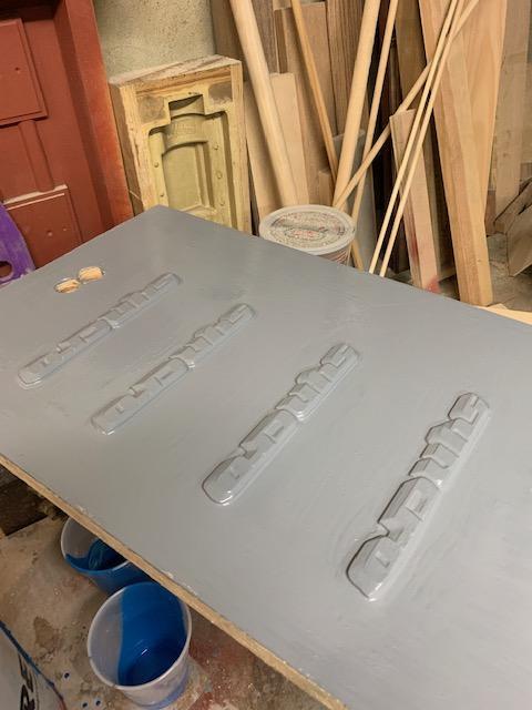

Here's some detail of the front. You can see that it's a sand cast, not a die-cast. Greg is the expert and can explain the different casting methods. I actually prefer how this looks vs the plastic OEM one. I'm going to darken the background a little & buff up the front.

Looks good tjet! I think that background needs to be darker for sure . As you said these were cast in resin bonded sand , and I agree they look better than the plastic one for sure , plus it won’t turn totally black like the plastic ones do when the aluminum colored paint wears off of them! As for pins , if people need pins I can pin them. Flat with the double sided tape seems to be the easiest though.

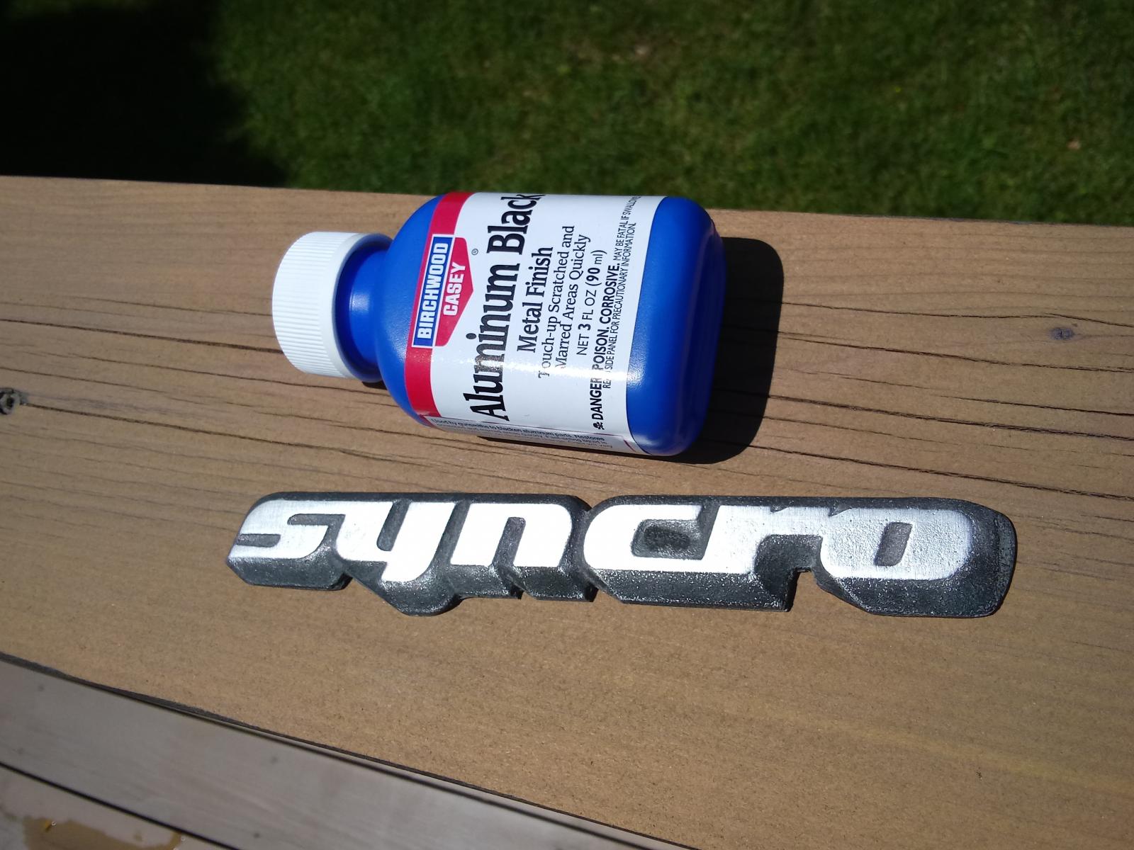

I experimented with some acid to darken the 3-D area. It's a mild acid designed to darken aluminum. You can see some difference in the dark area of the "c". You apply it with a swap, then rinse with cool water for a min or so. Since it etches the metal, you do not want to get this on the polished areas. It may leave a permanent stain.
I need to do another application
