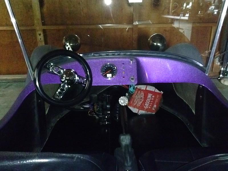

After getting everything done back there my next step will be to cut out the top of the tunnel and do a little work inside. I have a nice early '60's pedal assembly with the clutch pedal still attached. I need to cut back and clutch tube in the tunnel and brace it. That was not needed before so the clutch cable still ends at the forward pedal mount location.
I also plan to move the shifter back 4 or 5 inches to just in front of the ebrake. Of course, I should be out there working instead of in here posting. Laughing

i have the same body and when i built mine i cut the tunnel just behind nepolians hat and moved everything back about 6 inch then what i cut out from behind the shifter i put 6 inch back in front of the peddles and only had to extend my brake peddle rod

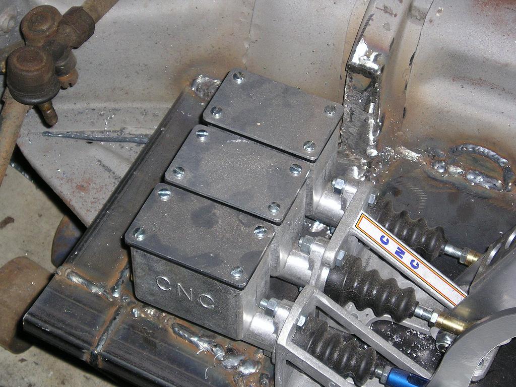

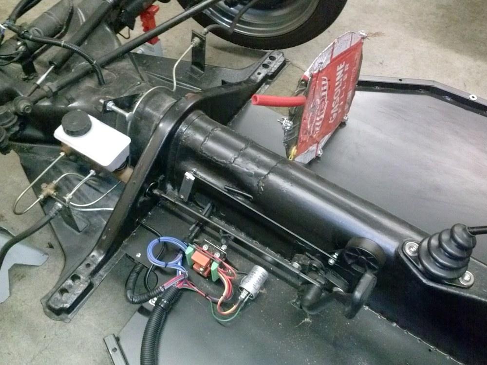

In a Mini-T, since the pedals are well back from the front bulkhead where the floor is also wider, there would be plenty of room to use a pair of sand rail type hydraulic pedals, one for a clutch and a separate one for a brake.
EVfun Premium Member
Joined: April 01, 2012
Posts: 6067
Location: Seattle
EVfun is offline
PostPosted: Fri Mar 30, 2018 1:26 pm    Post subject: Re: Berry Mini-T build v2.0 Reply with quote
I always wondered why the instructions weren't written that way. The designed way involved a whole lot of cutting on the top half of the tunnel.
I have seriously considered adding a separate hydraulic clutch pedal, you can buy single pedals and it would be easy to mod the top to take a stock pedal cover for good looks. I see 2 reasons against it:
I don't think the sheet metal floor is really up to to stress without excess flex (stock or my 16 gauge floor.) If the floor is wiggling under the load the clutch will most likely have a terrible feel (kinda defeats the main reason in favor of a hydraulic clutch.) It means stress on the hard line leaving the clutch cylinder. I'm not sure sure what beefing up would be needed and I didn't really want to flip the chassis over to weld.
I have to move the shifter back anyway, so the tunnel will need to be cut. See how close the shifter base is to the new pedal location. If you look at my pictures you will see the pedal shaft was cut and laid back about 45 degrees, under the boot right near the top of it. I bet in all the pictures posted so far the transaxle is in 1st gear. In 1st and 3rd gear the shifter was actually partly under the dash. I had to be careful going into 3rd, making sure not to catch the bottom of the ignition switch. There are about 5 inches between the shifter and the e-brake handle (using a later short handle on an older Bug frame.) I plan to move the shifter back around 4 inches.

I don't believe Neal started making hydraulic clutch slave cylinders until after 1970 or so. I got one in 1974. The stand alone cast pedal mount sets came after that
Beefing up the floor under the pedals should be a straight forward job. Here is some good info by Joe Sellars about clutch masters.
jsturtlebuggy wrote:
5/8in master cylinder is what is commonly used in Neal/CNC setups.
Makes for a easier to push pedal.
Going to a bigger 3/4in will make the pedal harder to push, but it will have more travel. Meaning the slave will travel further.
Another thing is the length of the pedal will make a differences. Short pedal, less leverage. Wil-Wood makes different length pedals.
When I move a shifter back in a Manx, I need to shorten the front of the shift rod not the back or I cut off the bent section which clears the underside of the parking brake. I have no idea about the Mini-T
Some people will just make them fit with a little brute force.

That could have been done a little prettier. Smile
Looking at it I think a 3/4 inch square tube from the tunnel to the outside of the floor (those are 3/4 inch square tubes) and one from that tube forward to the napoleons hat could provide the structure. I'd weld a 1/8 inch flat plate to them and bolt a single pedal through the plate, the floor, and have a second plate under the floor to tie things together. I'd have to hack the shifter more, adding around 6 inches to the length in the middle.
I'm convinced to take a second look at this... With a quick search I couldn't find the pictures or construction thread I'm looking for. How do I set up the slave system at the rear? I have an older transaxle with the built in bowden tube mount as part of the side cover and the curved clutch cable arm. If someone can point me to the right thread, some good pictures, or a parts needed list that would be great. I will look around theSamba a little more too.

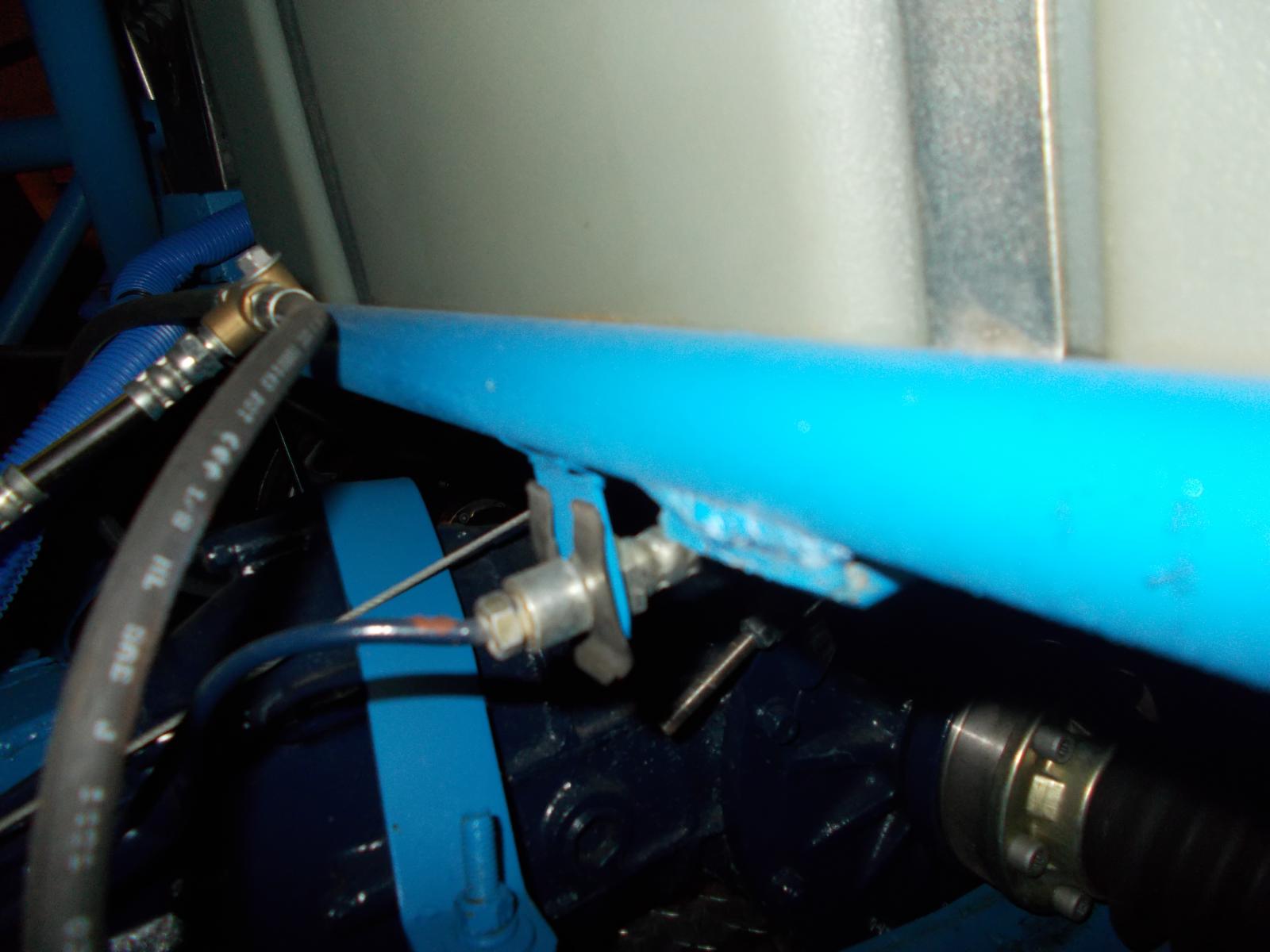

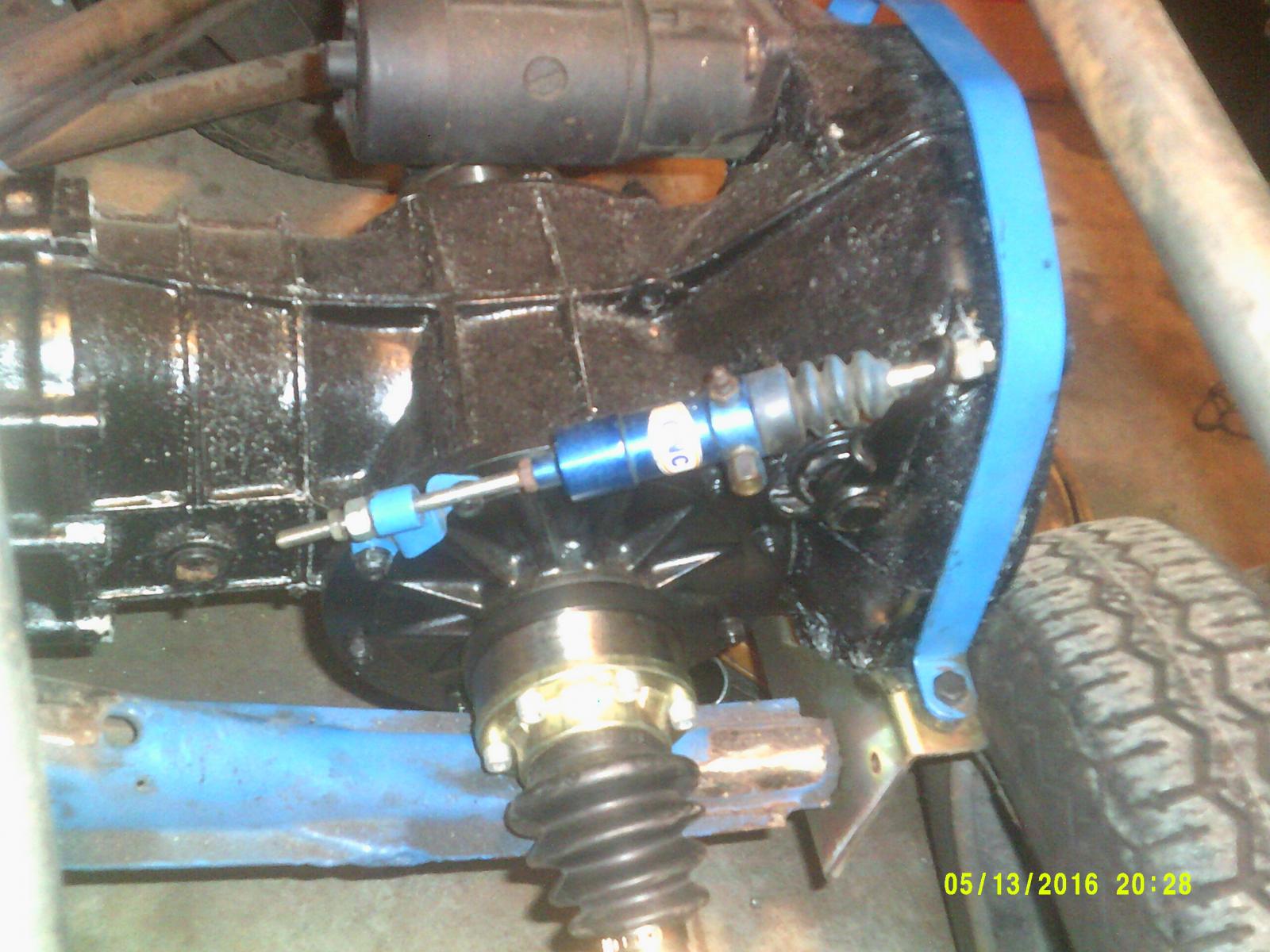

It should bolt right in in place between the Bowden tube bracket and the throw out arm.
They have nylon hydraulic line but FLAPS metal brake line to a braided stainless line is better.
Here's a thread https://www.thesamba.com/vw/forum/viewtopic.php?t=654635
There are forward mounts which allow the slave cylinder to deflect and move up/down as the throw out lever arm moves through its arc, reducing side load/wear on the slave cylinder
http://www.mooreparts.com/clutch-slave-accessories/
Good thread find, I missed that one.

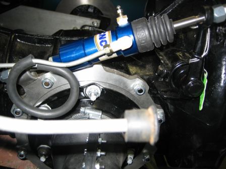

I did fine a very relevant picture from Paul Deatherage. I always thought the angle changes would require some heim joint solution, but it seems that isn't the case. This one picture in particular looks just like my side cover and clutch arm.
It looks like I could locate a heim joint above and just behind the existing bowden tube mount by making a mount from a block of aluminum, but clearly it isn't required.

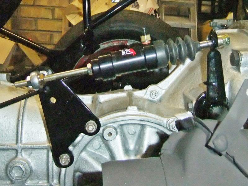

I did find this picture from Wythac too, also with a CNC slave and a side cover with built in bowden tube mount.
This leaves me one other big question. What about line adapters? Most of this stuff comes in inch sizes and I think would be easier (just one adapter at each end) to run another VW metric brake line and use a short brake hose as the flexible union between the slave and a mounting bracket under the gas tank.

You can get metric 10x1.00mm to 1/8NPT fittings.
CNC masters and slave cylinder can be bought with them installed.
You really want to install a flex line at the clutch slave cylinder as it does move some when being used.
My thought is that if I go this route I will use an IRS Bug rear flex hose from the clutch slave to a tab on the bottom of the gas tank mounting frame. The flex hose would attach to that tab just like the brake line flex hoses clip to the frame.

Good image cbeck. It looks about like what I have in mind about using a VW flex hose to go from the clutch slave up to the bottom of the gas tank frame. The more I think about this and see the input from other buggy enthusiasts the more I become convinced that I will go with a hydraulic clutch. I'll have to extend the shifter, but that is easier than all the frame open changes needed to get my nice used (looks near new) pedal cluster I found into the car. I can add about 6 inches between the 2 factory bends in the stock '64 shifter

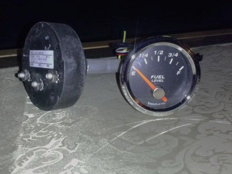

Also, I got a my Speedhut gas gauge and capacitive sender Saturday. Here is a shot of my new fuel gauge and the matching speedometer in the dash. I want to thank Speedhut for their great customer service that allowed them to tell me the options required to make my new gauge match my older purchase from them.
I would say one of the "Saver" pivot mounts is not absolutely essential/required, however the action is smoother and the wear caused by side load on the slave cylinder is reduced.

I ordered parts for a hydraulic clutch last night. I have a CNC clutch slave cylinder, a single pedal bracket, a Wilwood Girling 5/8 inch bore master cylinder, and adapters to 10mm bubble flare lines for each end. I'll be making another order soon for the brake hard and soft lines.
BL3Manx, I would do up the slave like that but what I have on the car looks just like the one I posted above with the built in bowden tube bracket and curved clutch lever. I'm certainly not going to tear the transaxle down to change the cover, but I have an idea on how to locate a heim joint above and just behind the side cover bracket if there is any binding. Still, I see plenty of examples running through the stock boden tube mount and I will chamfer the back edge where the ball seat will sit.
The CNC slave has a 7/8 inch bore. The Wilwood master has a 5/8 inch bore. My main concern is if I will have sufficient movement at the release lever. It seems to be the most recommended combo so I guess it works.
