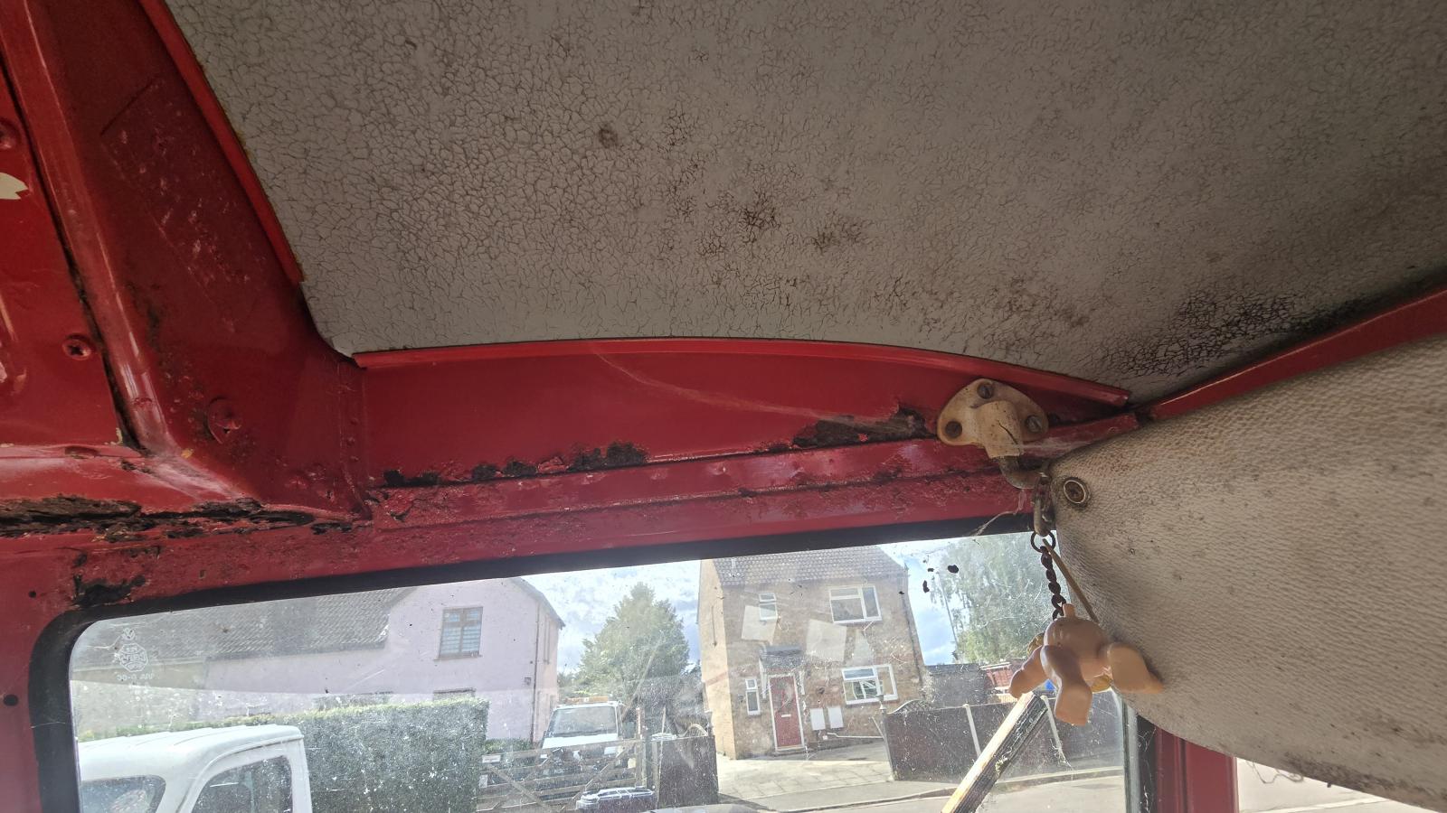

PostPosted: Thu Sep 18, 2025 8:06 am    Post subject: Re: "Negative Nancy" - 1967 Single Cab Restoration Reply with quote
No further progress, but here's some interior window frame/air box gore for you all:
ddutch
Joined: June 17, 2020
Posts: 232
Location: Nederland
ddutch is offline
PostPosted: Thu Sep 18, 2025 5:04 pm    Post subject: Re: "Negative Nancy" - 1967 Single Cab Restoration Reply with quote
Hopefully you are able to fix those rust spots inside without removing the roof. Looking at the flaking paint on the ventilatiion box and on some other parts, I guess your truck was originally Pearl White.
