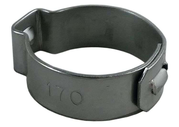

Im wanting to start using these on then notch and maybe the bus. Mostly on the notch. Why? I do like the clean look and for sure give a more "correct" engine bay.
In most workshop manual pics from the factory that I see, the clamps are a mix of these Oetiker clamps, screw/clasp type most of us use or no clamp at all.
I have seen lots of stainless, ratcheting type but want to stick with Zinc steel for correctness sake.
What sizes will I need and where is a good place to get them other than crap from Amazon??
I know my brother Scott uses these (pic below) but what are your experiences?

I use them a lot. I still stick to fuel injection style clamps for things that I might have to take off a few times...carbs, fuel tank. That is the down side of Oetiker clamps. The other down side is that it is sometimes difficult to get a crimper in there but a screw driver would be easier.
I try to use this style in stainless. Single ear stepless.
The simple double ear ones I don't like because they can pinch the hose.
Even the single ear ones can if they aren't stepless
As for the screw on clamps I stay away from the hose clamps and go for the FI style ones. I found them much better for the hoses.
For a crimper you can use the purpose built one or in a pinch you can use side cutters if you are careful.
As for where to get them. I got them off amazon. Price was right and the quality was fine. I just made sure the style was the correct one for me. They probably all come from the same factory in China. If you have time to wait for shipping I am sure you could save some money and buy them off aliexpress but for me, the 3 weeks waiting wasn't worth the minimal amount of money I would save. It's not like I needed a 1000 of them.

I dont like them....for partially the same reason old_man listed.....for things that occasionally have to be removed for service......but the real reason I do not like them is the reason they are no longer used. More precisely why they were forced to quit using them and went to spring clamps pretty much around the world.
On virtually every older VW and foreign car that I have worked on.....these clamps are a spurce of vacuum leaks. On the areas where they were used for pressurized fuel.....they cause leaks with age.
The problem is....they are "un-sprung". What you crimp them down to.....is all they have. This assumes the rubber line they are crimped around....never dries out, never shrinks and never changes from heat cycling. As the hose shrinks the clamp has no acfive spring to take up the slack.....so they get loose and leak. The problems with these clamps are worse in hot climates. Ray

I used the Smooth screw style listed. As far as the comment about them not springing with the lines expansion and contraction, If it leaks I replace it. No reason to cheap out on these lines with them being readily available now days.
That assumes they only leak when its convenient and you are not moving....and you get the chance to comfortably and conveniently change them when you get time.
They were used in the fuel tank venting system of D-jet. Pain in the ass. If they are leaking and you smell it and its warmer than 85 F outside...you will never SEE a leak when you are driving and smell it. By the time you stop and get out...what was there is evaporated.
The smooth fuel injection type clamp...third picture...used in the rest of the fuel system....pretty much works for everything.
For the small 3mm lines from the fuel tank to the carbon canister or vacuum advance to TB lines or MPS to manifold....I use these or actually a variant of them.
