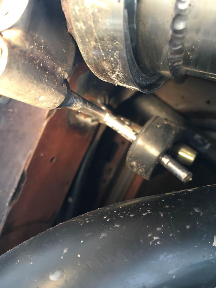

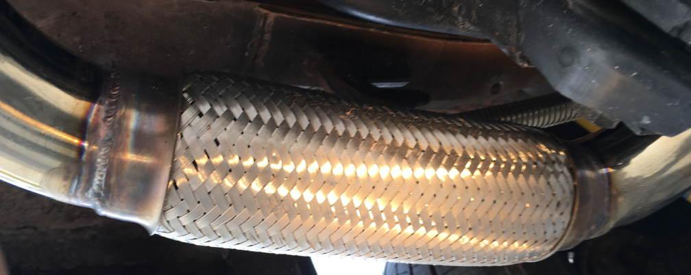

Turbo out:
Downpipe:
Under carrier bar (small corrugated tube is diesel heater exhaust):
Exhaust pipe going back:
Flex section:
Muffler hangar and V-clamp:
Hangar off frame:
Spiral muffler (Moroso 94054) and tailpipe. Note clearance to get a socket in the 12point crankshaft bolt:
Tailpipe hangar:
Tubes I got from http://www.allpurposepipes.com and all other parts from Amazon. A hint on the tubes, they are very hard metal and your metal shop will need a saw with fine teeth, or abrasive cutter.
