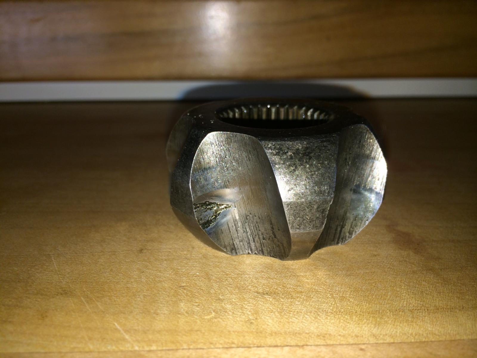

I have replaced my half axle inner CV joint on the drivers side (3)three times in the past year. Same scenario each time:
Purchased NEW LoBro's, using REDLINE CV2 Grease, centered the axle in between the boots.
After a couple hundred miles I will begin to hear a clicking sound when turning to the left. So I will check the axle and it has moved towards the hub or stub axle shaft and will make contact during the turn and on acceleration from a stop. So I will re-center it in the boots and zip tie one boot to hold it there. Then after a few hundred more miles I will feel a slight "pop" when engaging the clutch from a dead stop. After (3)three times I know what that feeling is.
It is a pit that has developed in the star or center of the CV. There are usually a couple of them. I use plenty of grease and make sure it is worked well into the joints. Like this PHOTO:
This last time I purchased a complete half axle already assembled, installed it, and the same scenario happened again. I replaced it last weekend and it is smooth and quiet again. Confused This time I did not use REDLINE and just used the grease that came with the kit. I have about 100 miles on it now.
I am not overly lifted and my measurements are around 19" on all four wheels. So I don't believe that is my issue.
What the heck could I be doing wrong? I use new GOOD parts and the same thing happens every couple thousand miles! Shocked
Same side, same thing each time. Rolling Eyes
Any ideas from the group?

So where are your pits forming? I take it that is NOT your CV pictured, right? If the CV is running at an angle, I'm trying to visualize if your wear pits would be in a different spot from one running at a stock angle?
Yes, this is not a photo of my CV. But the pits are about in the same location. Once I get off work I will photo the CV and post them on here.

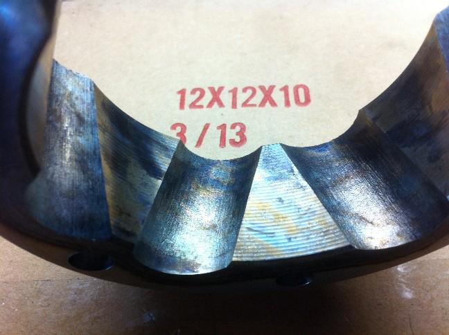

Who ever is making these CV joints you have is doing a real crappy job.
Just by looking at the picture you post, you can clearly see the "ways"
and not machined smooth. Also I don't see any evidence of the surface
hardening found on a good quality joint. Have you tried taking these
back under warranty? For some reason people don't seam to do this anymore. All that does then is tell the manufacture that they can sell
more junk.

He just said the photo posted above is not his.

Here is a brand new GKN/Lobro CV joint that I posted about some time back. They are heat treated, you can see the bluing, but the finish is rather coarse.
1vw4x4 how about telling us where you get your quality ones from? This particular joint came from either IMC or WorldPac. They don't make the parts they resell them. If they are GKN/Lobro, no matter who resells them, you'll get the same part. GKN/Lobro at one time was the OE supplier.
As Dylan suggested, some prepping of the rails might improve the time, but these are CV joints, they should just work. My Acura has 200K on the joints and boots. I am not so interested in a warranty as much as not having to redo a job that honestly should last for 60K with the boot supplied.

I do like the idea of polishing them. My last set of LoBros were also very tight.
I was just speaking to a co-worker who has sand rails about his CV joints. His last set cost about a grand! Shocked
But he said they are polished so smooth and slippery they about fall apart in your hands.
That would be the extreme!!
http://www.ebay.com/itm/Pro-Am-Porsche-930-Or-911-...4897.l5660
He will still wear a set out over the summer at the dunes.
