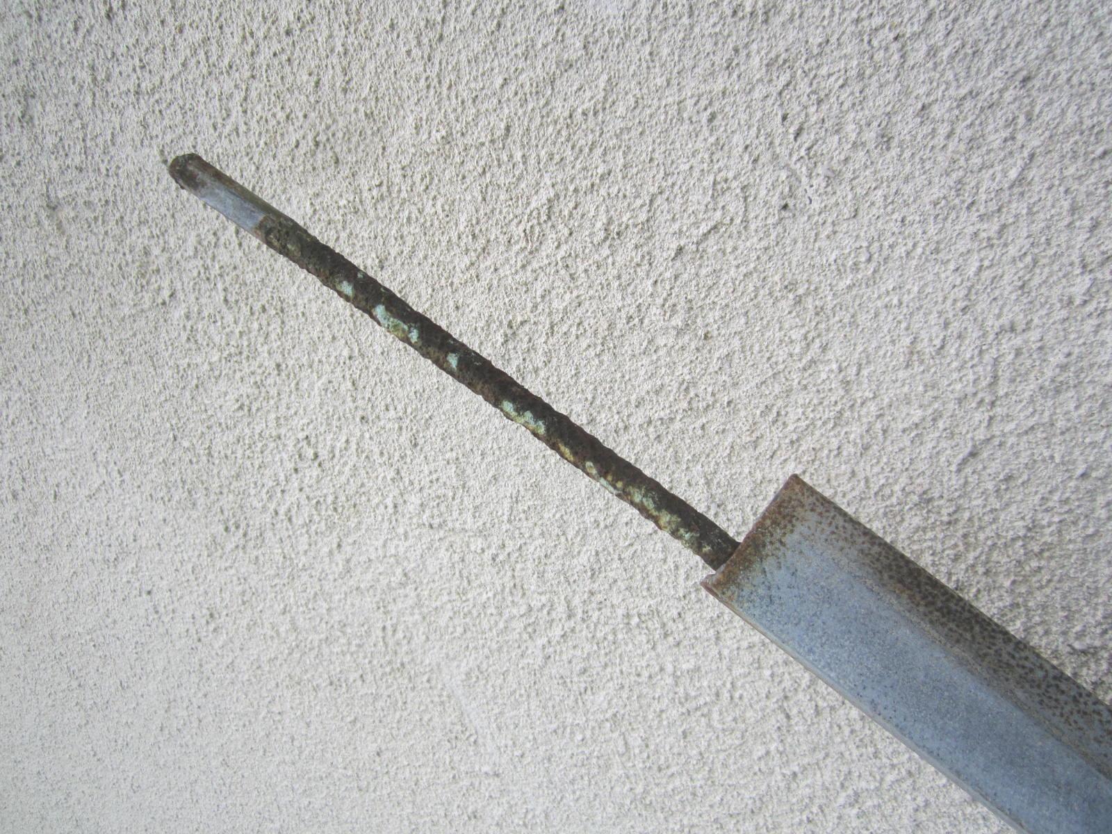

PostPosted: Fri Jun 19, 2020 9:23 am    Post subject: Re: Lightning Rods - SEEKING advice! Reply with quote
This is what was on there before - you can see there are 2 very tall rods.
www.edwardpowell.com
