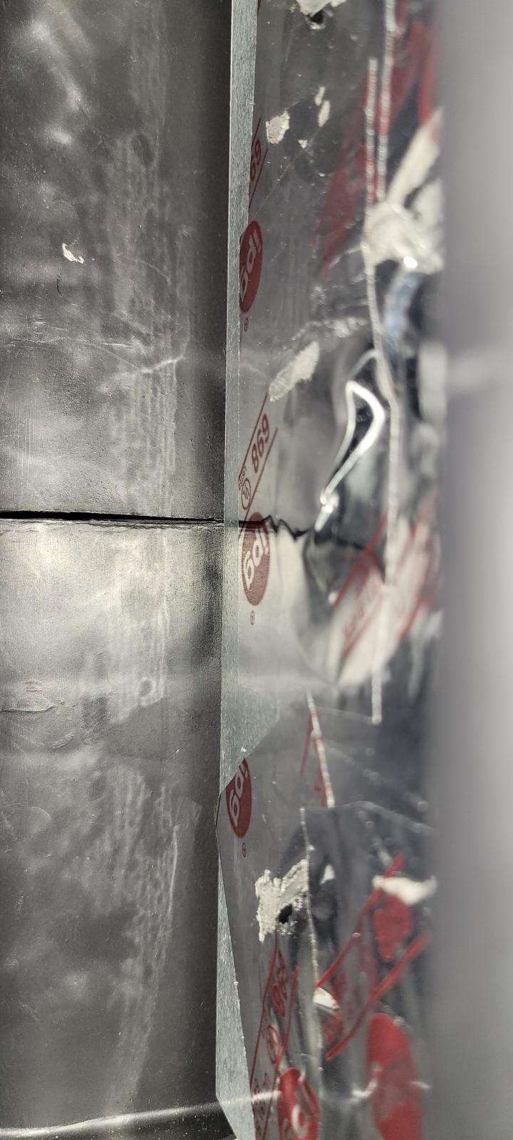

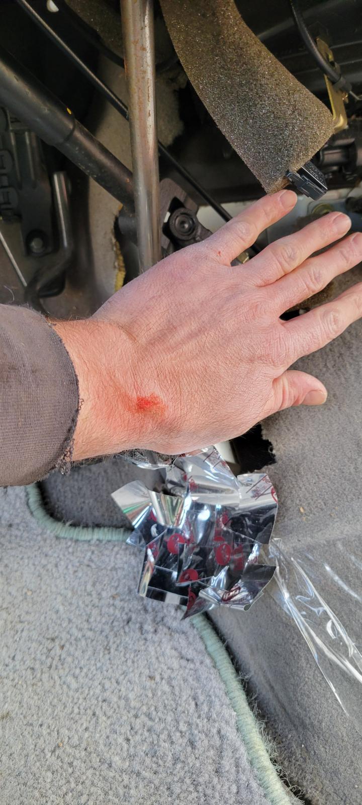

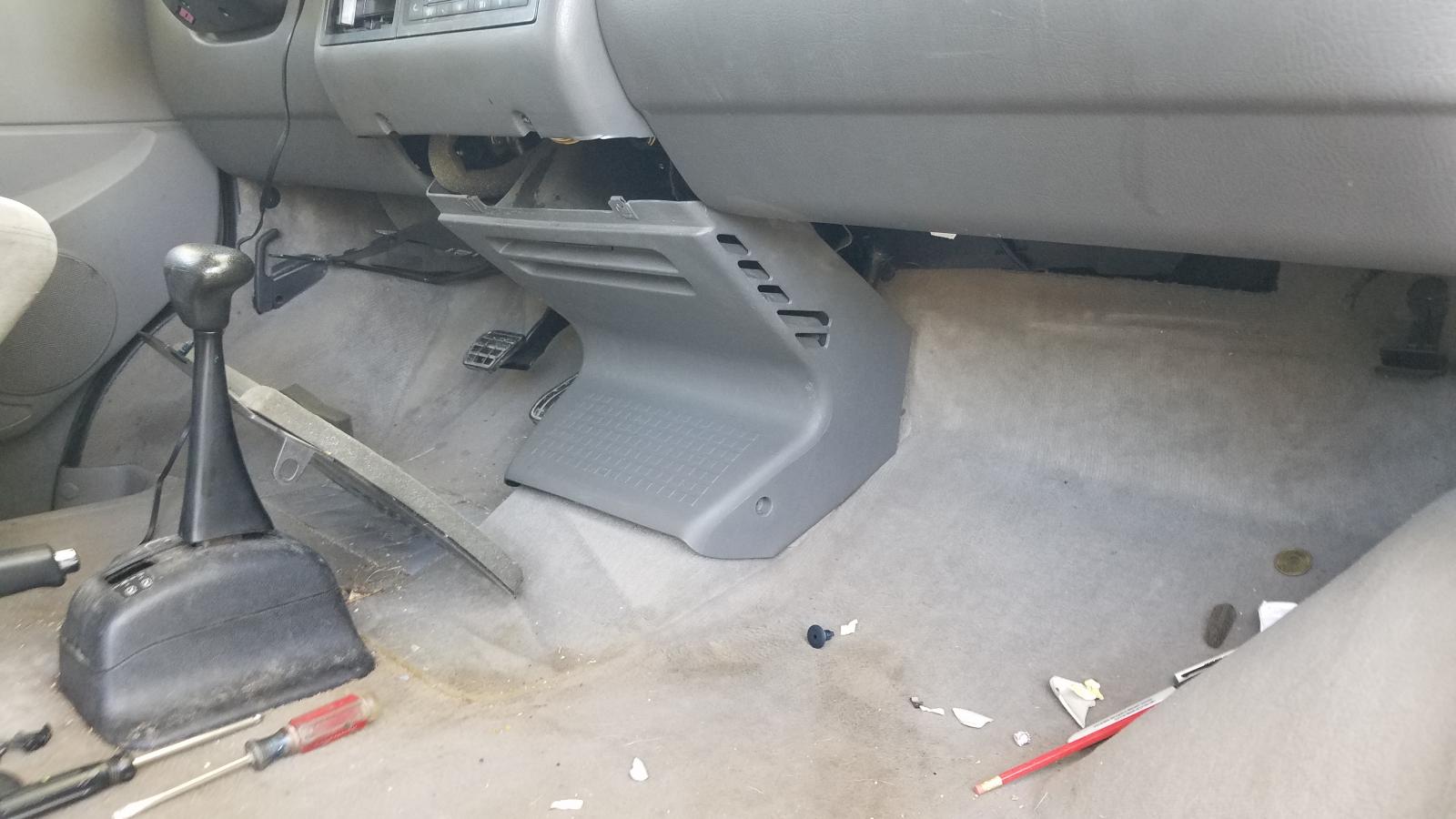

I'm glad this thread popped back up again, and I thought to post that pic of my old van's flap from when I did the heater core, because I wouldn't have remembered that set of holes on the left side of the flap as I re-did the project today.
Evidenced by the scrapes on my hand in this pic... Also visible is the pile of pieces of tape that got folded over or whatever as I attempted to insert them into the hole.
Couple more tips from this time around:
it is worthwhile to remove the driver side seat and base; I didn't find that the passenger seat was in the way today so I left it in.
Don't forget that the heat/temp control flap has the extra row of holes that I could not figure out a way to see with my phone, as it wouldn't fit far up into the duct hole to get a pic.
Do be patient and methodical while doing this, because it will be frustrating when a piece of tape folds over or whatever.
Experiment with angles of approach. For the majority of the holes, I was able to reach in with my right hand, while in a seated position just in front of where the driver seat is.
For a few of the holes, it was easier to reach in with my left hand while laying mostly prone.
Don't attempt to use long pieces of tape. Use pieces that are slightly longer than the roll is wide and use a bunch of them. Long pieces are too prone to catch on something or itself. Unless you're real lucky on your aim, you'll probably need a couple squares for most of the holes.
Feel around with your hands to find the holes, then reach out and get a square of tape. Experiment with which finger to stick it to as you reach in. Sometimes you'll be more able than others to press it down fully.
Use your phone camera to check your work! I used the video mode with light on sometimes to just get a look around up in there. If you're laying at the correct angle, you can see enough of the screen to see what is going on in there as you move the phone around.
I also used pics to make sure I'd gotten the holes fully covered this time. From my old pic of the flap, it's evident I hadn't thought of this, as even the holes I knew about weren't fully covered.
Missed a spot.
That's better
For good measure, here is a before pic of the heat/temperature flap.
And also a pic of the taped air diverter/direction flap.
Then go for a drive and enjoy the heat! Even if it is nice out today.
