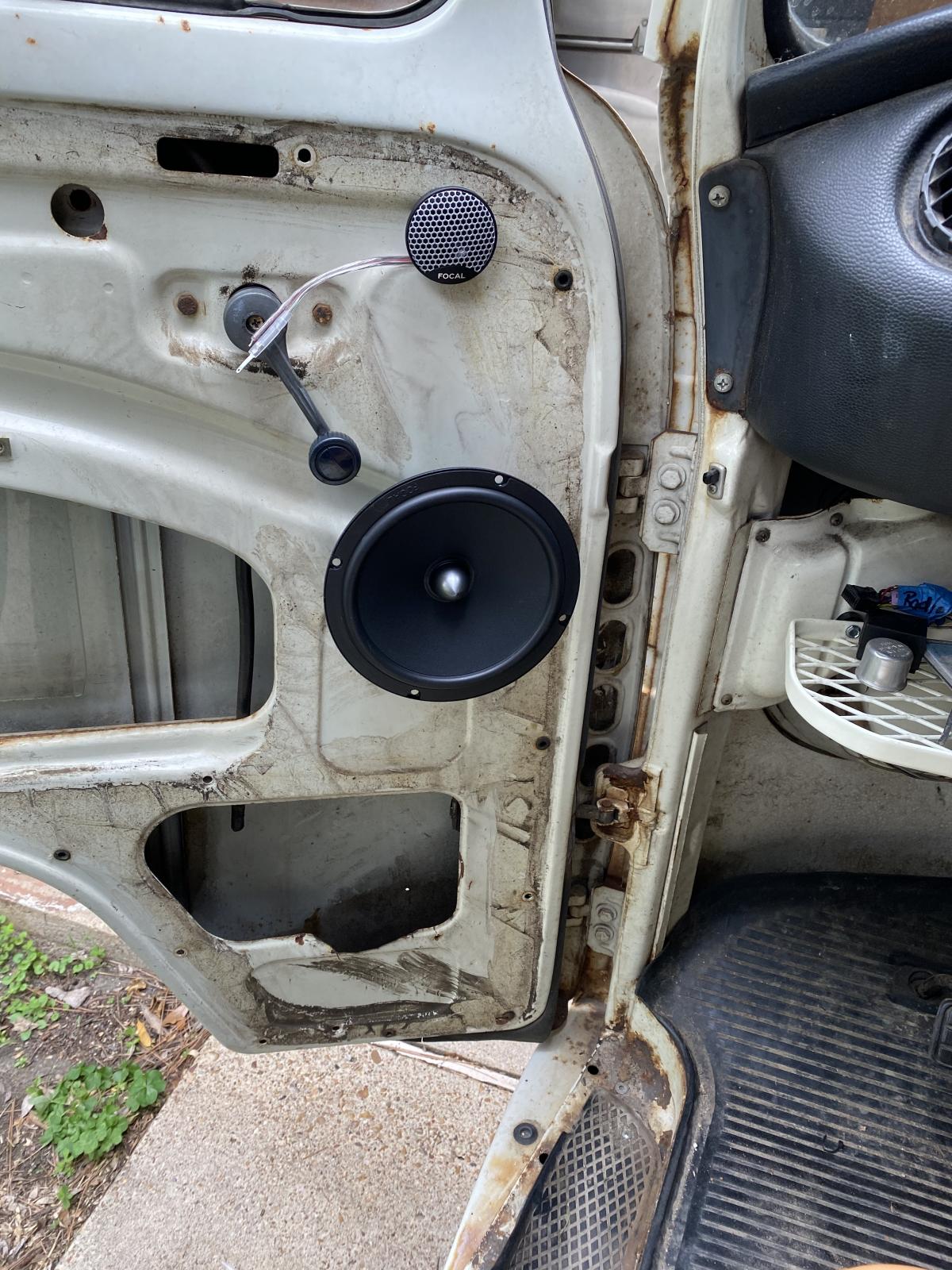

Anyone see anything horribly wrong with my proposed speaker locations? They do not interfere with the glass, dash, or window crank. They will be flush mounted through the door panel and to the steel door itself.

Just be aware that, by design, water will weep down the window and into the bottom of your door. You need to have a properly installed vapor barrier to protect your speakers. I personally do not like speakers in the door due to the moisture/water issues. Regardless of where you mount your speakers, make sure the weeps holes in the bottom of the door are clear.

Good point. I will install some modified baffles to keep the speakers dry.

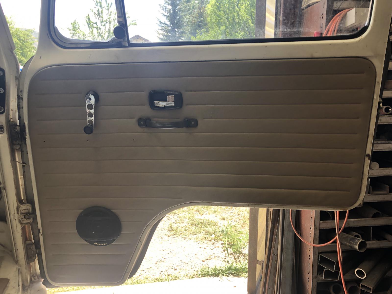

That just seems like a lot of metal to be removed. I used the opening below with a piece of aluminum angle to catch the 4th screw and stiffen the panel. I put riv-nuts on the angle and bolted through the panel to that.

If I had to guess I'd say aero is thinking "don't cut holes in your bus for speakers, find another way that doesn't involve cutting".

Late bay bus, already cut on by ASI to become a Riviera Camper....cut on by PO for a single DIN radio....further cut on by a different PO and converted to Subaru power.
I'm not the least bit worried about a little German steel being lost on the way to the enjoyment of my bus.

Just mount them to the door card so the magnet goes into the bottom hole, no cutting required. As stated above, make sure you use a vapor barrier. It’s not hard, buy some plastic drop cloth, spray the door with adhesive, stick on the plastic (leaving room for the speaker) and trim. You can buy speakers with a shallow magnet designed to clear the window for doors.

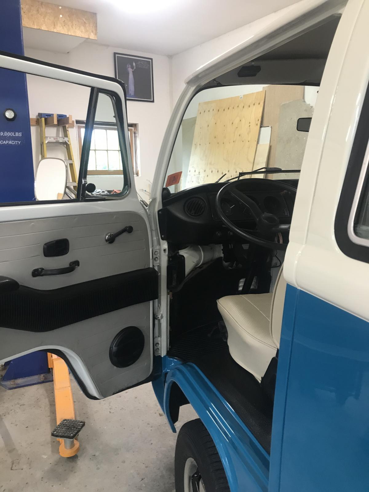

Mounting them on the door results in really poor sound. They face each other and sound terrible. I eventually mounted under-dash speakers - on brackets and tilted both slightly inward and up. The sound is SO much better, and no worries about speakers in the doors.
You could mount them between the dash and your parcel shelf. That's what I did on the passenger side.

If you don't mind removing metal and you've verified no interference go for it. You may get more sound to the listener with them up higher. My bus has the armrest vent so I went low. I prefer the tweeter a little higher than where you have it and maybe angled. Mine are in pods at the base of the A pillar. I kept twisting the pods to get what I wanted. A DSP will help. It's usually better to have more signal and tune down though.
