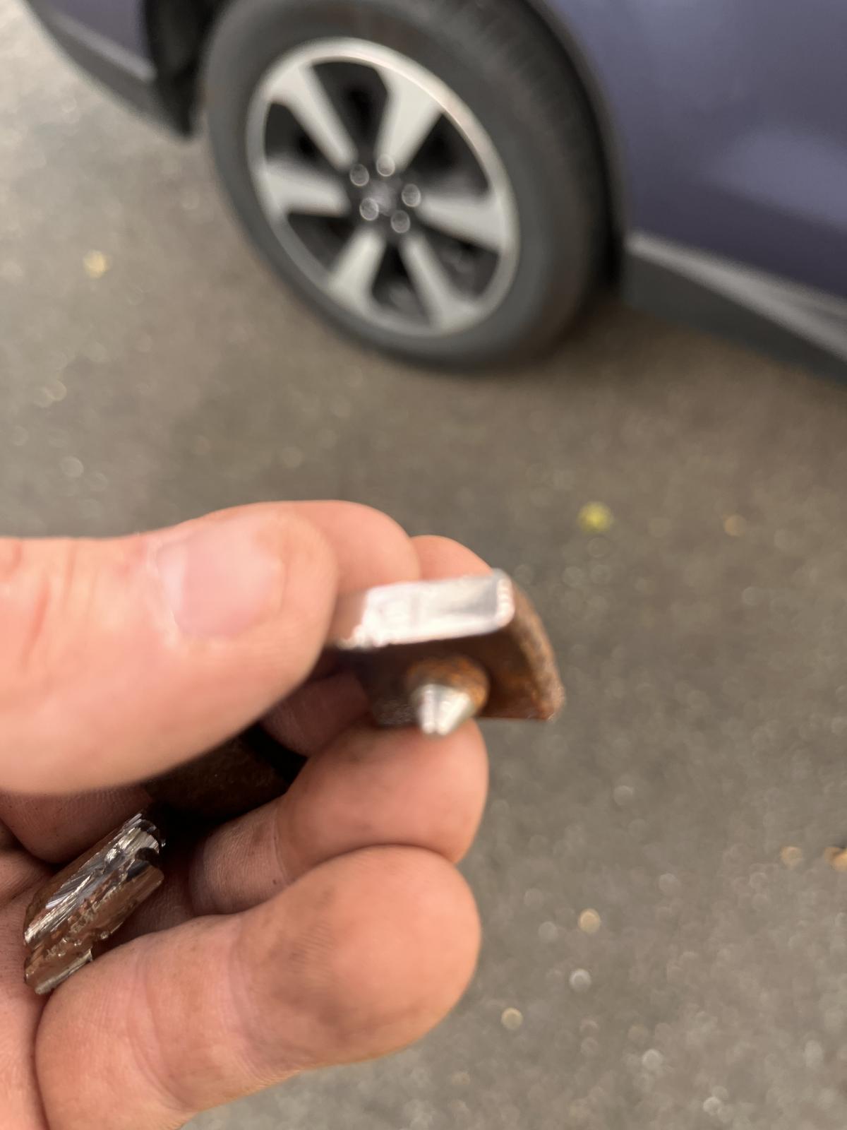

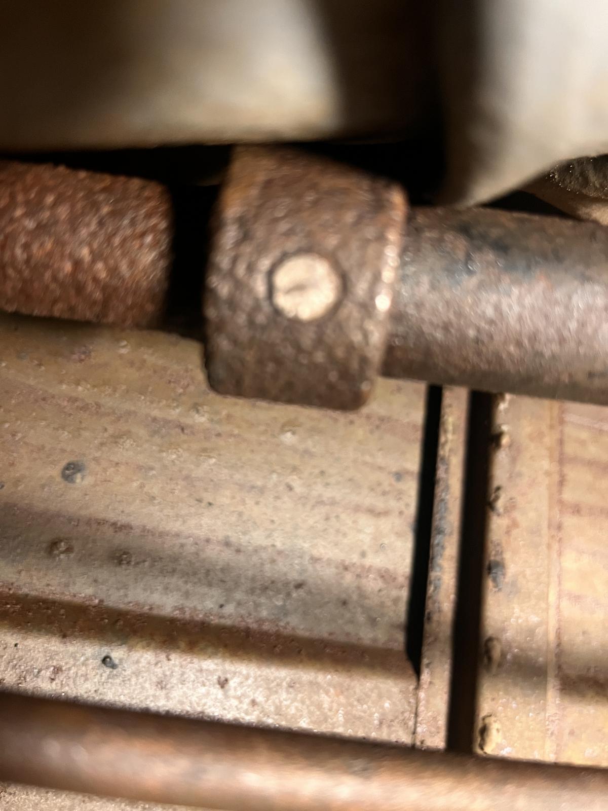

UPDATE as of 8-24-2025
The front couple screw's head snapped off.
Drilling it out will be a pain, to say the least.
So I will be cutting through on of the rods and removing them both.
and replacing them with brand new shifter rods, bushing etc etc from Wolfsburg West
This will all mew to get back on the road asap and enjoy the rest of the summer and falll.
Thanks for all your help!!!

I had the same problem.
Here is what I did:
1. I cut apart the ring, just two cuts and the thing cam off. The ring can be purchased.
2. I cut the front shift rod carefully lengths wise,just an inch or two, this will relieve the tension between the two parts due to the rust between them. the I could pull them apart.
3. The I inserted a piece of copper pipe into the front rod and welded the cut back together. And cleaned up the weld.
4. I made a new ring on my lathe. Bus, as mentioned, this part can also be bought.

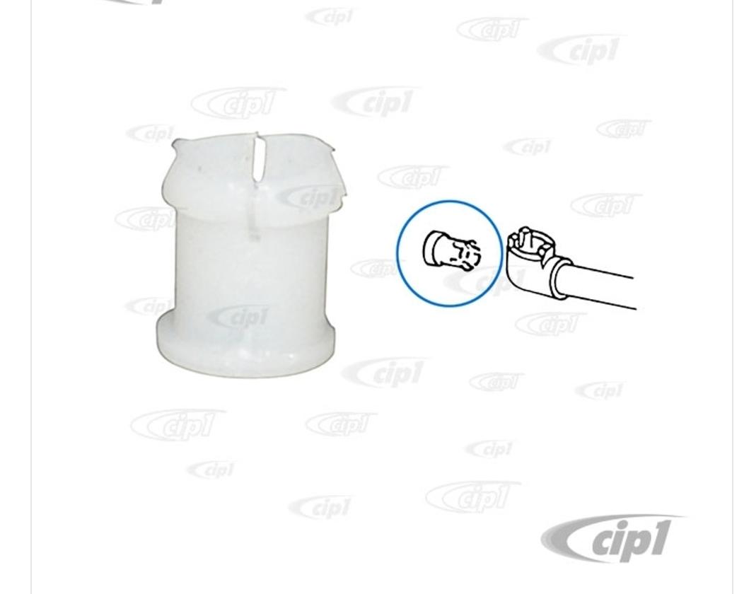

Since 66 and later use a different bushing for the shifter, you might be able to remove the shifter and get enough forward movement on the shift rod to get the coupler in place

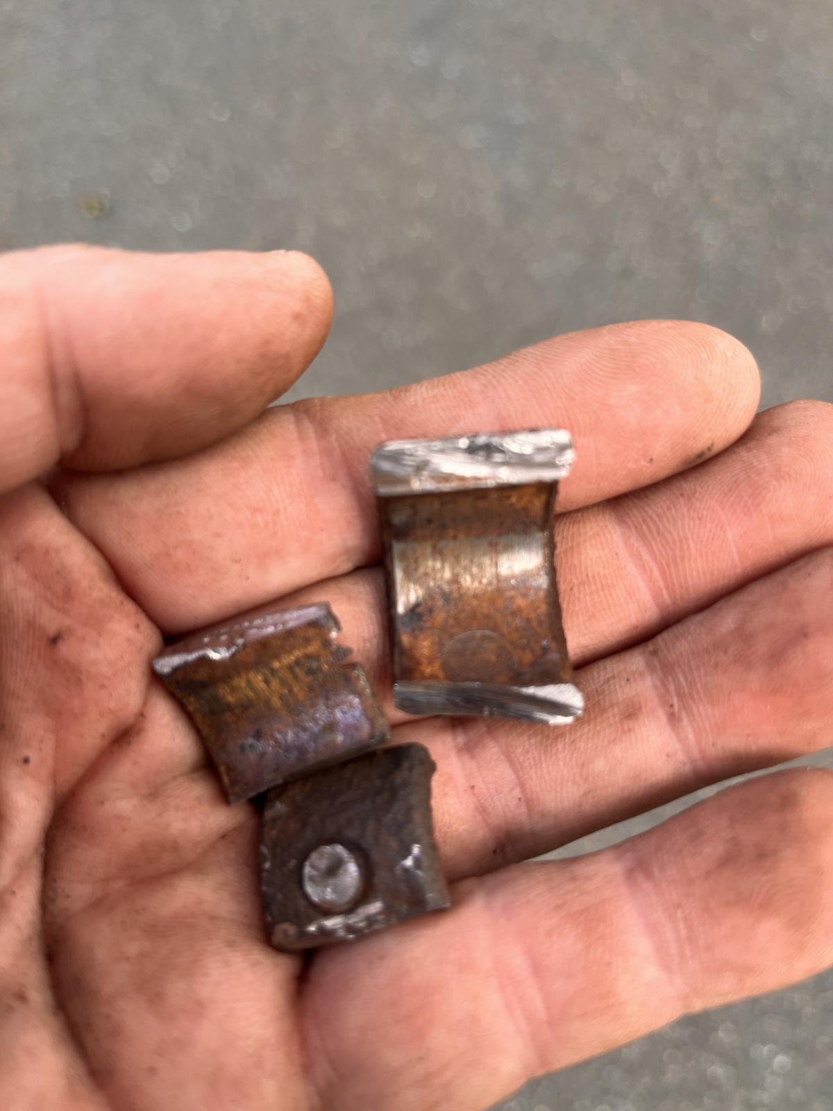

UPDATE 8-25-2025
Yes, I made a mistake in my previous update, I know see I need to remove the font coupller no matter what.

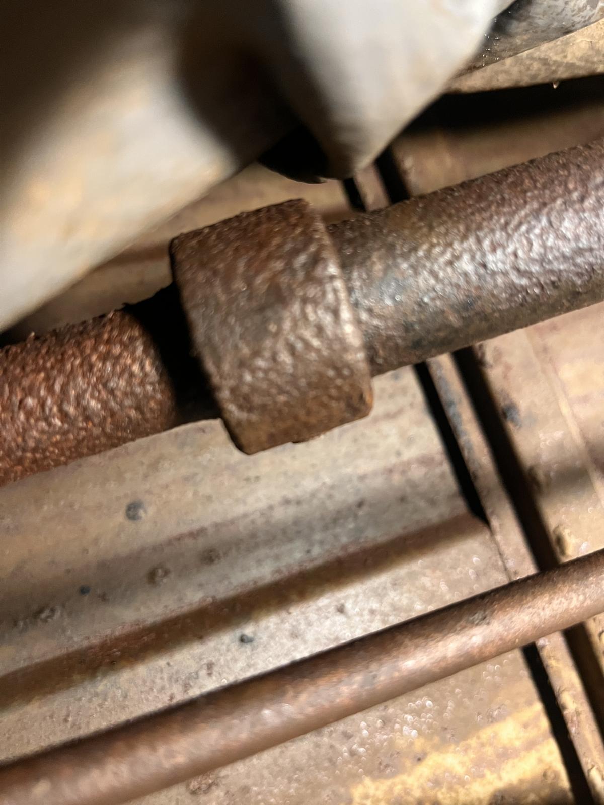

PostPosted: Tue Aug 26, 2025 7:19 pm    Post subject: Re: 67 Bus Shift Coupler Install Issue... Reply with quote
UPDATE 8-26-2025
Front coupler removed
The two rods are rusted together, I'm working ion separating them.
But, I might end up needing to cut the front rod and cut away its rusted end and replace it with a new front rod.
We'll see.

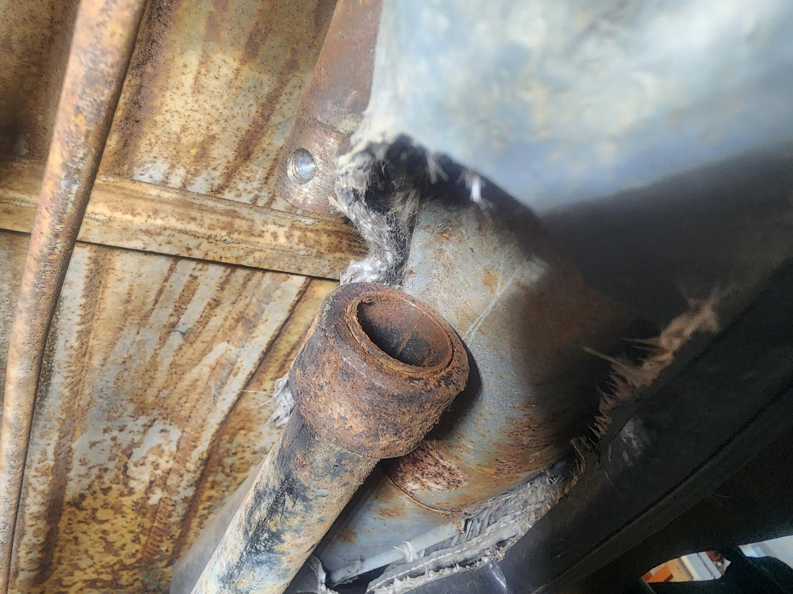

Jack Frisch
Joined: August 12, 2003
Posts: 771
Location: Northhampton, MA
Jack Frisch is offline
PostPosted: Tue Aug 26, 2025 8:23 pm    Post subject: Re: 67 Bus Shift Coupler Install Issue... Reply with quote
Thanks Craig!
Agreed,
I'm confident if I cut the front rod, I can then removed the rusted end attached ti the long rod easily with a grinding wheel, slicing and removing sections one at a time
Any idea how far the long rod inserts into the front rod?
How far does it go past the hold for the set screw?

Jack Frisch
Posts: 771
PostPosted: Tue Aug 26, 2025 8:29 pm    Post subject: Re: 67 Bus Shift Coupler Install Issue... Reply with quote
looks like there is not a long length that joins them, which means theres not a lot to pull apart to separate them
I'm inspired not to keep trying to separate them! and not cut anything
