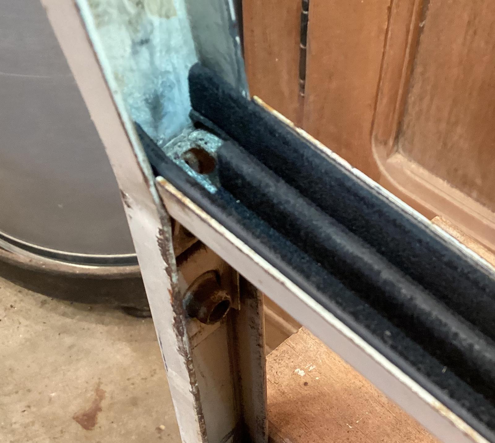

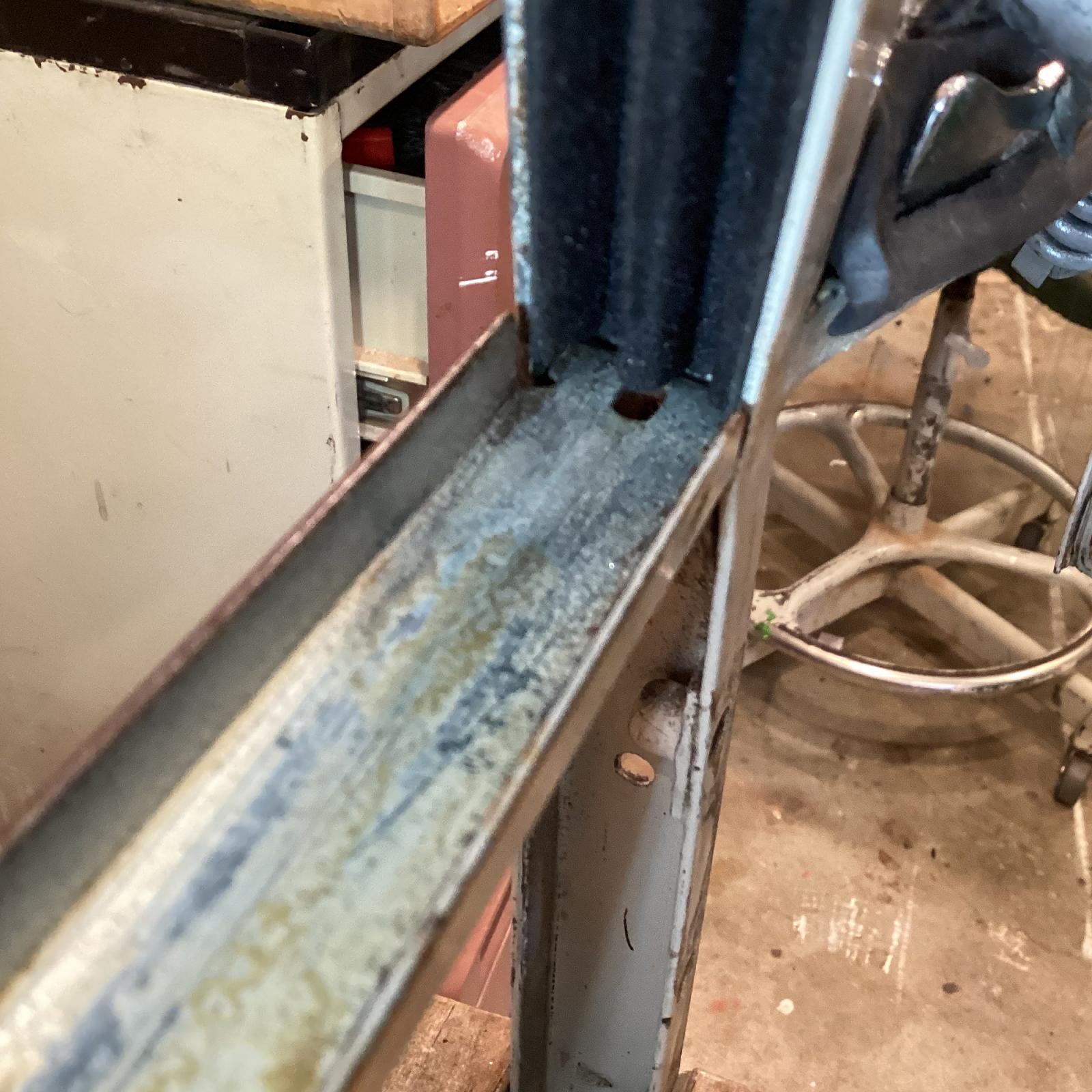

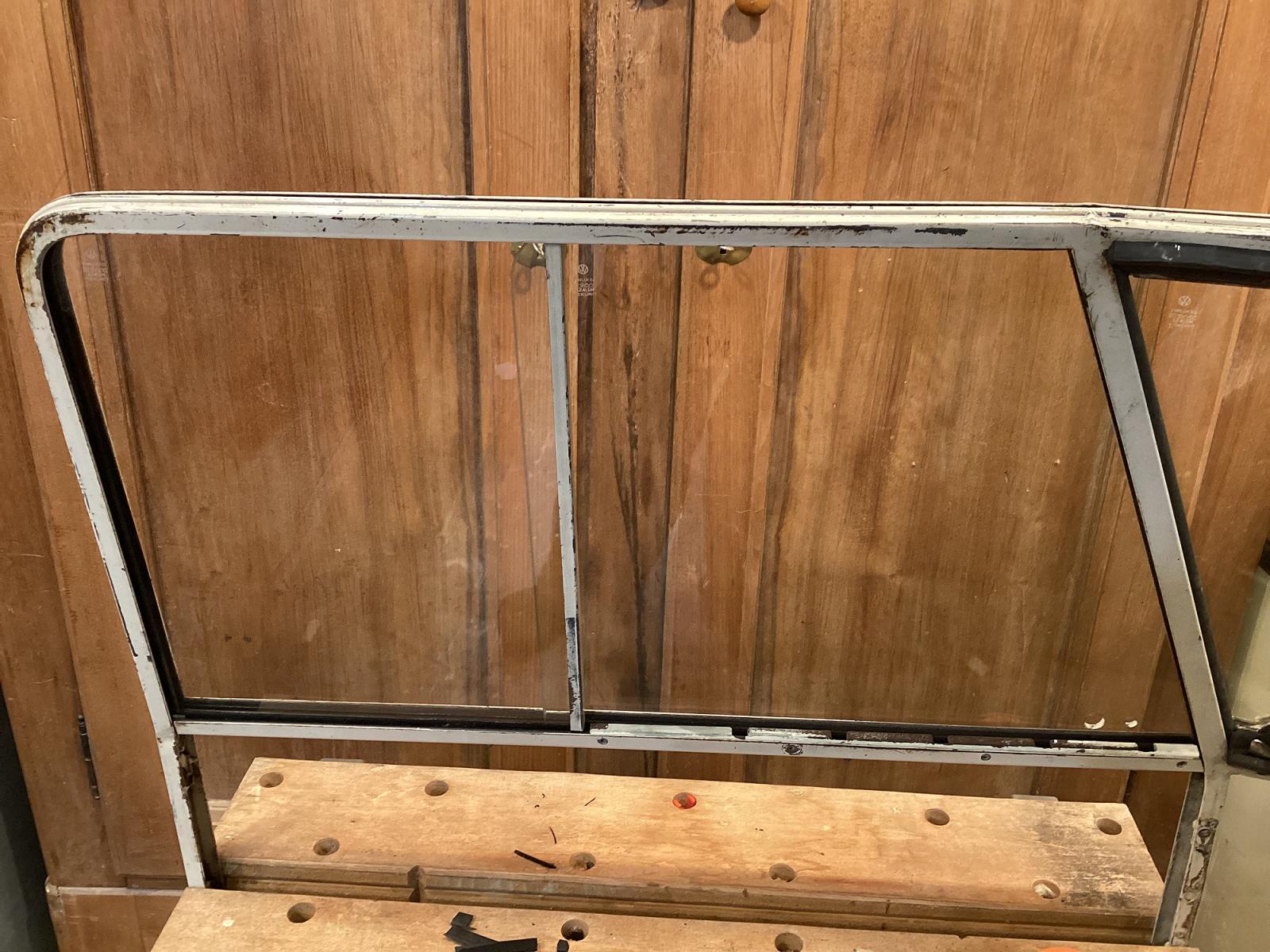

Here's what I have:

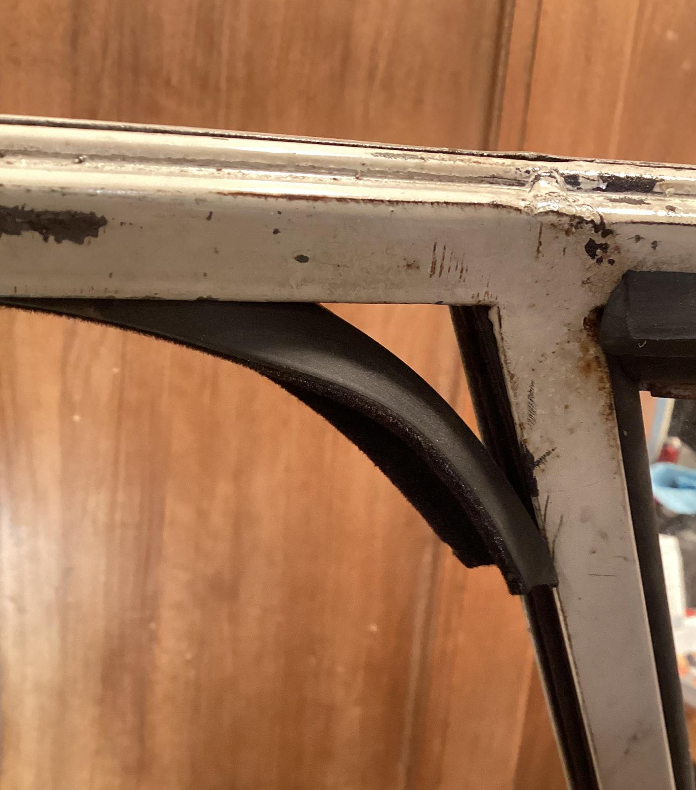

This is old front angle seal vs. new one; clearly a difference. I put the old seal back in, and while I'm sure it shrunk a bit over the years, it's a nearly perfect fit. Note 2 different angles, about 60 and 70.

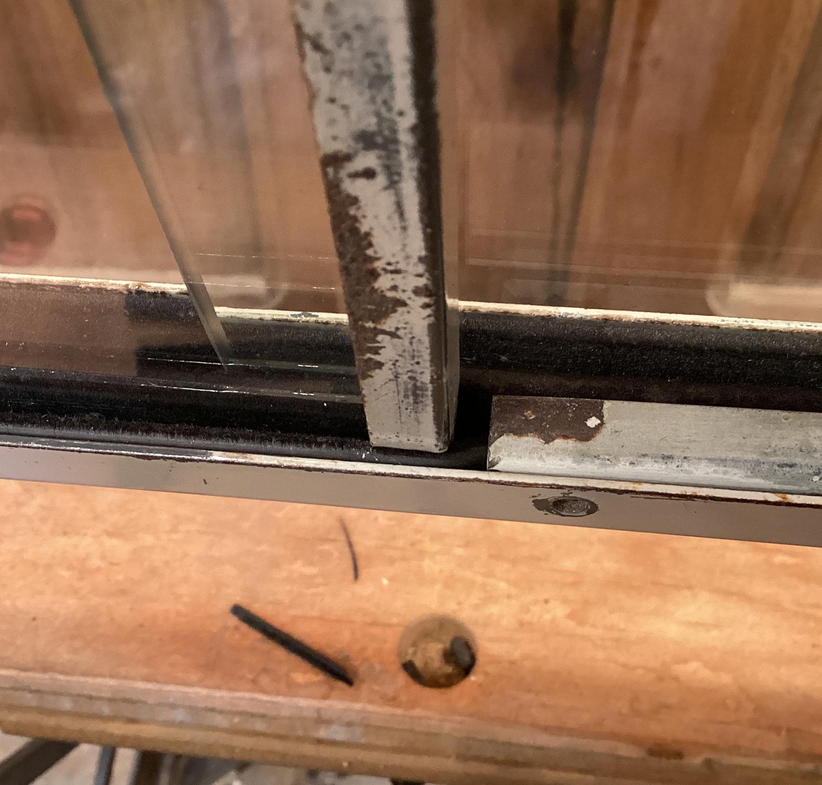

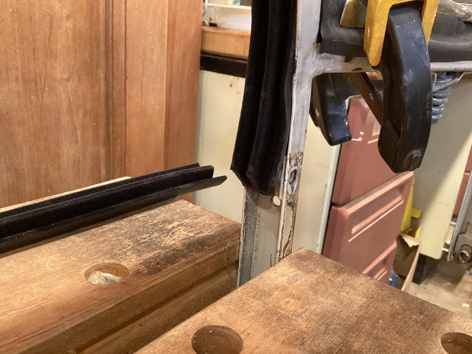

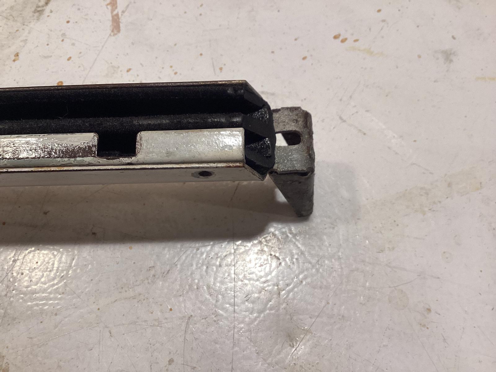

This is the bottom bar with felt seal and latch strip, set up so drain and latch holes match.... mostly; the felt by the latch strips 'creeps' forward a bit as you go down the metal strip. Angled end is at bar angle , which might be a bit short; 'tails' protrude past opposite end. Moving felts front or backwards to fix means holes no longer line up.

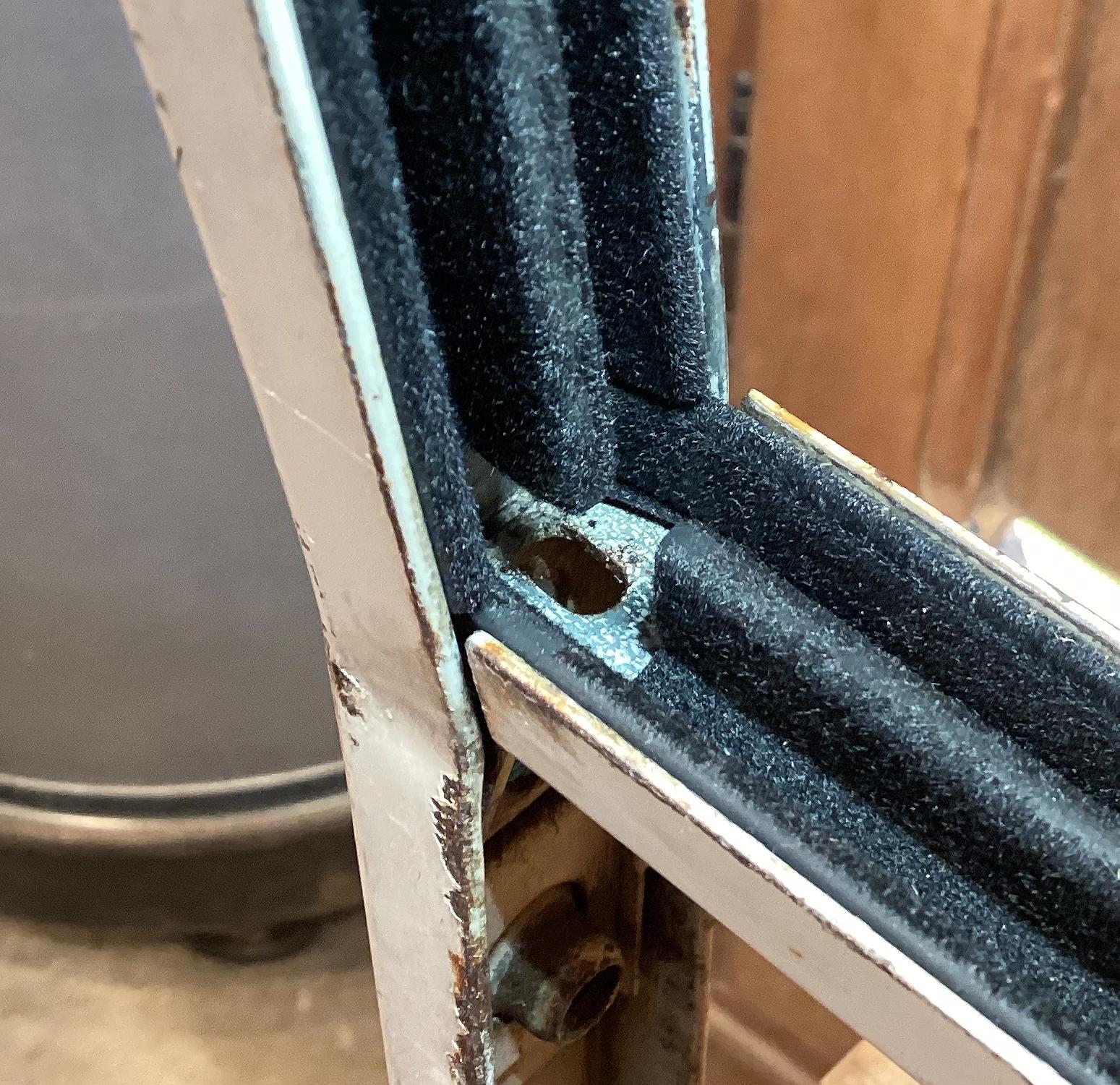

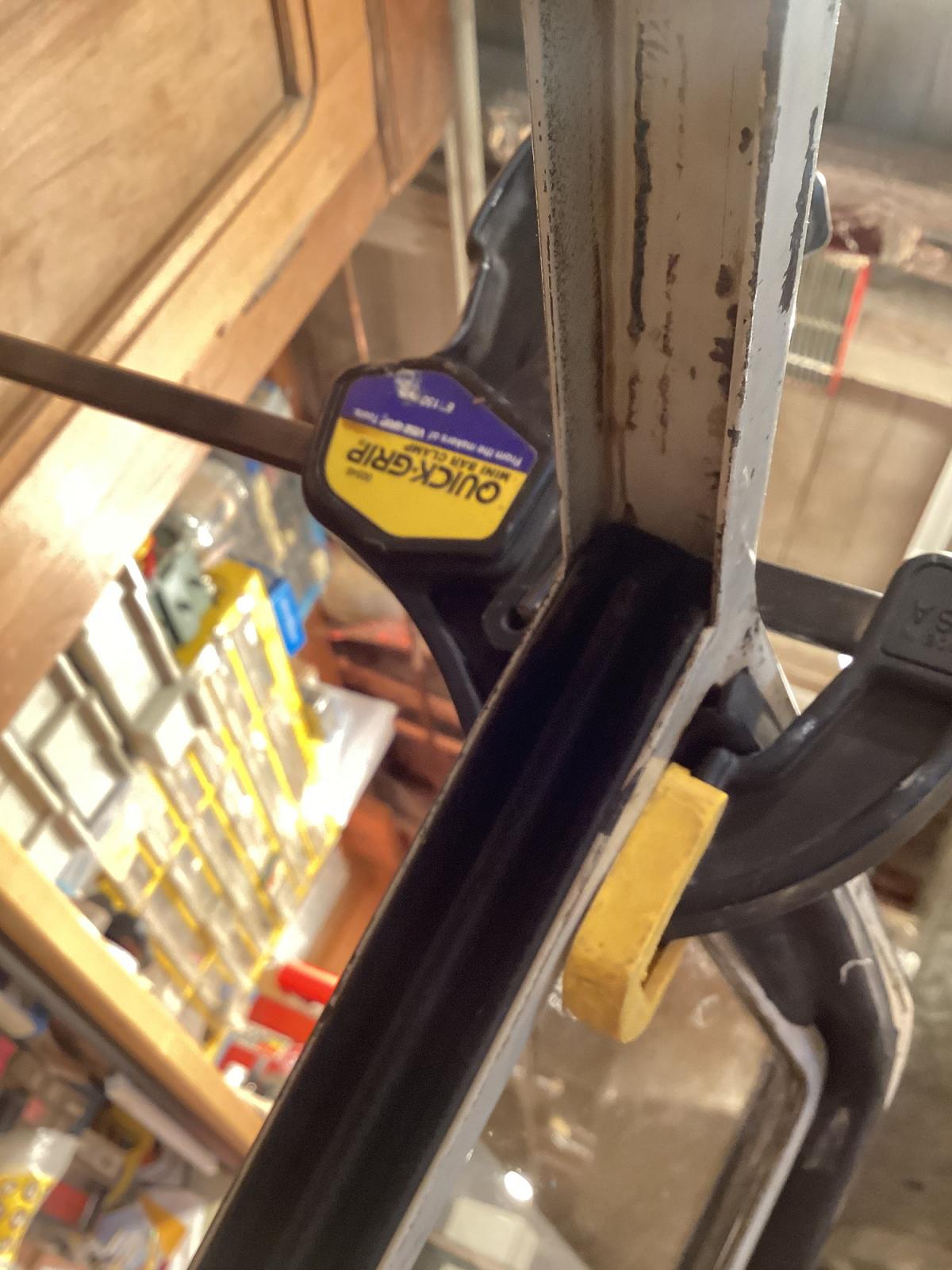

Taking the long upper seal at placing angled end as far in corner as it can go, the flat end falls here:
Put the angle felt in
and it ends here, below bar mount
Puting bar in:
Excess at top here instead of bottom
So I do need to trim, and just want advice on where best. Do I remove the 'tails' or do they fold somewhere? If I scoot the seal so the tails stay on, remember all the holes fail to line up! It's just frustrating that for some folks they seem to go right in, and some don't. And with no previous experience, one is left to sort through all the (valuable!) samba advice and pick a course of action. This is more rusto than resto, so ugly won't bother me, but function defects will.

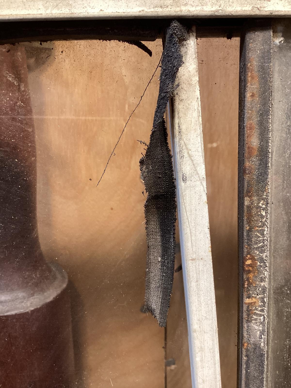

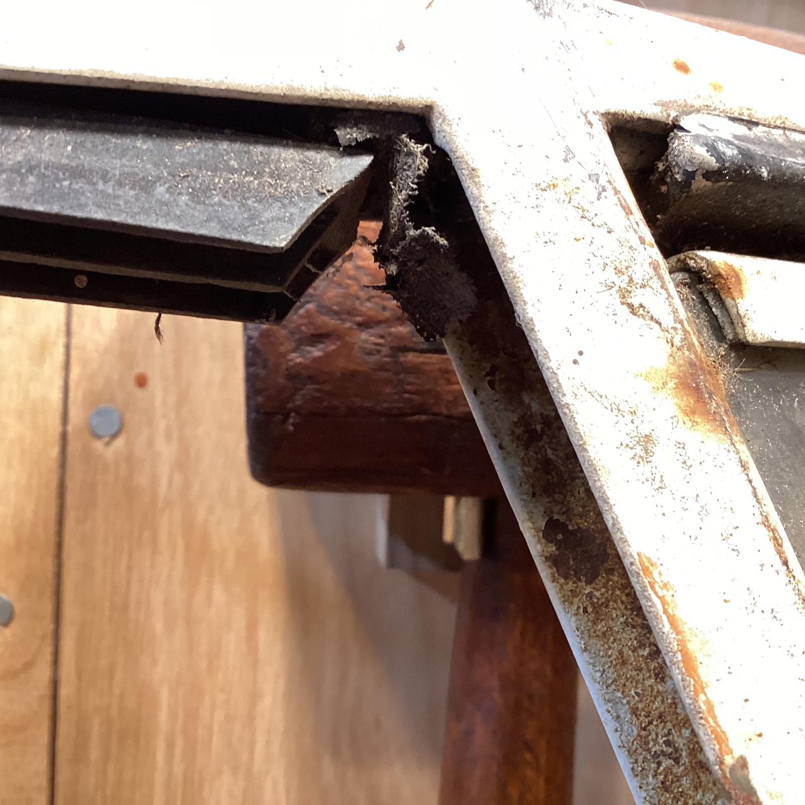

I dug out my passenger side frame; it should have OG rubber, or ar least VW replacements as it hadn’t been cared for since the mid80s. This frame is much crustier than the driver’s!
Angle felt is missing; upper cut approx 45 deg. Shrunk or cut short?
Lower felt front. Rib under latch strip cut away.
Test fit of driver side angle felt in passenger frame
Lower felt rear; tails present, and long vertical piece cut 90 deg just shy of lower felt
Test fit driver angle felt at upper vent side
Precut hole in felt for divider bar
Vent rubber. Scraper rubber is clearly installed first; vent rubber is installed to cover it
Upper vent. Rubber either shrank or was installed short. Scraper rubber is broken and would have filled some of the gap
So I think that between Barry’s pics and these I have a good idea of what I will do… still no clearer why some need a trim and some don,t,

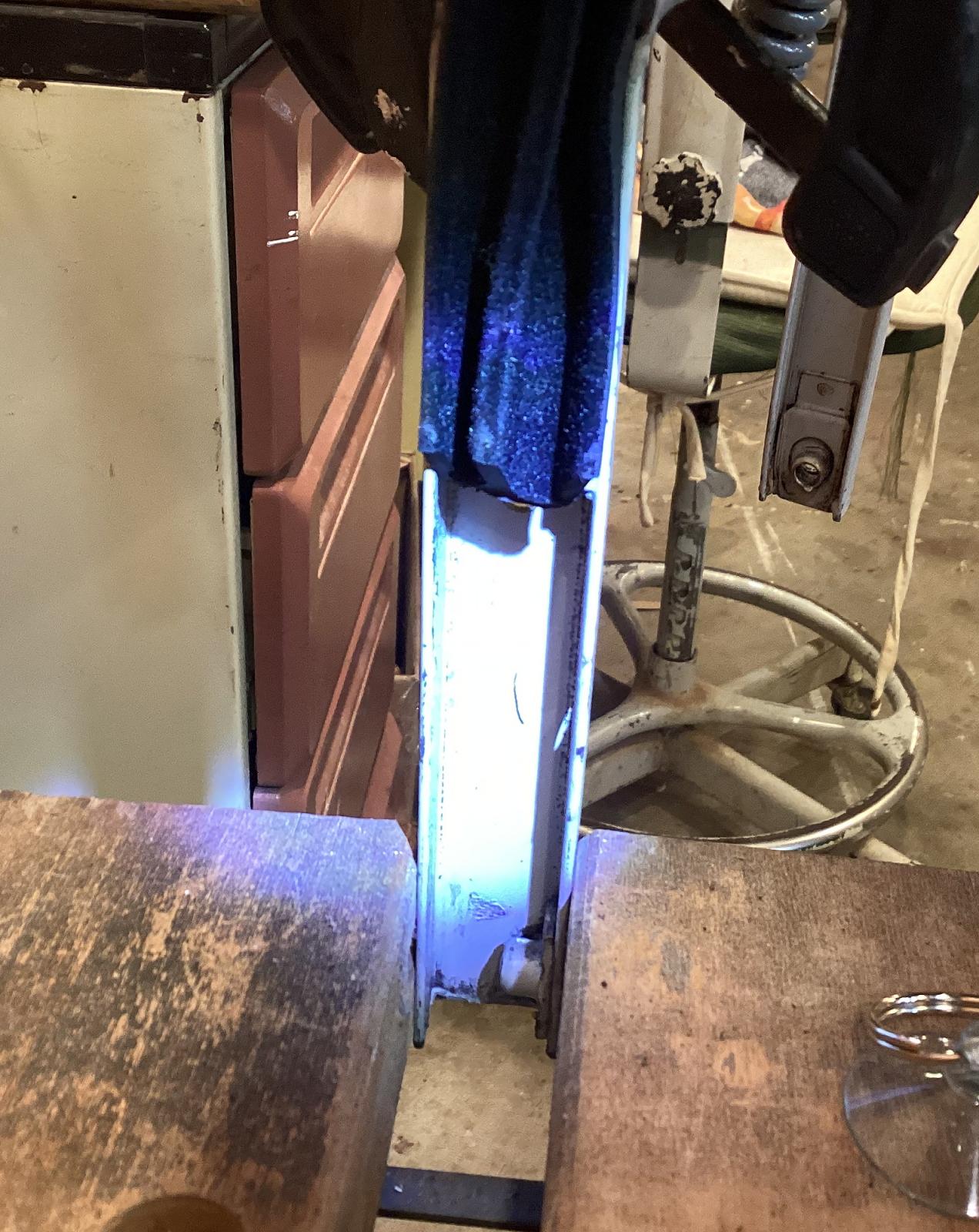

With the lower bar loosely in place (screws but not tightened), I first fit the front section which goes against the vent:
OG felt compared to new after cutting
This was about 42 cm and put the top factory-cut 45 angle hard against the top rail and the cut end (about 70 deg) at the bottom touching the bar

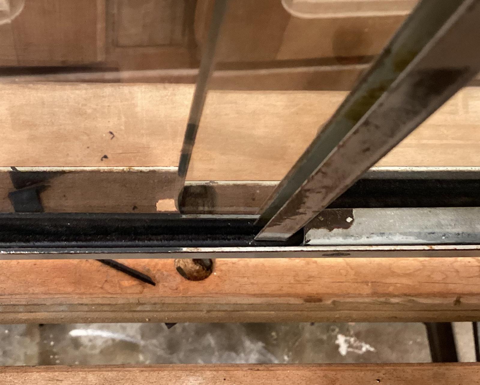

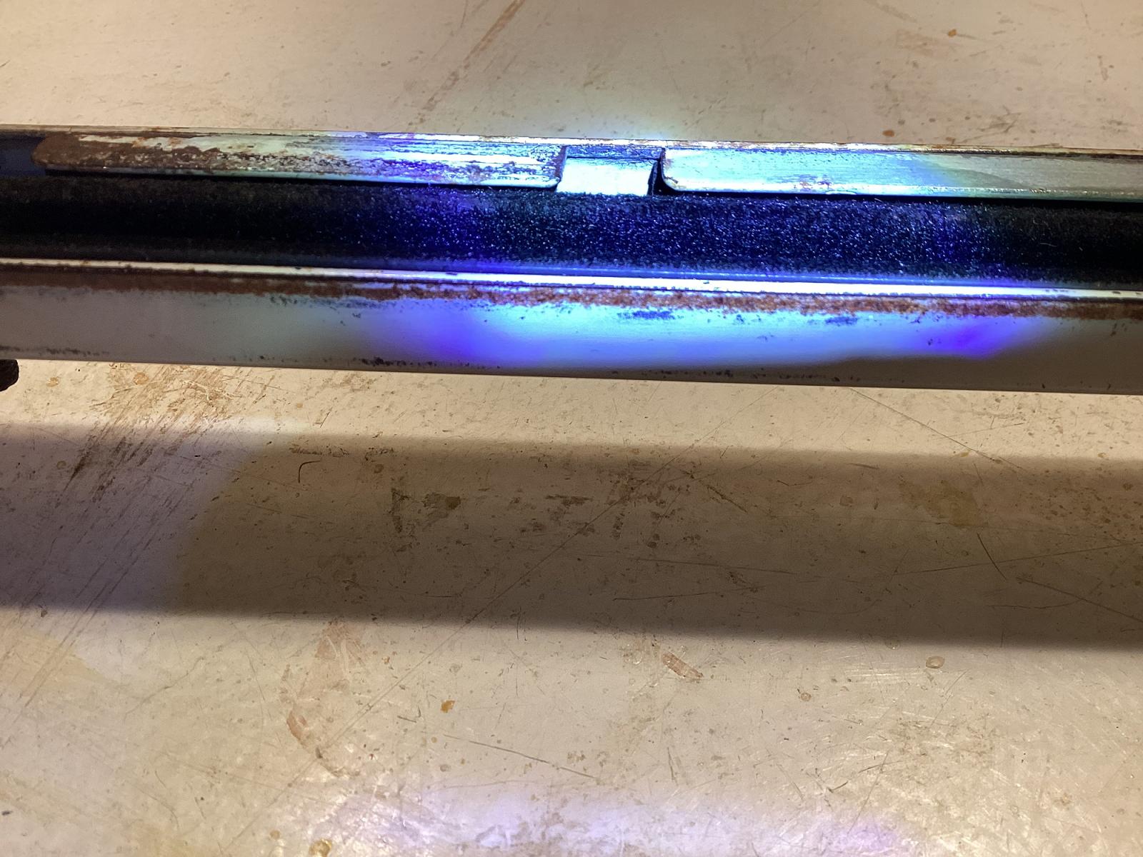

Next the lower rail piece; tails to vertical bar and cut to kiss the felt on vent side (about 71 cm, 45 deg).
Cut new drain hole and remove rib under where the latch strip goes, as factory
Now take the long piece and place 90 deg factory cut in the vertical bar touching the tails
A trifle long, so trim to fit; I cut roughly 45 deg. This piece and the felt in angle were secured with Gasgacinch; I prefer it's more-forgiving nature on seals. If they move, THEN I get the gorilla snot...
The one rib needs tweaked, but otherwise a nice fit. Put in glass, add more screws and tighten. I got SS hardware from Jeff Gagnon; screws are longer but that's no issue.
Ooops.
Undo; redo with glass in proper channels!

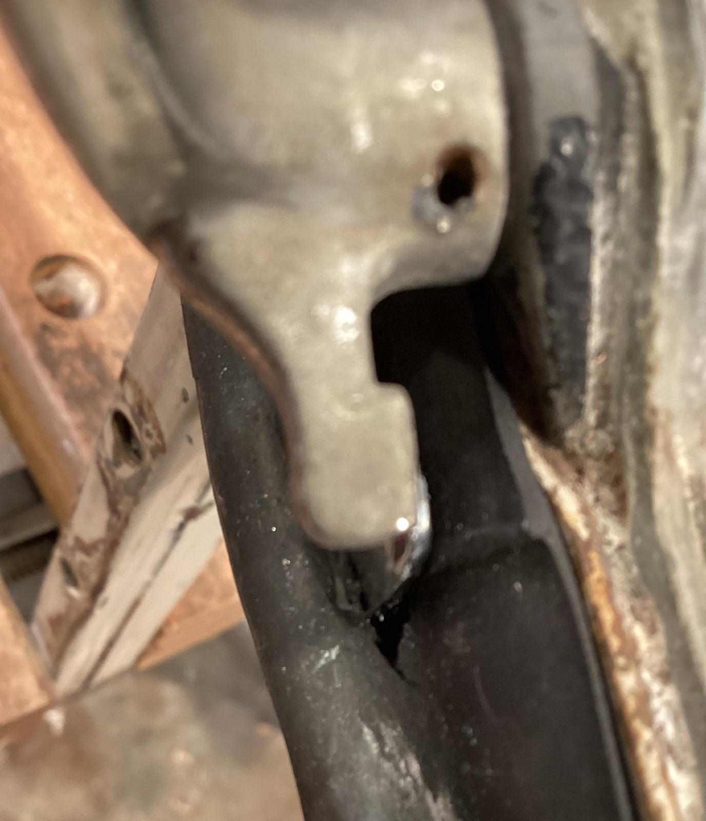

Latch needs new rubber and spring so just fit loosely, but even with the latch strip not screwed in it slides without issues and latches (what size screw/bolt to attach latch strip? Mine did not survive...). I'm puzzled by that wear pattern in paint on the end of the strip by the divider bar - am I missing something? The divider bar can't go over it, as the stationary glass is hard against the seals and divider is tight against glass. Little clip at top of bar, too. Latch strip holes all lined up properly...
Drain hole seems to be exposed at all times window is closed; correct?
What seems to be an OK job on the felts makes me want to redo the vent rubber; it doesn't latch w/out some pressure that worries me the latch will snap. I'm guessing I missed where the rubber should be cut around the chrome bit, distorting the rubber.

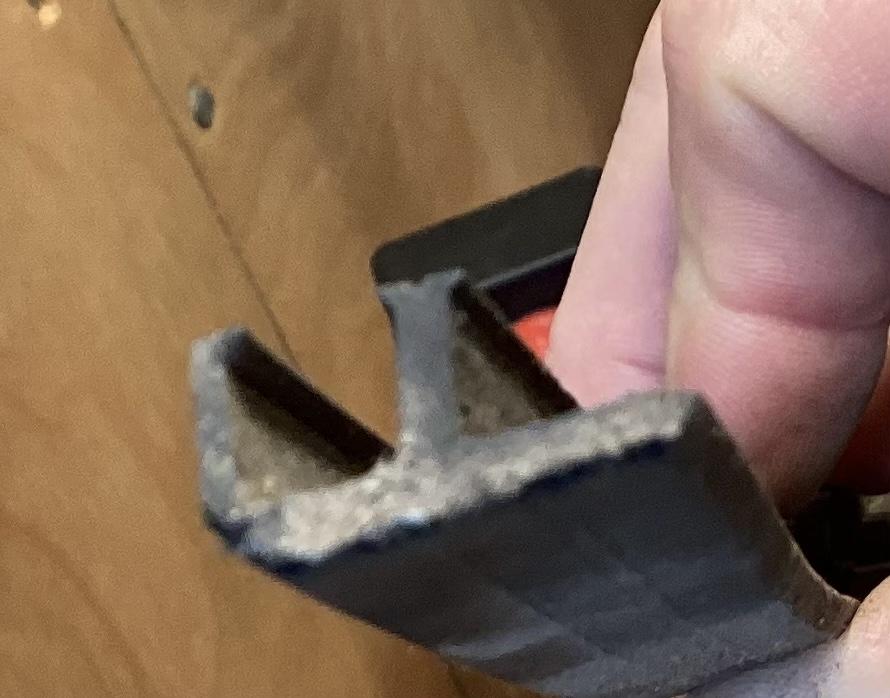

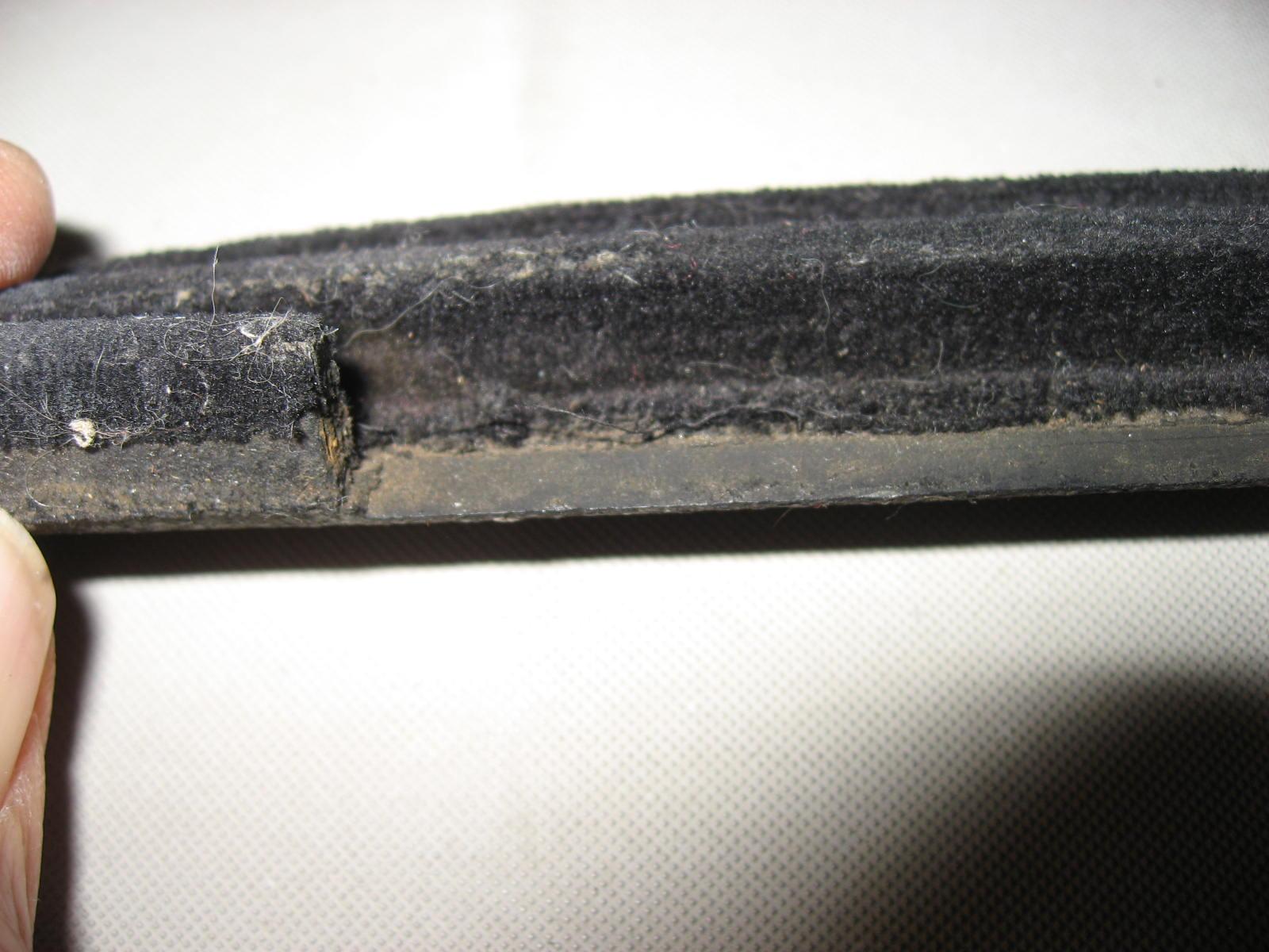

I have a question about the aftermarket lower felt channel.
Did they bother to make a separate tool for the lower channel?
The original lower felt channel had a slightly different profile from the rest. Top of the lips had an extra edge which was probably meant to give a tighter seal without affecting the slide operation of the window too much.
I m just asking, because I have enough of the upper felt channel material (NOS) to replace mine, but if I could get the correct material for the bottom I would do that.

This is what Mdege refers to:
Wolfsburg felts do not have that flare at top. It,s the same extrusion for top (R) and bottom (L).
One thing I do like is that the ‘felting’ is just flocking glued to rubber; when it wears off (which it does just in handling) you can just stick on more. Originals were toast once the fabric felt ‘skin’ started tearing.
