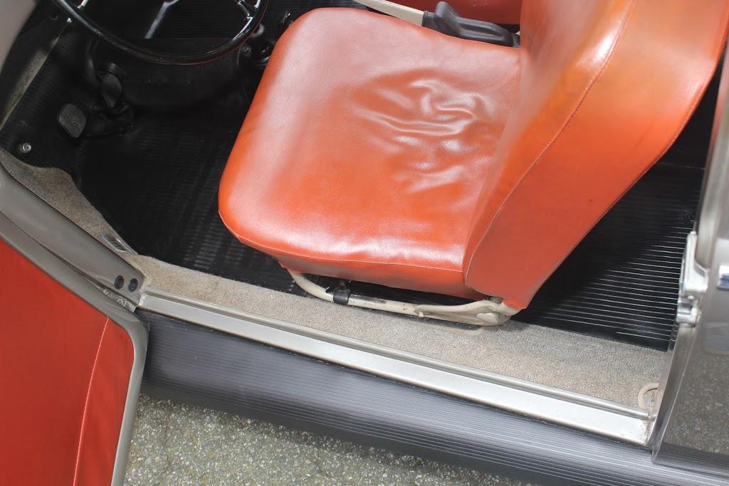

For what it's worth.
These pics aren't of a split standard, they're of a 1957 Canadian Custom (standard). They show the carpets that cover the heater channel are cut around the seat and have a binding/border at the edge.
I've been known to be wrong.
