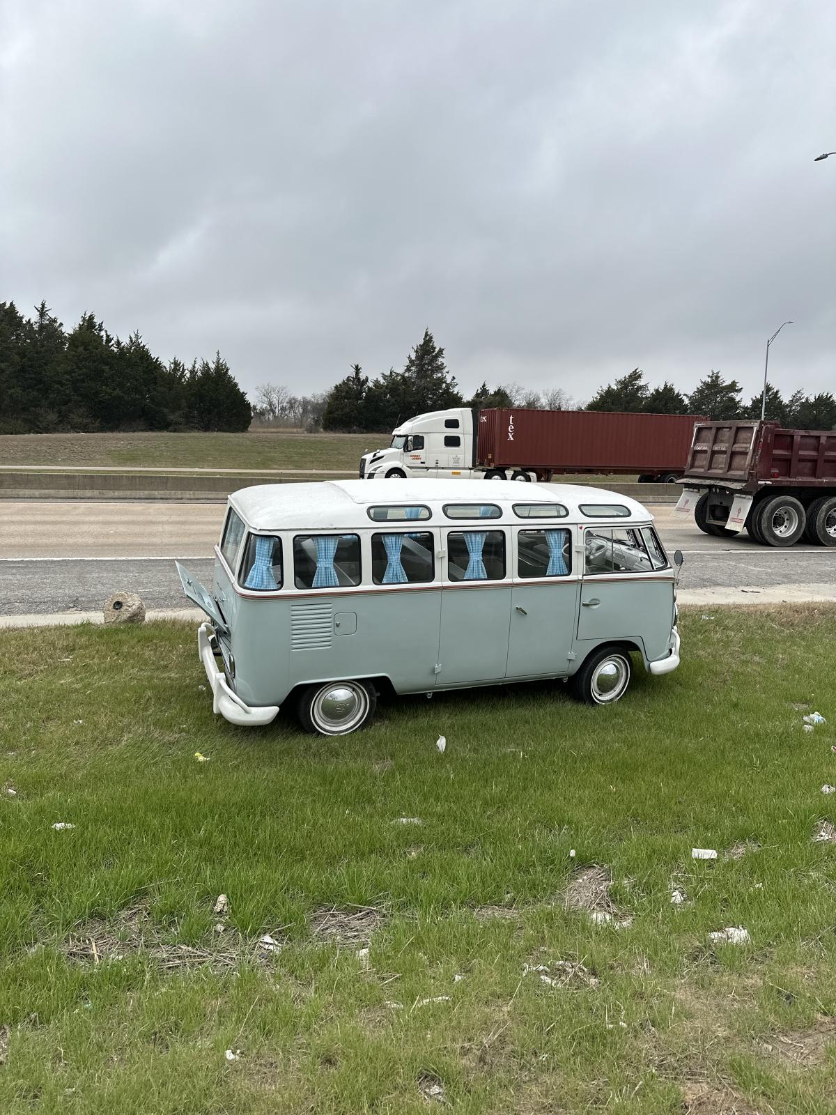

Hi All,
Looking to get an experts opinion.
I recently purchased a Brazilian bus from a company listed on these forums, and after about 100 miles of driving, the engine blew and I ended up throwing a rod.
The bus I purchased is a 1975 air-cooled 1500cc Brazilian Bus (restored). Upon delivery, I put 20w50 oil in it.
As I was driving back from getting the bus inspected in preparation for registeration/title application, I noticed a significant decrease in power and a loud knocking in the engine bay. I was on the highway and attempted to take the first exit, but before I got to the next exit, the bus came to a hault, a loud pop noise and a puff of white smoke shot out the rear.
After I had my bus towed home, I noticed a big hole in the block - a clear indication that I threw a rod.
So, my question is... where would you recommend me looking to get a new motor? I have a little experience working on my vintage land rovers, but not a ton.
You can see pictures attached.

Well it is a beautiful bus and it is worth a lot of money. Compared to a Bug, the bus is massive with bug engine.. As some of the guys said you need a larger engine and be aware of what it can push at highway speeds . The weight of the bus empty vs it loaded for a trip with people. Just another thing to think about.
