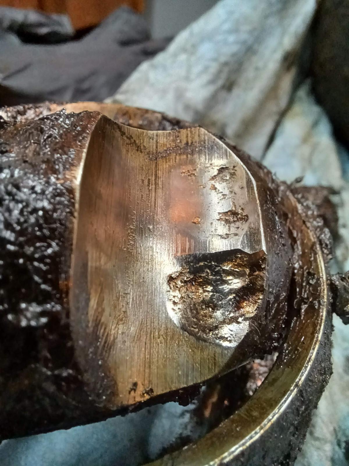

So I took apart the spare axle that came with my van. I will not have to worry about using this axle. Take a look at the first section I cleaned up.
I stopped right there. No need to see anything else.
I may take apart the axle on the van tomorrow and see what that looks like.

Yep, that is toast.
Just to be clear on terms. What you have in the pics is the Constant Velocity (CV) joint.
The axle is the metal shaft that the CVs slide onto.
Even if the CVs are toast keep the axle itself as a spare. You can put new Lobro CVs on it and you'll have a good easy to swap in part for the future.
Original axles are much better than the replacements available today it seems, they are machined better IMO.

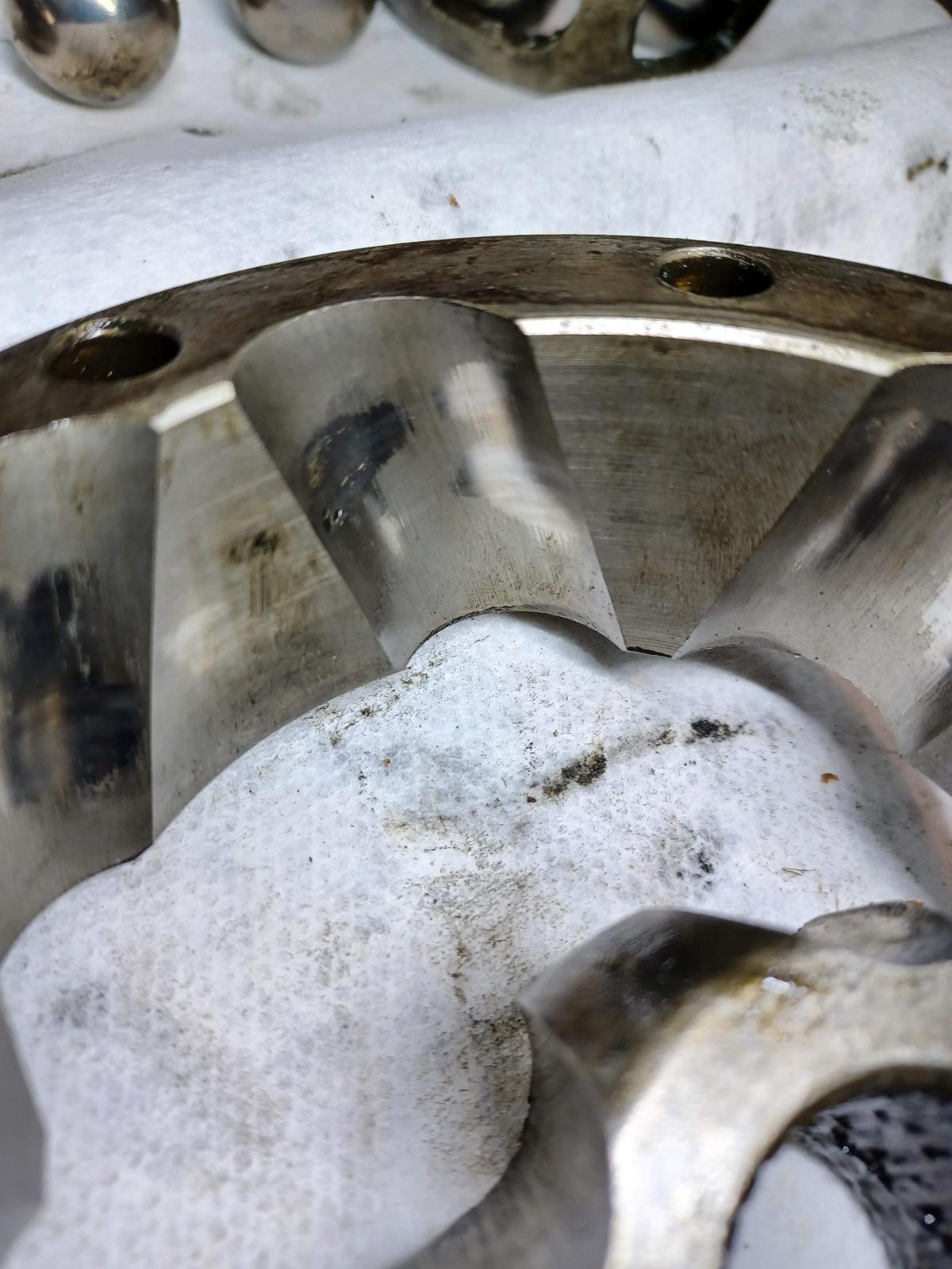

I took apart the axle (gonna keep calling it that dobryan Wink )that is on the passenger side of the van. Both boots were torn, and that was the side that I could hear klunking. One of the bolts on the wheel side was about to fall off, and another was only hand tight. Not a good sign.
Anyway, I disassembled the wheel side CV joint, and this is what I found.
Definitely worn, but not as bad as the spare I had. I also found, in the box of spare parts the PO gave me, a couple of CV boots in good, usable condition. I briefly thought about rebuilding the CV's, installing the good boots, and flipping the axle.
Then I said nah, I'm going to order new CV joints and do it once.

You got me thinking Dave. Maybe I should clean it up and flip it?
The balls don't look too bad. I have to see if I can figure out which way the tranny side was though. When I took it off the axle, I just didn't pay attention to which end is which.
The wheel side is still laid out like I remember.
I suppose it's not the end of the world if I mess it up and install it the way it was. It will just wear sooner?

It doesn't reverse the CV wear pattern to swap the ends of an axle.
You have to move the CVs or complete axle to the other side of the tranny.
Which CV goes to the tranny doesn't matter there either.
It isn't the direct of rotation of the CV joint that matters to the wear points.
It is the locations of internal contact forces due to the twisting of the axle by the tranny flange under engine load.

Looking over the inner CV joint parts, and I see wear on 2 areas in the groove where the balls sit. Does this mean the axles may have been flipped already?
Or is that just normal wear?
