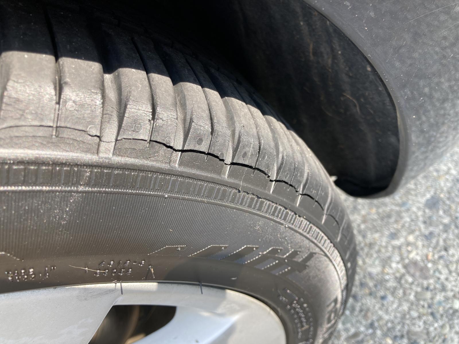

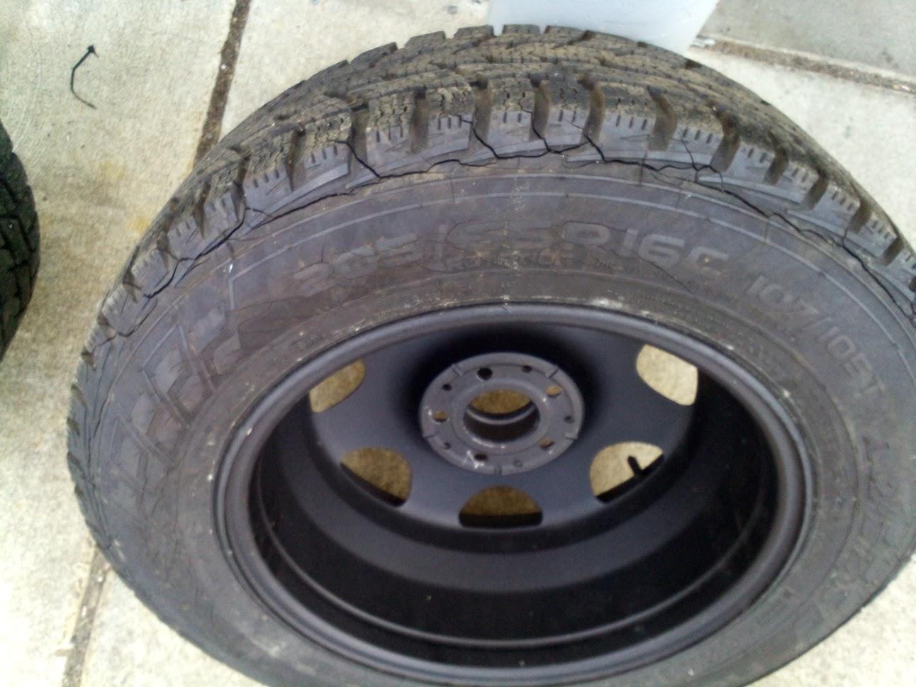

This is a callout on Nokian tires anyone who has them, please check them for safety.
I have a set of 5 ZERO MILE t205/65/R16 Nokian baller ass tires 106/107T load range mounted and.. well I thought they were supposed to be some awesome tire..
They were outside since Aug last year through the winter..
I never added air, the van was on 4 jackstands completely off the ground.
All five did this.
I grew up retredding tires and personally prepping vulcanizing new tred on.. I've never.. ever.. seen a tire do something like this, let alone all 5.
The peeps at Discount tire are totally warranty covering them.. but.. imagine what happened if I hit the road with these?
holy moly.
I chose them for the weight capacity, and the tred design, almost went to Rotiiva.. if I could find a blend between the two styles.. I would have bought it. Being as I had BFG ATKOs I dont like big block tred designs.. I lke the wet/winter siping built into the X patterns all over this sweet design.
Facts: they never rolled under the van, never supported the weight of the van..... freak odd issue.

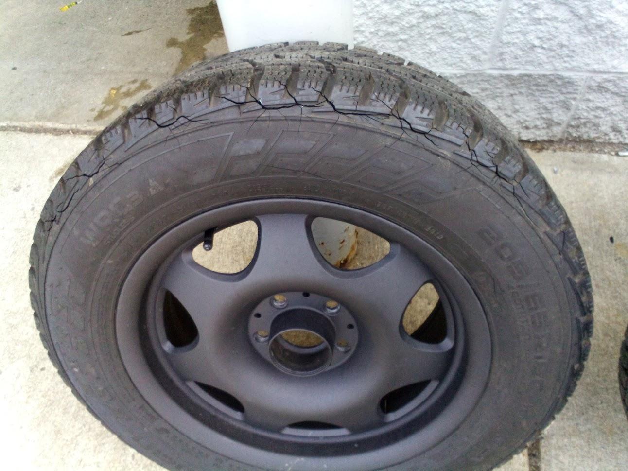

I love Nokian tires for their snow capabilities, including WRC3s. A few years back I bought three season Nokian Entyre 2.0s for the VW CC. They suffered a similar but less gruesome fate. Nokian gave me a credit and I bought WRG4s for the CC. Two years in and they've been great.
When the failure occurred in 2021 these tires were less than 4 years old and had over 60% of tread remaining:

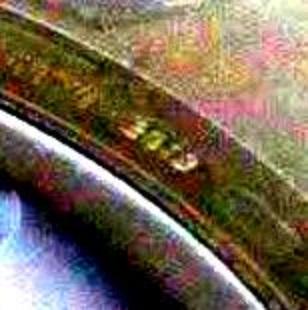

2017 date stamp:
I'm irrationally committed to Nokian because they work so well and studded Hakkapeliittas have made my plow truck nearly unstoppable.
Regardless, your point to keep a close eye on the condition of tire is well taken..

The code is 1819!
I'm hopeful to get a replacement set of these tires but.. am also weighing out goig to a alternative tire that is closer in load range 106/107.
