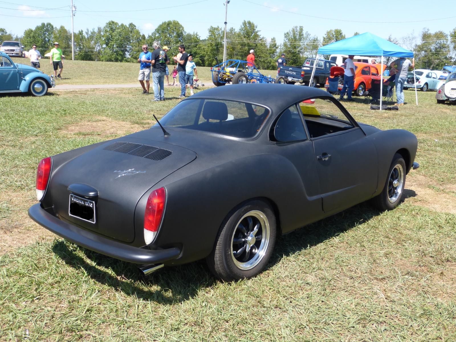

I put fiberglass bumpers on my '72 with handmade brackets and a rattle can semi-gloss paint job
Nice looking, but why bother with bumpers that will shatter before they absorb...anything? Do you think they'll actually do anything if something makes contact?
Perhaps I'm naive to think that the originals would really protect anything above maybe 5mph.
Just out of sheer, morbid curiosity...where did you find those?
Cheaper to replace than bent up $$$$$ stainless steel bumpers or $$$ re-chromed stock bumpers.
It was over 10 years ago but from the Samba Classifieds. He made them to order. Older style that goes back to the wheel opening, new style to fit inside the 'dimples' on the fenders, or to fit if I filled in the 'dimples'. Not sure if he is still there/here.
