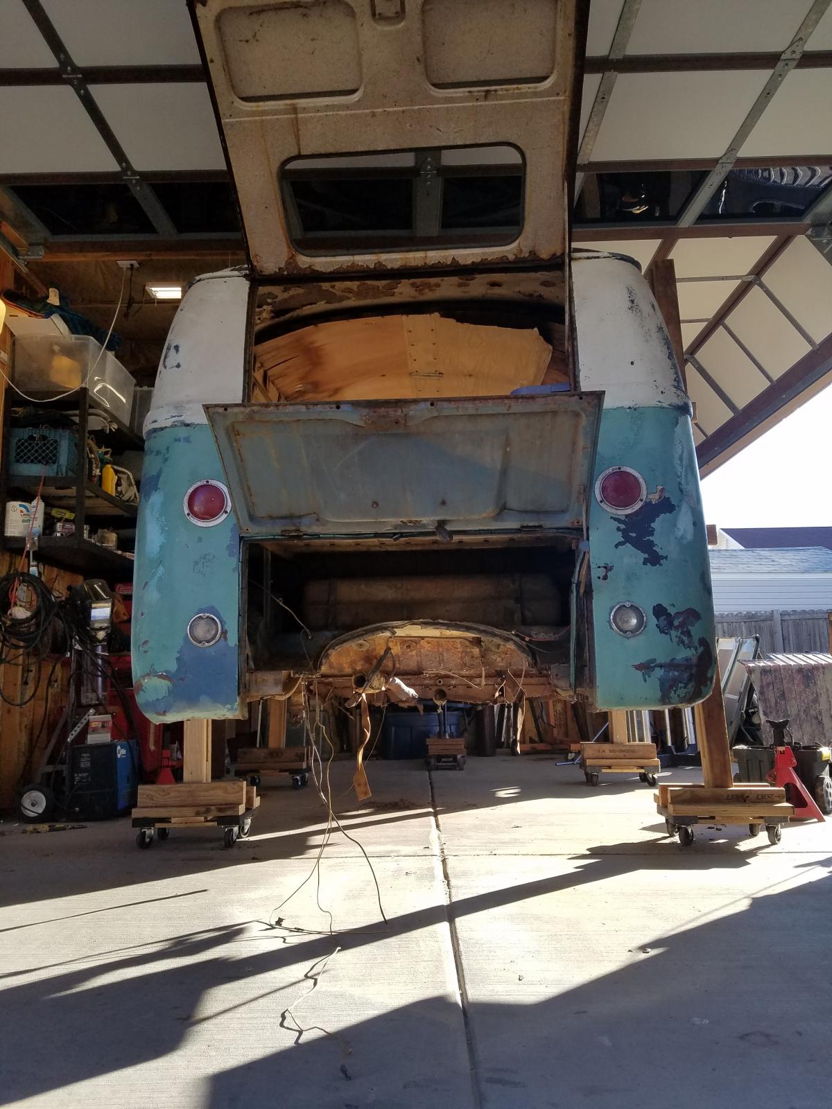

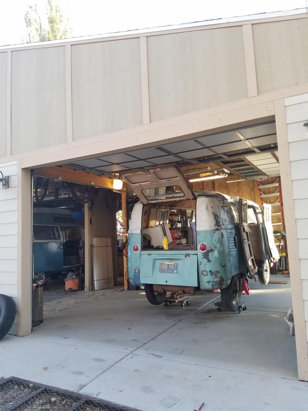

I haven't been able to get a real start on this yet.
Right when the donor syncro showed up, so did the snow.
Which is not necessarily a bad thing. It has been great for
Driving my other bus in.
Here is the meager start of the project. Should move a lot
Faster once work and snowfall slow down.
That's as far as I've gotten besides stripping the syncro down.
