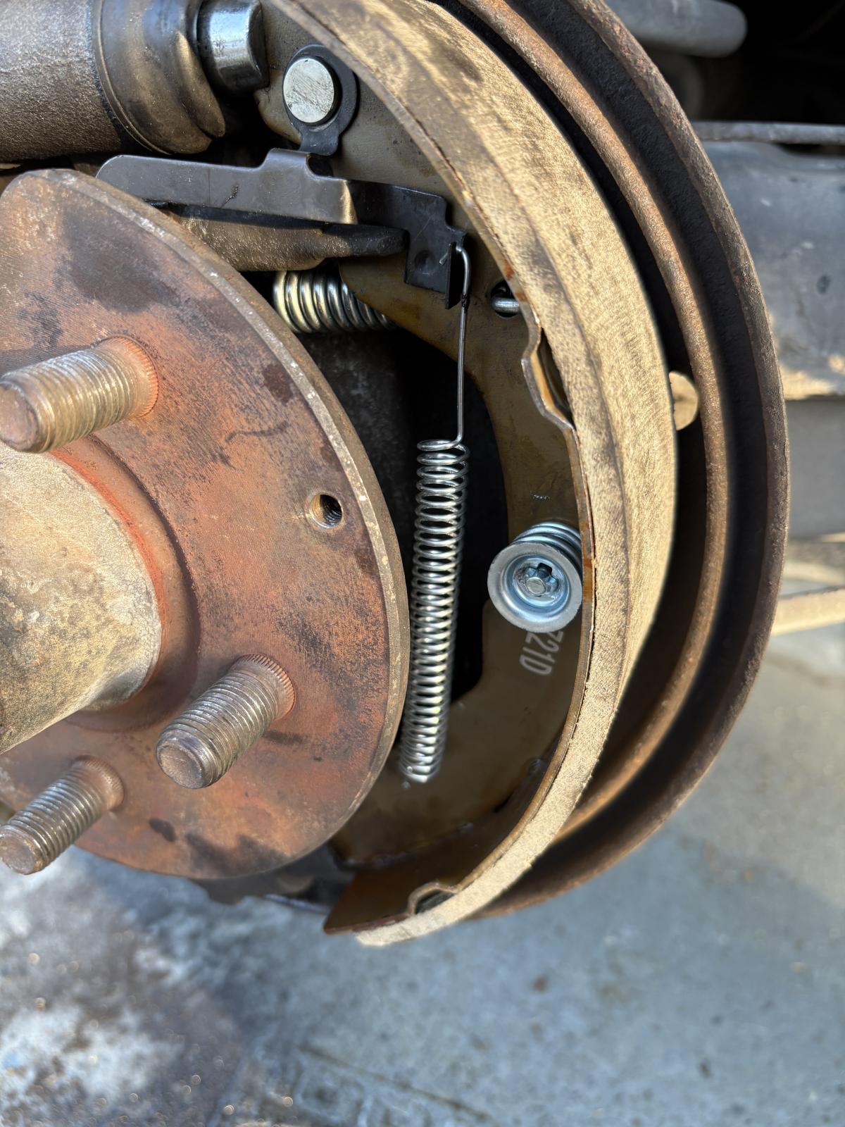

I am rebuilding my rear drum brakes and have a question about the orientation of the automatic adjusters. I currently have the skinny side out and the beveled side out. Is this correct?

Looking at photos, I am fairly certain that the skinny side, facing the rear of the van, of the adjuster faces out.
The end towards the front of the van is unclear. I have seen some photos with the bevel side out and some with it in. I'm not sure if its critical.

I found this video that goes into detail. I believe my current setup is wrong but at least I have only done one brake so far.

PostPosted: Fri May 16, 2025 10:41 am    Post subject: Re: Vanagon Drum Brake Adjusters Reply with quote
https://www.thesamba.com/vw/forum/viewtopic.php?t=790933
Pay very close attention to what Crazyvwvanman says and shows on page 1.
Print it out and put it in your bentley, page 46.6.

I was able to take my drum off again and fix this yesterday. Thanks.
