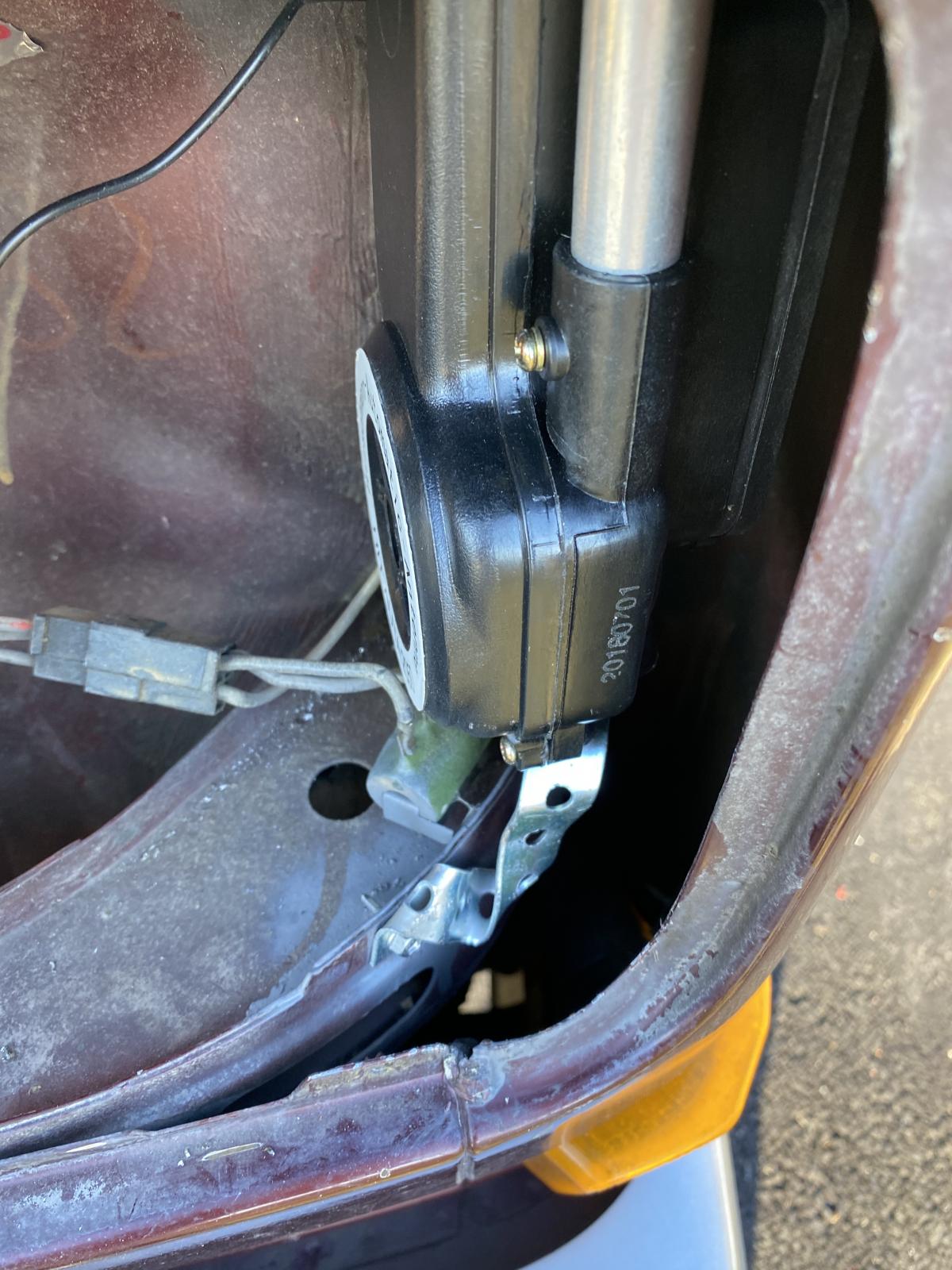

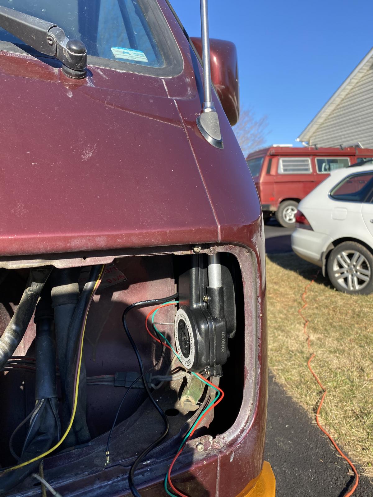

I just finished installing a power antenna on the euroBus and since I could not find an install topic I documented what I did.
I did see a facebook post where someone took some pics of their install but not really documented. But it gave me the basic knowledge to do this.

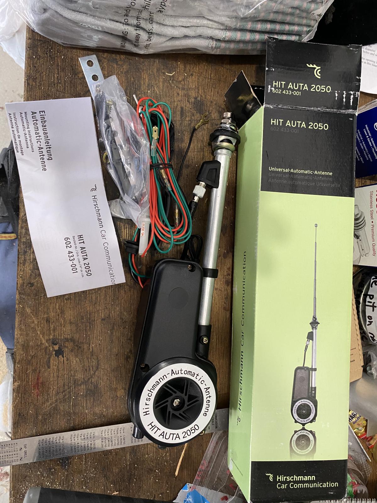

I used a Hirschmann HIT AUTA 2050 power antenna for Mercedes.
https://www.ebay.com/p/1222989461
The installation was actually very easy in general. It took about one hour or so this afternoon.

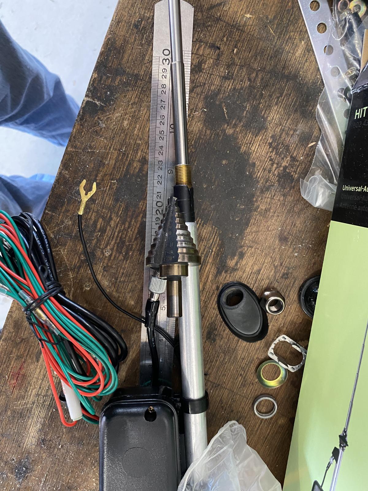

Remove the existing antenna. Unscrew the nut on top of the antenna fairing at the base of the antenna mast. Remove the front grill and drivers headlight assembly. Pull the antenna downward. (If you want you could tie a piece of string or something to the other end of the antenna lead at the radio so you maybe could pull the new antenna lead along but I had the instrument cluster off already and it is easy to route the new antenna lead with the cluster off.)
On the power antenna remove the fairing assembly completely. You will reuse the stock VW antenna faring you removed and the new nut from the power antenna.

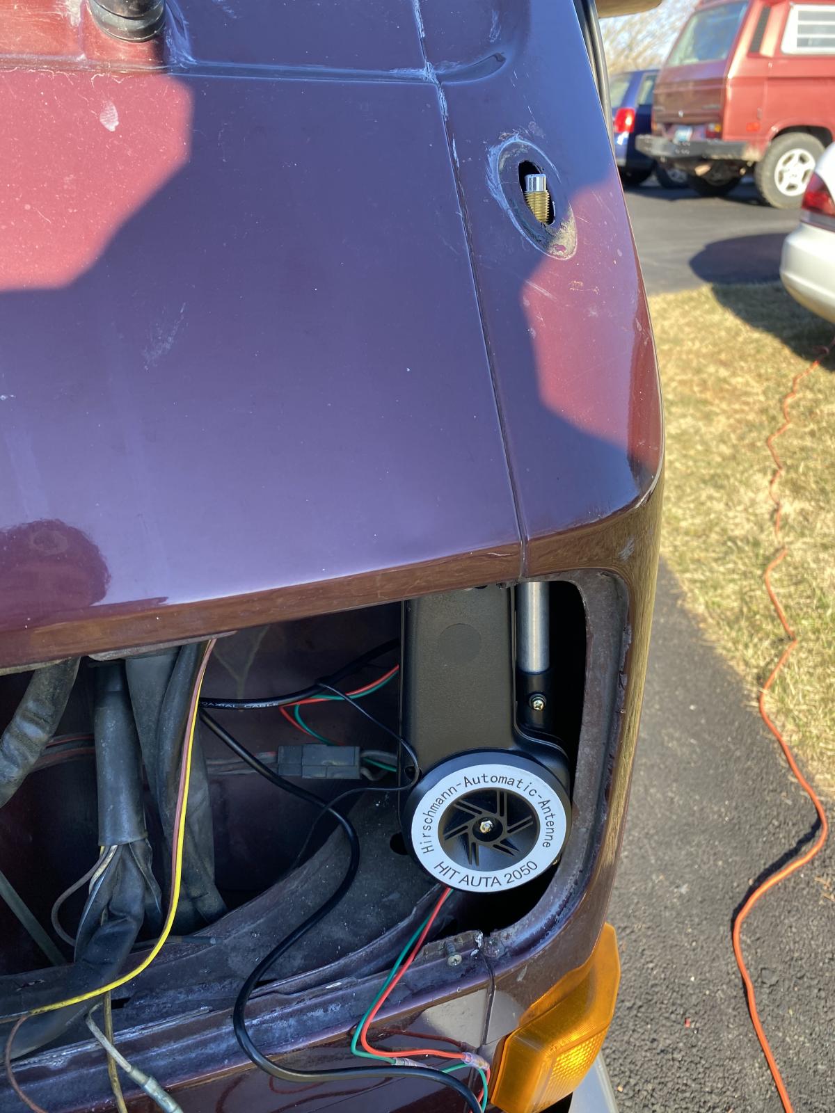

Now it is time to open up the hole in the body interior so the power antenna will pass thru. Use a 1 3/8" step bit on a right angle drill and clean up the edges with a rat tail file and the new antenna will just fit thru.
Insert the new antenna assembly in from the bottom until the antenna base comes out the stock hole on top.
Now use a battery to raise the antenna. Black to ground and both the green and red leads to positive will raise the antenna (just the red lead to pos and black to ground will lower it).
Slide on the original fairing and the new nut and hand tighten.
Now align the antenna base unit so that the antenna is vertical and the base is turned to be parallel with the side body panel as shown. You need to get it out of the way of the headlight bucket. It should be just barely clear of the big resistor under it.
Get creative and fashion a bracket for the base of the antenna unit. The kit has the material to use.
Do a dry fit of the headlight bucket and realize that your bracket is in the way and use a common blunt force tool to persuade the bracket out of the way. You can do a better bracket than that mess.
Ground the black wire on the body.
Feed the antenna lead and two power wires up thru the 1 3/8" hole into the space behind the instrument cluster and route them to the radio.
Insert pipe insulation material in the annular area to keep critters out.
Pull off the nut and fairing and repaint the fairing matte black, add some silicon to the base, and reinstall and tighten the nut gently.
You should be done!
(What really makes this work so well is the use of the original fairing piece as the power antenna hardware is not made for the steep angle of the Vanagon front end.)
