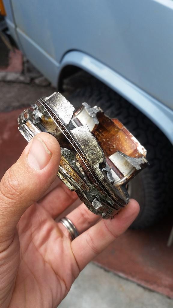

they are not exactly sure why it blew up... maybe they say an issue with the dipstick that read wrong...
One of the pistons
