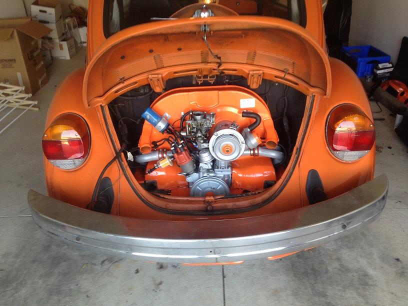

I am the guy that makes brand new, german style thermostats. I spent 2 years doing research, then 2 years making rebuilts, before going 100% new in 2012. I sell all the temp ranges, 75-80 for the 36hp, 65-70 for the carb bug, 80-85 for the FI bug, 85-90 for the type IV, and even 23-34 for the porsche 356. Folks are always asking me questions like "my oil temp is 180F, are my flaps open?" I drove 6 miles to the store, are my flaps open? Its cold here, are my flaps open" etc,,, All I could tell folks was that if you have a 65-70C stat, it will begin to open when it gets to that temperature range. I really wanted to completely understand how these things work in the real world. So I build a setup to measure it. I am using my dad's 74 bug as a baseline, it is almost totally stock. when he got it, it was missing the flaps (of course) the hoover bit (of course) and even the lower cylinder head tins and cylinder head deflector plates. I added all those back and powdercoated it orange and silver. It is a 1600 dual port, the only non-stock parts are aftermarket muffler, bosche 009 with pertronix ignitor, someone cut the pre-heat tubes off the intake manifold, and you can see a mount by the carb for an exhaust gas recirculation solenoid that someone took off.

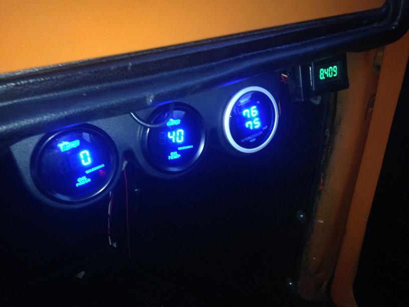

I decided i needed to measure a few things, so i added some gauges.
going L to R, i have oil pressure, oil temp C, the 3rd gauges is an intercooler air temp gauge, but the top is measuring the engine compartment temp, the bottom measure the hot air that is blowing over the thermostat, the readings are in deg F
the last gauge is a high accuracy voltmeter. I use this to measure the actual postiion of the thermostat in operation. It took me 4 prototypes over several years to develop, with many missteps in the process.

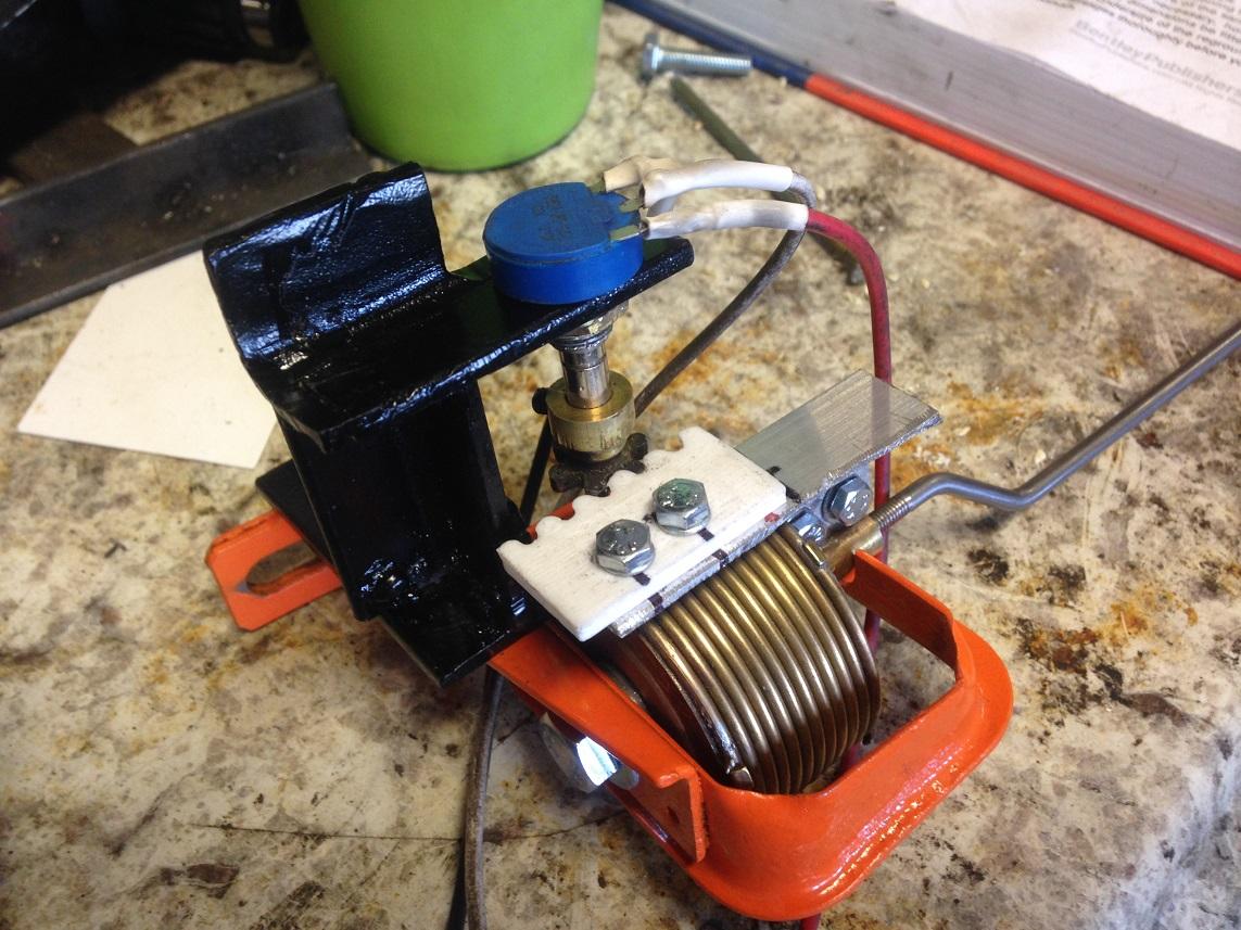

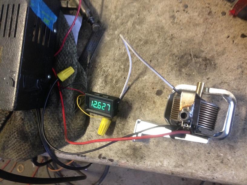

prototype 1 uses a radial potentometer, with a curved gear welded to the passenger side flap, this gear turns a small gear on the pot, alignment was a total pain, i just could not get it right, no matter how many times i welded, rewelded and beat on it, the gear would not stay lined up 100% of the time, so would either miss teeth or bind up - but it does look really cool!
protoype 2 is the same pot with gear, but mounted to a rack at the stat itself, now when the stat expands, it can wiggle a little bit - alignment issues again,

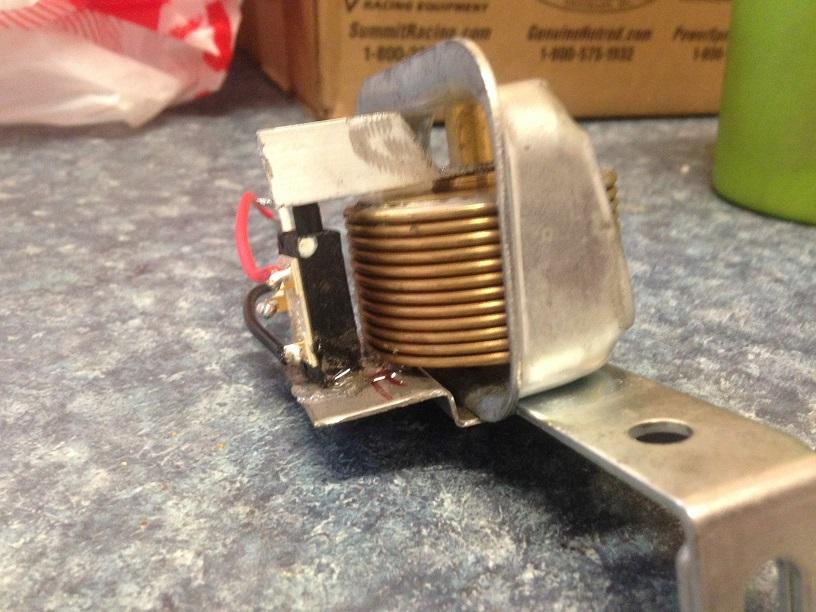

prototype 3, I switched to a linear resistor, this is a switch like you might see mounted in a graphic equalizer (do you remember those?) , this actually worked, but the switch is not made for high temps and it melted
Prototype 4, is an actual industrial linear potentiometer, 13mm stroke, rated for 300F, i finally got something that works

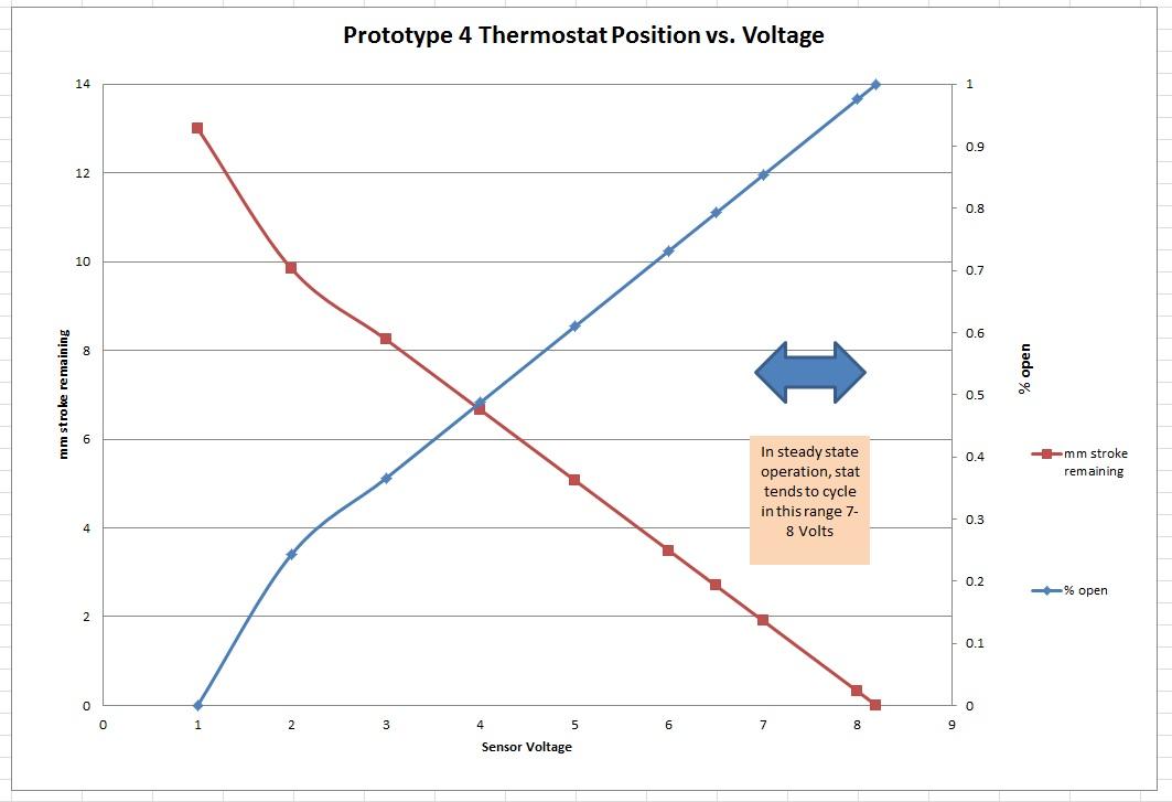

So i started taking short trips 5-10 miles, to see what happens, I record the readings every mile for short trips.
Findings, the thermostat starts to crack open within a few minutes of getting going. Well below the 65C temp rating.

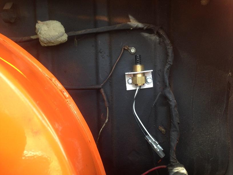

I was shocked at how hot the air in the engine compartment is. The sensor is mounted on the back wall, only a few inches from the fan inlet, so surely this is the air that is used to cool the engine.
Started from ambient temps, which for me now are running 70-85F (22-30C), the air in the engine compartment rapidly increases. The highest temp i have seen so far is 66C -151F, the overall average for all my driving so far is 46C=115F, not exactly cool air for the engine at all.
As far as how hot is the air the stat is seeing, well obviously it must get to at least 65C, or the stat would not work.
It really only takes a few minutes to get to that temp, I had to take longer trips to get it to get to steady state condition, but based on my limited data so far, it looks like a 65-70C stat holds the heated air from the engine in the 100C range - 212F. This does not seem like an unreasonable number to me.
this i think is important to understand - steady state operation
I finally drove 50 miles to work, and 50 miles home, I did all back country roads, trying to stay around 50 mph, i did have a few stop signs and lights and some 35 mph in town driving, but tried to be consistant. When the engine gets to steady state, the stat cycles between 85% & 95% open, rarely have i seen it going full open for more than a minute or two. This chart shows sensor voltage (bottom) vs mm of stat displacement (left) vs stat % open (right), the stat spends most of its time constantly openign and closing small amounts to keep the engine temp constant. Think about it, that makes sense, it should do that.
I have been waiting years to do this last test, again on this drive to and from work, gong to work, i kept everything normal, but coming home, i tried the "tennis ball trick" - you know, folks put a tennis ball between the decklid and the latch to open the decklid slightly to get more cooling air in. Well,,, IT WORKS! This chart compared miles driven (bottom) with deg C (left) with stat voltage (right). This stat readings are dashed lines, note that they are almost identical, the stat pops open within 10 miles, then slowly closes and starts to cycle open and closed slightly. You can see that engine compartment air temp is like 35C - 95F LOWER with the tennis ball, stat temp lags behind about 10C - 50F with the tennis ball, and oil temp lags behind with the tennis ball but looks to be coming together if i drove farther.
I think that is some pretty amazing stuff to learn.

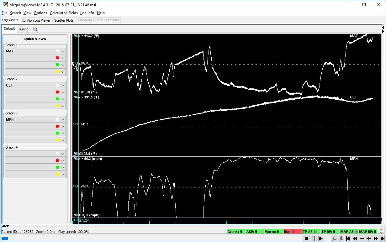

I can add some type-3 configuration data. I am running a Megasquirt EFI system so I have lots of data logging available.
I also have a sensor located on the right sled right behind the thermostat. I am using it as my CLT to adjust enrichment, sort of a choke function for efi. The temp sensors I use look to be the same open-element ones you are using.
I do not have anything to measure air temp going into the cooling system, but it's a type-3 so I would expect it to be close to ambient.
My Intake Air Temp is placed in the type-3 TB.
This particular log was taken in 2016 with ambient temp ~90ºF. Total time was around 20 minutes with the air temp down by the thermostat topping out around 190ºF. I have some longer logs that more clearly show regulation of the temp in that airstream.

Take another look at the plot I posted. The top trace is MAT (really the air inside the TB). The bottom trace is MPH. Notice what happens to the MAT when that car is not moving? That my friend is the air cleaner and the TB getting hot. When this engine was carbed the fuel would just boil in the bowls.
