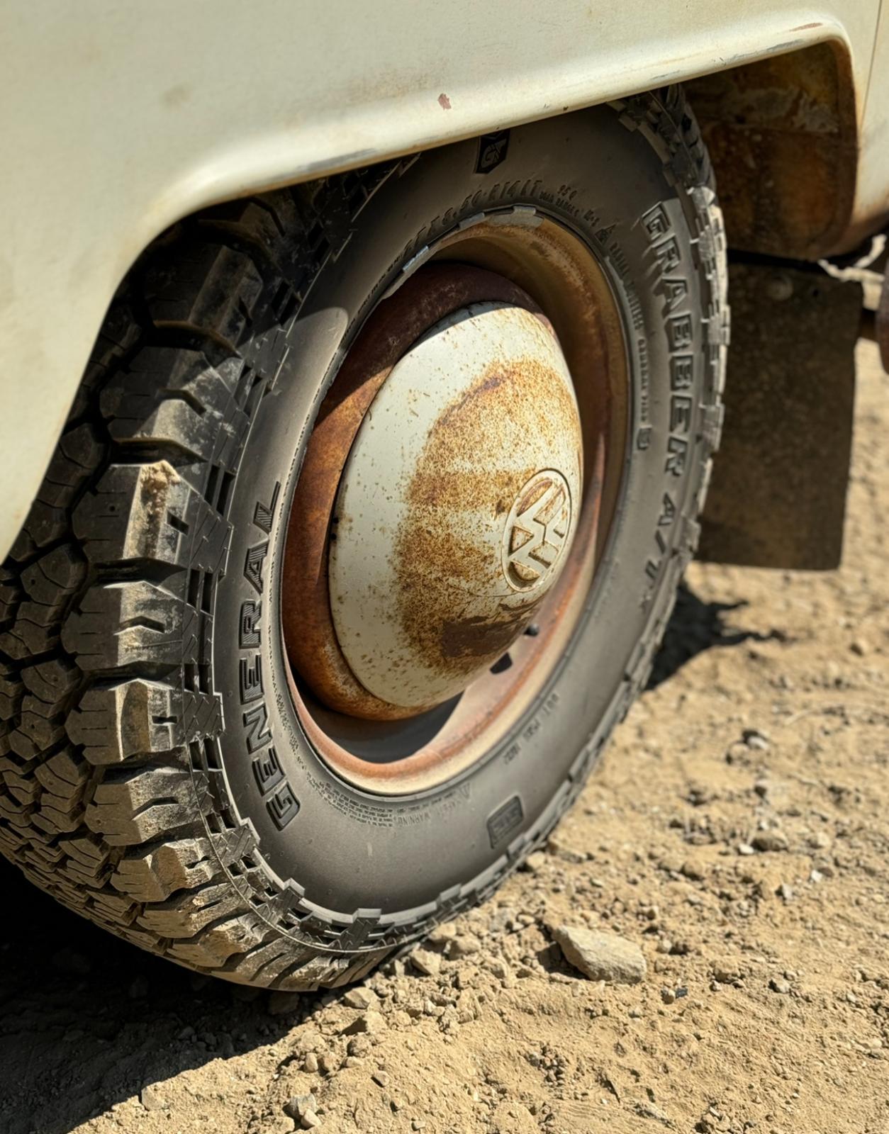

PostPosted: Fri Jun 28, 2024 4:51 am    Post subject: Re: Large tire/big meats - Stock suspension Bus thread Reply with quote
stock suspension
grabbers 27x8.5x14

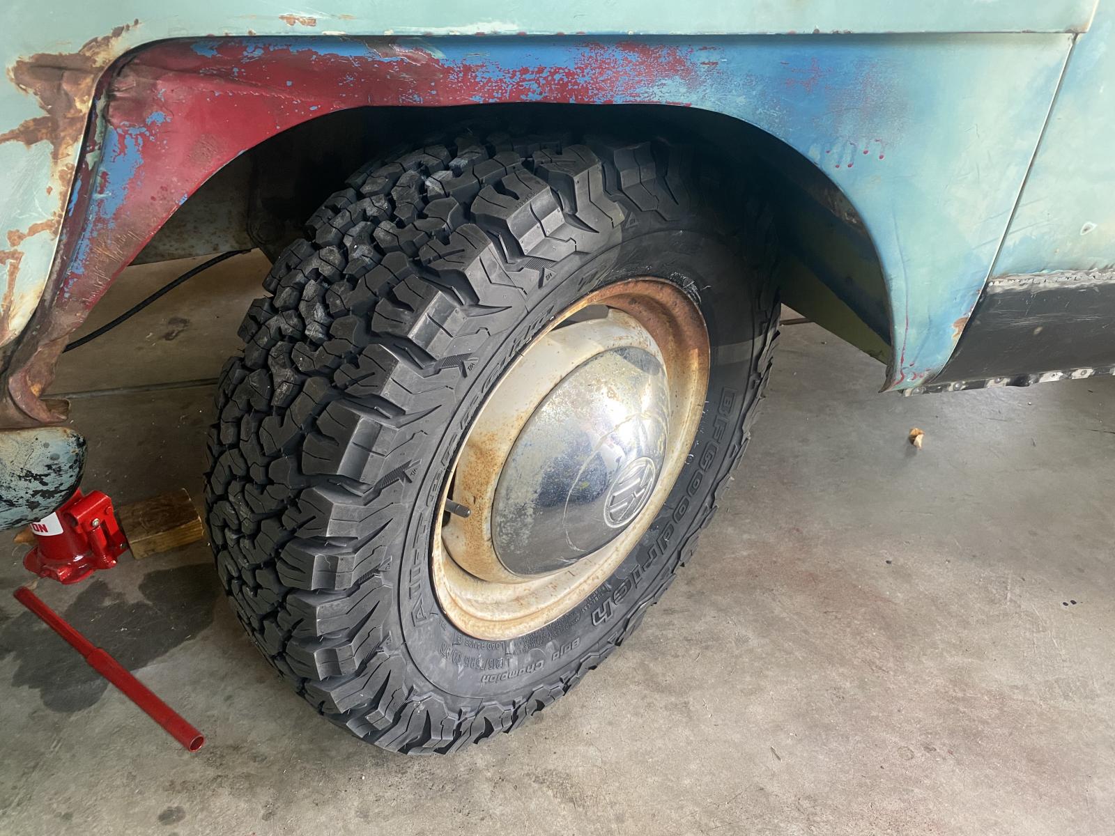

PostPosted: Sun Sep 22, 2024 3:52 pm    Post subject: Re: Large tire/big meats - Stock suspension Bus thread Reply with quote
Been waiting for my Grabber ATX 205 75 15’s for 2 months. Apparently a nationwide back order situation with no ship date in sight. Looking at other options now.
Primary contender is the BFG AT KO2, but closest size is a 215 75 15. Bus is currently running some very old Kumhos in that 215 75 15 size and they fit well with no rubbing or fitment issues. Should be safe to assume the BFG in the same size should fit the same, yes?
Bus is a stock height 1960 Kombi running stock 15” wheels with a small nut trans/RGB’s.
Anyone out there running these BFGs on an early Bus/small nut?
Thanks!
‘60 Kombi, The “Bob Dowell Van”
EJZero1
Joined: June 12, 2004
Posts: 184
Location: Colorado Springs
EJZero1 is offline
PostPosted: Wed Oct 09, 2024 7:00 pm    Post subject: Re: Large tire/big meats - Stock suspension Bus thread Reply with quote
Closing the loop for archival purposes.
The BF Goodrich T/A KO2’s in 215 75 15 wii indeed fit on a 1960 Kombi with a stock small nut tranny/RGB’s.
Excellent ride with remarkable improvement over the old Kum Ho’s (same size) that I replaced.

PostPosted: Wed Oct 09, 2024 7:04 pm    Post subject: Re: Large tire/big meats - Stock suspension Bus thread Reply with quote
Curious, what was improved over the Kum Ho's? Noise, handling, tread wear, traction, all of the above?
EJZero1
Posts: 184
EJZero1 is offline
PostPosted: Wed Oct 09, 2024 7:25 pm    Post subject: Re: Large tire/big meats - Stock suspension Bus thread Reply with quote
Kum Ho’s were old and run out, and not LT rated. Only driven these new BFG’s for a short drive, but handling feels much more sure footed. No noticeable increase in noise, but my Kombi is an empty tin can right now, so quite noisy in its own right.
Time will tell ref tread wear and traction. Wanted a tire that I would be confident in taking on dispersed camping trips. Initial impression is that these should fit the bill very nicely.
