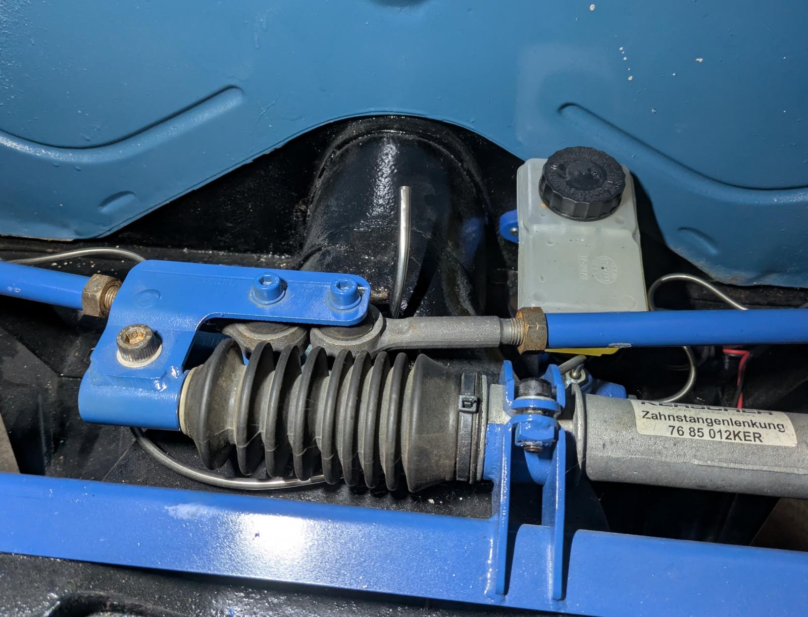

PostPosted: Wed May 21, 2025 1:49 pm    Post subject: Re: 1966 Ghia coupe restoration Reply with quote
I was getting ready to install the gas tank, and had the thought I should first check the tunnel fuel line. I hit it with compressed air and to my massive dismay nothing came out the other end. I'm kicking myself for not thinking to check this while I had the body off. I don't know how I completely overlooked this. But I picked up 25' of stainless 1/4" tubing and am going to have to replace the tunnel fuel line with the body on. I've read a bunch of threads on it, and have a good idea how to approach it. Wish me luck, cuz I'm gonna need it.

PostPosted: Wed May 21, 2025 4:44 pm    Post subject: Re: 1966 Ghia coupe restoration Reply with quote
I can understand how realizing the situation must have been quite disappointing but we've seen your skills and I suspect you will get though this successfully. Look forward to reading about it.
Your wheels look good and I have to say again that your paint is a near perfect match to one year only L50F Regatta Blue. Looks amazing.

Thanks, I appreciate that! Thought I was about to be on the goal line only to get an offsides penalty Laughing
I'll be posting pics of the fuel line replacement for sure.

PostPosted: Thu May 22, 2025 1:51 pm    Post subject: Re: 1966 Ghia coupe restoration Reply with quote
That is really frustrating! Any use trying to clear it with a piece of welding wire or something similar? If you can dislodge whatever is in there it might then blow out with compressed air and then you could flush it repeatedly.
I have installed a new fuel line through the tunnel on my Beetle years ago with the body on. I gave up when it got to trying to get it down the framehorn and so at the back I started the flexible hose next to the gearshift coupler and out next to the clutch cable conduit. It has been like that for 25 + years, with regular changes of the flexible hose. But I was young and impatient - I suspect if you do install the new one you will manage better!

PostPosted: Fri May 23, 2025 4:49 am    Post subject: Re: 1966 Ghia coupe restoration Reply with quote
I had considered trying to unclog it. I was successful in unclogging one of the heater cable tubes that had some solidified gunk in it. But my concern is what if in trying to unclog it, I unwittingly breach it - something I won't know until fuel leaks everywhere. It's 59 year old tubing, may as well replace it.
Here's my plan that I picked up from a post in the Beetle forum. Run the tubing in straight from the front through the inspection port between the front beams until I can see it at the rear inspection hatch where the shift coupler is. Then run weed whacker line in through the frame horn until I see it in the rear inspection hatch. Duct tape the weed whacker line to the tubing and use it to guide/pull the tubing down and out of the frame horn. From there it's a matter of cutting the front of the tubing and continuing to pull it through until I can guide it up through its exit at the front of the tunnel. Once it's out both ends, trim the ends with a tubing cutter, and use metal zip ties to secure it in place in the tunnel.

Ok, I finally got my hard fuel line replaced. I'm going to preface this by saying, if your Ghia needs its hard fuel line replaced, do yourself a favor and just send it to the crusher. I'm kidding of course, but only just. This was by far one of the worst jobs I've ever had to do on any car I've ever owned. You're pushing a metal line through a tunnel full of obstacles that you can't see, and you have to feed it around a bend and then maneuver it out of a very small hole through which grabbing it is frustratingly difficult.
This took me something like 15 hrs over the course of several days. But with the amount of swearing, yelling, and sweating that I did...it felt like 2 or 3 times that.
First I cut the ends off the old fuel line and pushed the stubs into the tunnel and out of the way, leaving it mostly in place in the tunnel.
I used stainless 1/4" fuel line and sheathed it in 5mm braided fuel hose for protection. This I fed in through the front of the tunnel.
From the rear I fed string trimmer line in, which I grabbed from the inspection port where the shift coupler is under the rear seat. I had to disconnect the shift rod and remove the coupler to make room to get my hands in there.
I had intended to really document this in detail, but once the difficulty became apparent, any desire to do that went out the window.
So basically what I did was to feed the line in from the front until it got to the inspection port at the rear. That alone took several hours of pulling the line out and then back in, avoiding obstacles while trying to keep the line straight. Once I eventually had the line back at the inspection port, I duct taped the trimmer line to the end of the fuel line.
Then it took a ton of work pulling the line back and forth over and over and over and over, shaping it using extra long needle nose pliers through the port under the rear seat, using guess and test to find the right sequence of bends that would allow it to travel down the frame horn and out of the hole. This is what took many hours over several days. Not just shaping the line from a distance with surrogate metal appendages (the needle nose pliers), but shaping it so that the end had a bend that could be pulled from the frame horn without the whole thing getting caught on the ebrake and old fuel line.
After what seemed like an eternity I managed to get it out once I finally got it into the correct position, then using the trimmer line to lift and needle nose pliers to slowly pull it out (this was insanely difficult with the stiffness of the stainless line). Once I had enough length out of the rear, I cut the extra off the front, ran the line further in from the front, and then worked the front end of the line up through the hole in the front of the tunnel.
I still need to secure it. I have both metal and plastic zip ties for this, and I'm going to do my best to secure it to the old line through all the available openings in the tunnel using extra long pliers as forceps to tighten the zips. But the job is now 95% done. What an absolute nightmare of a job that I wouldn't wish on anyone. Seriously, I hope none of ya'll ever have to do this.
Here is the shiny new line sticking out of both ends of the tunnel.
