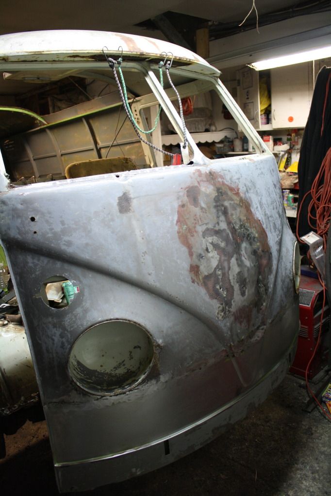

I got a little bit of work on the nose skin done... it's still in need of a whole lot more work
Filled in all the cracks caused by the front mounted spare
Started tearing out the rotten metal below the windshields

Got the lower nose panel all welded up
It very well could have used a complete nose skin, but finding one would be impossible, so we made due with what we've got

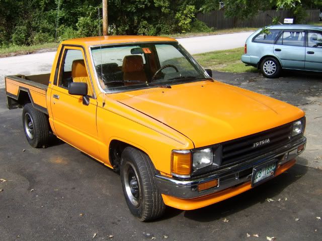

During our visit to the junk yard, I (unfortunately) ran into an old friend. My old '88 pickup. My first vehicle, and first car my father and I rebuilt together.
Here she is just a couple years ago when I sold her
The new owner must have really thrashed on her... that freshly rebuilt 22r could have gone another 315,000 miles. but I digress...

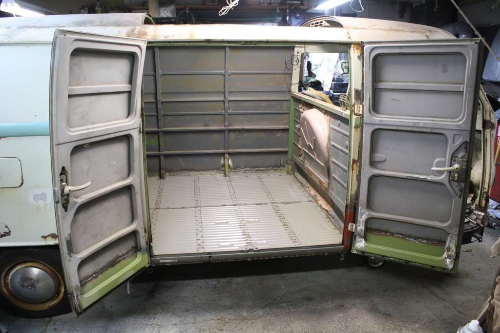

It's been a while since I've given any updates on the panel, but it has been moving along! We got it back in the garage after I finished my '69 that was in dire need of rust repairs. Check it out here
Got the floors all welded in, and the cargo doors repaired with some new metal. for whatever reason, the repair panels for the doors fit like shit, and needed a whole lot of work to get them to work right and the strikers to line up
There's still a few pinholes to fill in the skin, but they close nicely

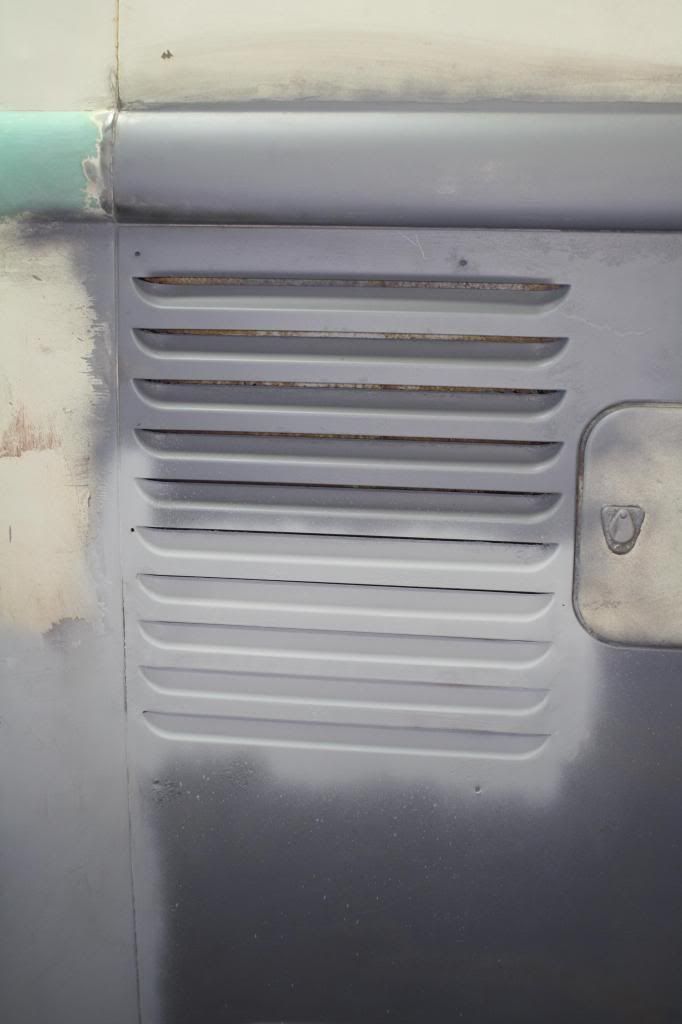

You may recall one of the many parts hacked out by the previous owner was a few of the louvers for the engine compartment. On the driver's side there was an oil cooler mounted, and on the passenger side... well, I guess it was just for continuity, lol.
Here's what the driver's side looks like, and what the passenger side used to look like. Luckily they were only cut on the sides, and not in the middle of the louvers.
I got a vent section off the classified for a few bucks and cut out what i needed.
Lined everything up, welded it in place, ground it smooth, and threw some primer over it all
Still need to fill those 1/8" holes left over from those rad side scoops. I'm going to wait to do the ones on the other side because the gap will serve as a nice access hole to fix the rot on the wheel well.

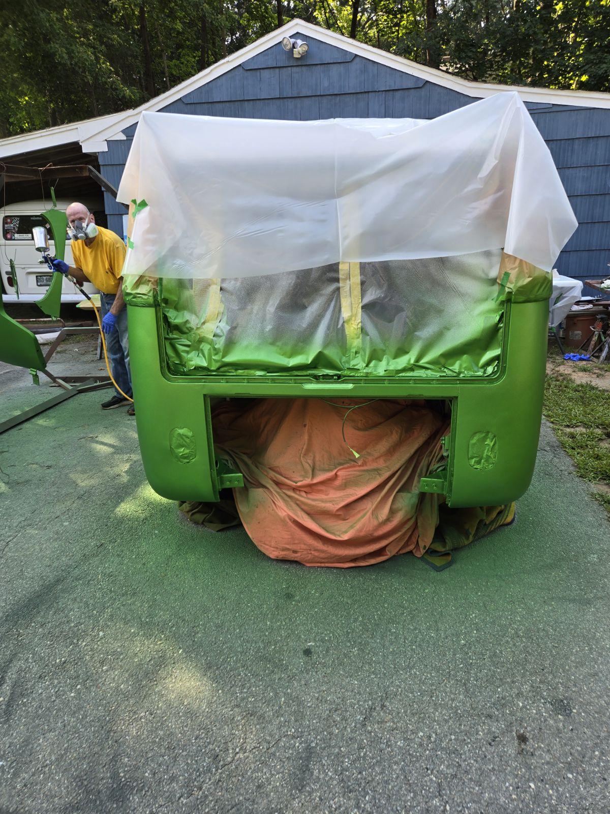

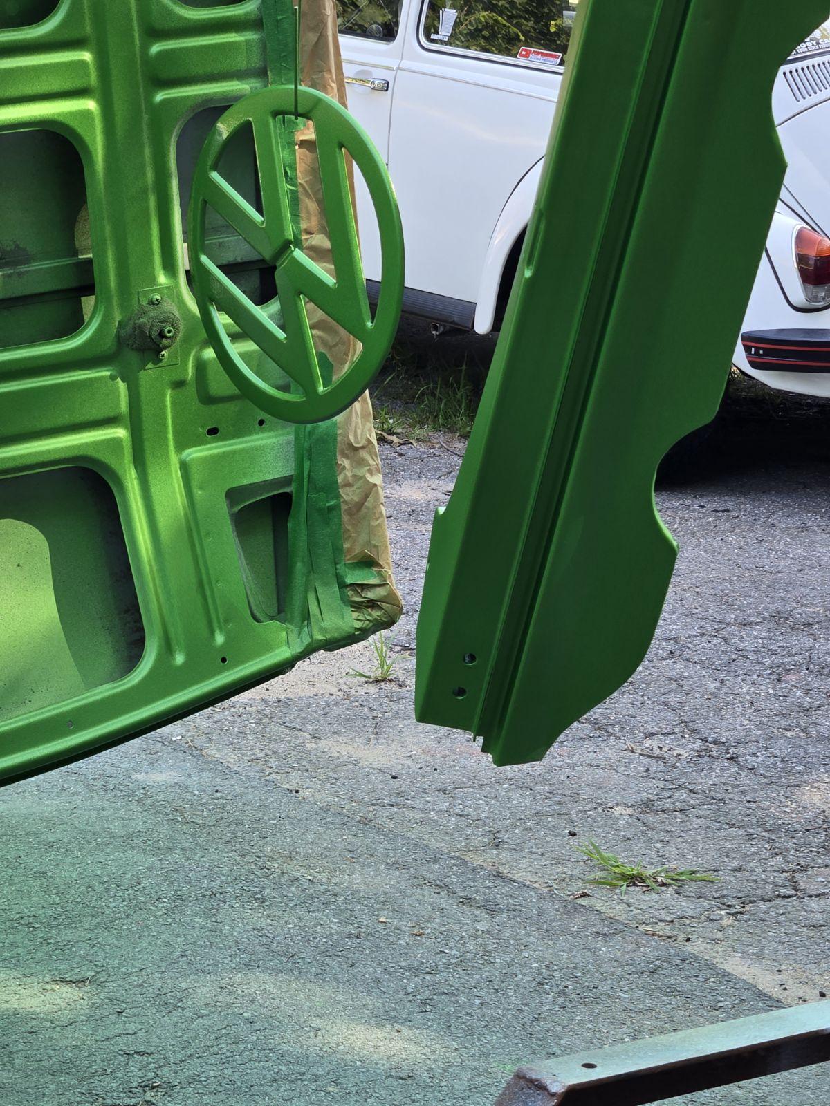

Hey folks, it's been quite a while since I last updated this post. There were some health issues that slowed progress, but my father has been chipping away at The '66 Panel over the past decade. He completed the IRS conversion. The most time was spent on sanding & bodywork. We painted it last summer, and it's all finally coming together.
Here's some shots from paint:
Here is the drivers seat my dad reupholstered himself:

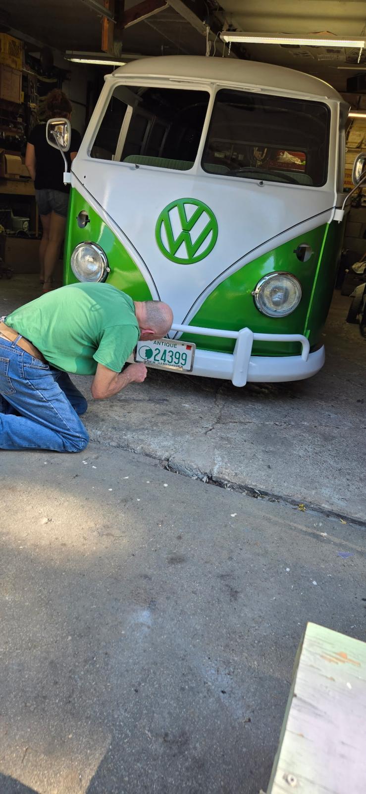

After paint, my dad wasted no time getting everything bolted back on!
She runs and drives, and the new paintjob came out nice!
Still a few loose ends to tie up. Windows need to be rebuilt, and we're still looking for a rear bumper.
