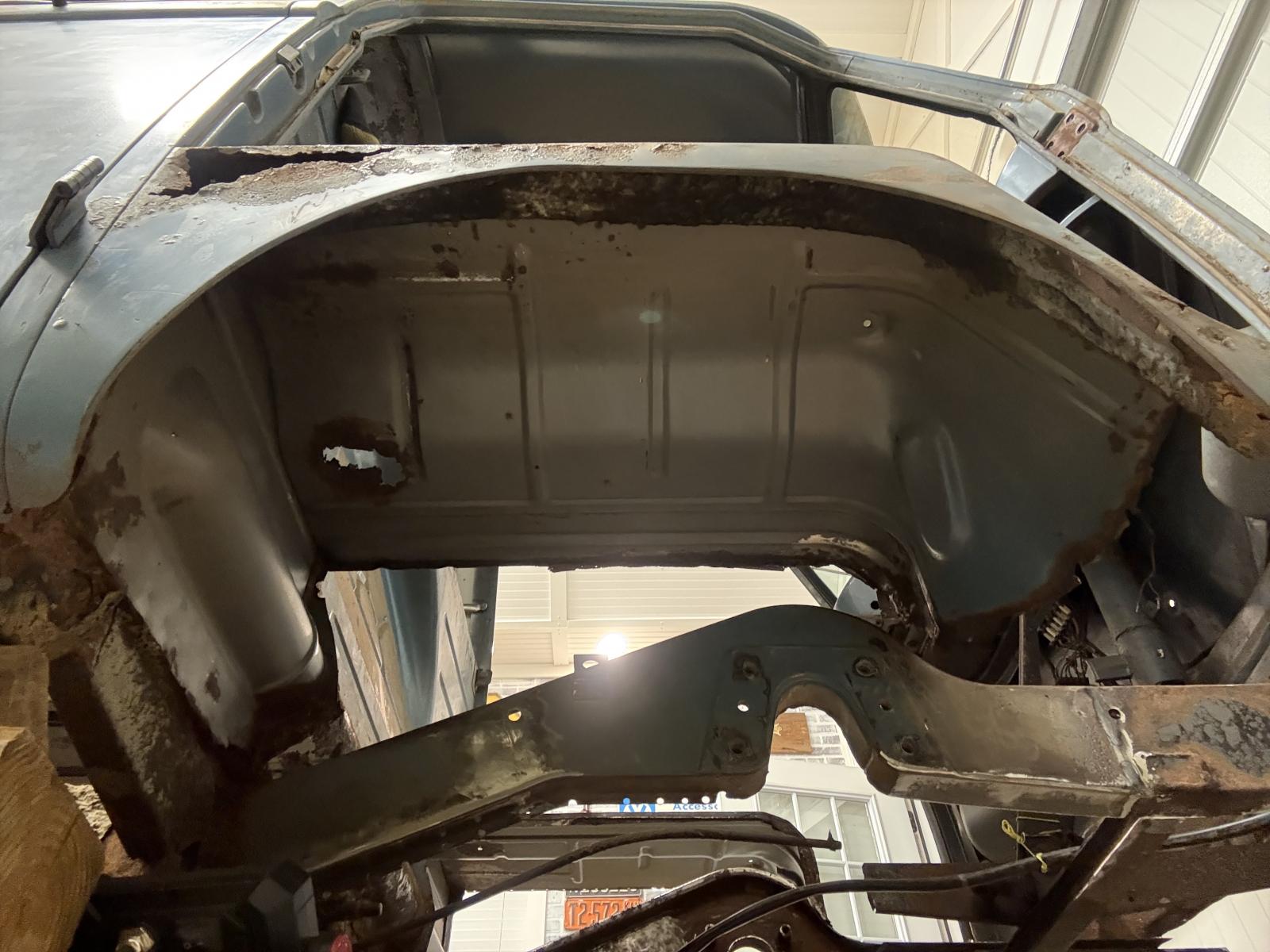

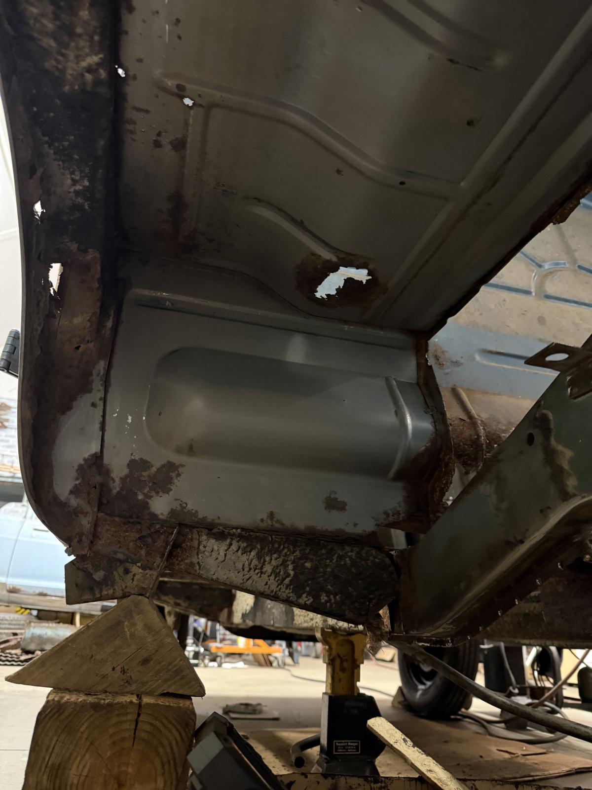

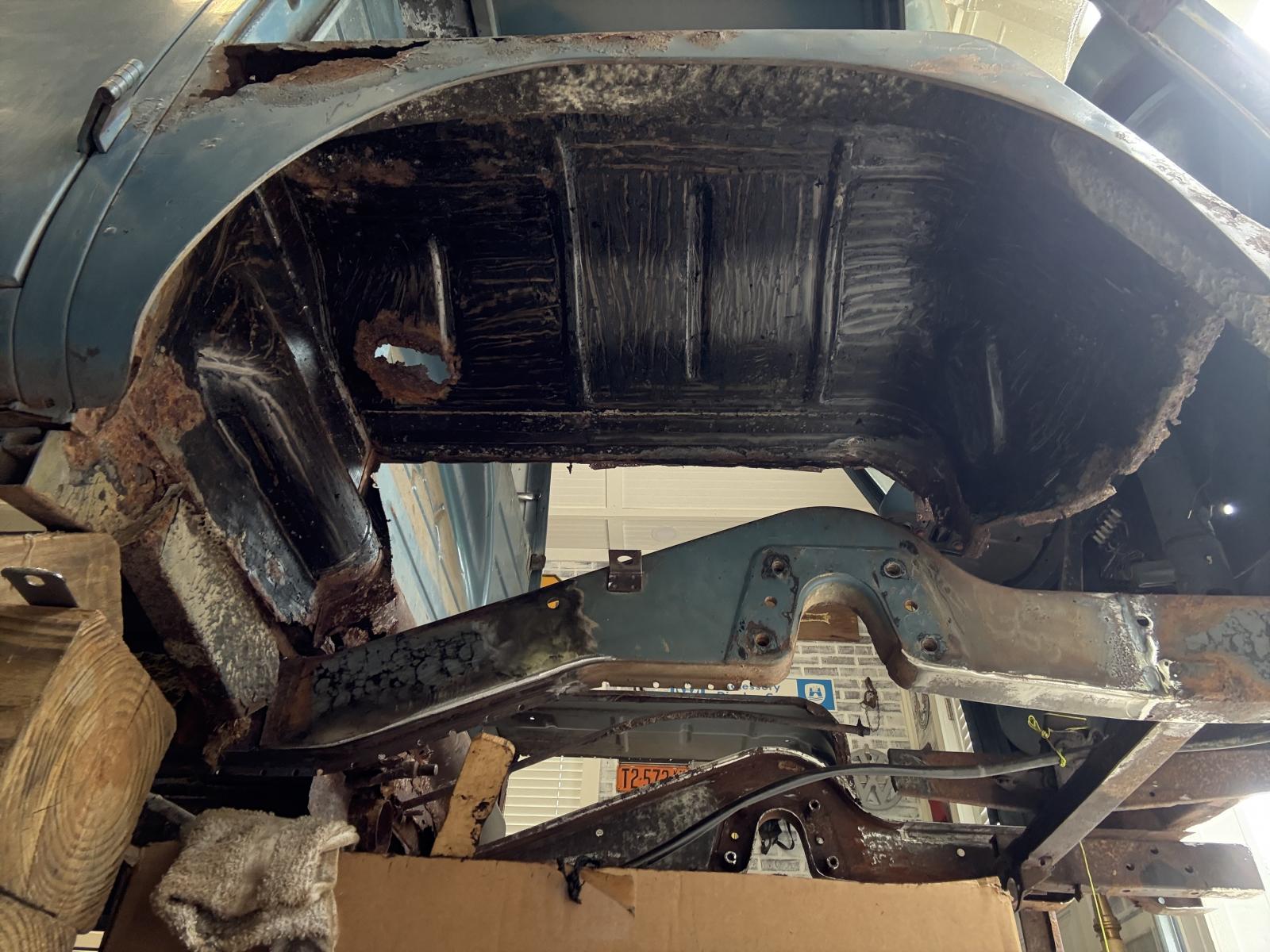

Got some detail work in today and took care of 2 issues I was having! The clutch pedal and lever that was seized and the shifter base plate that was rotted out. I was able to get them both out and even got lucky with a new clutch pedal lever assembly section but will only be using the clutch pedal lever and installing 2 new brass bushings as well. Still cleaning out the chassis framing and about to start with metal replacement. Taking my time to make sure I take care of all this properly for it to last for the next generation of VW keepers!! Wink Thumbs Up
If anyone has a good shifter base plate section for sale, please let me know?
WW nor klassic fab sell this section and would definitely help the project.
Thanks,. Peter

gawd, even mine was better in that area

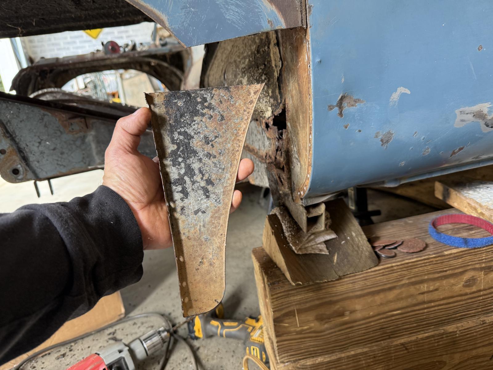

Hello Karl, yes it’s pretty ruff down there but chippin away at it little by little. Trying to clean up the area and then ad a mix of OG, Klassic fab, and Wolfsburgwest metal to get back as solid as possible. It’s definitely gonna take some time but don’t want to cut any corners. Amd my OCD won’t let me do it any other way. I am no professional but I’m gonna give it all I got!! Cool Thumbs Up

bobbybug wrote:
Pete the restoration/preservation is moving along nicely. The detailed pictures really show the time and effort that you’re putting in to this build. Thanks for taking the time to show and report on the progress you’re making it is very helpful and motivating. Keep up the good work and keep us posted on your progress. Thank you

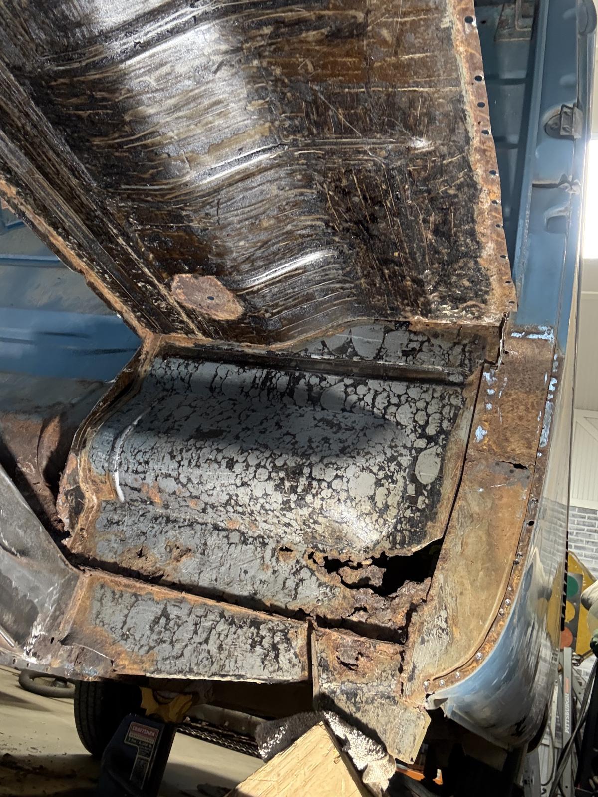

Thank you Bobby! It’s a tricky area to tackle but comin along. Lots of measuring, and I mean lots Laughing and then cutting and fitting. It’s a tedious process but I get in a zone and keep it movin!! Thanks again for the positive comments. Here are some pics of the day comin up! Wink Popcorn

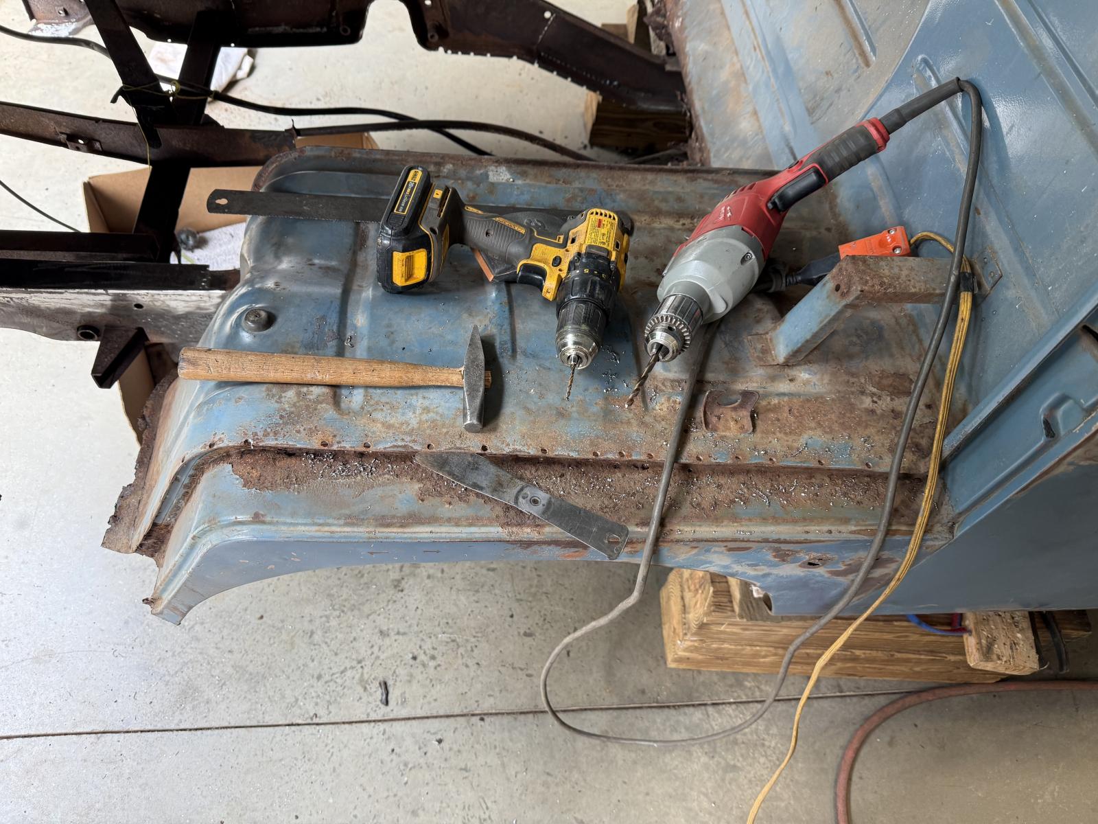

PostPosted: Tue May 13, 2025 8:48 pm    Post subject: Re: 1957 Dove Blue 11 Window Kombi Preservation Reply with quote

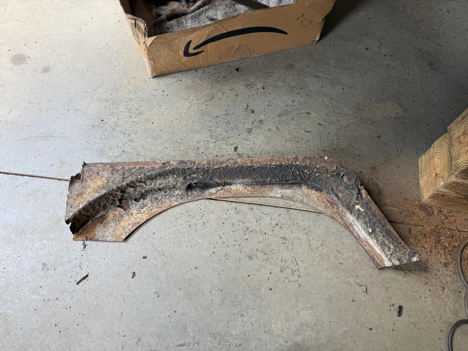

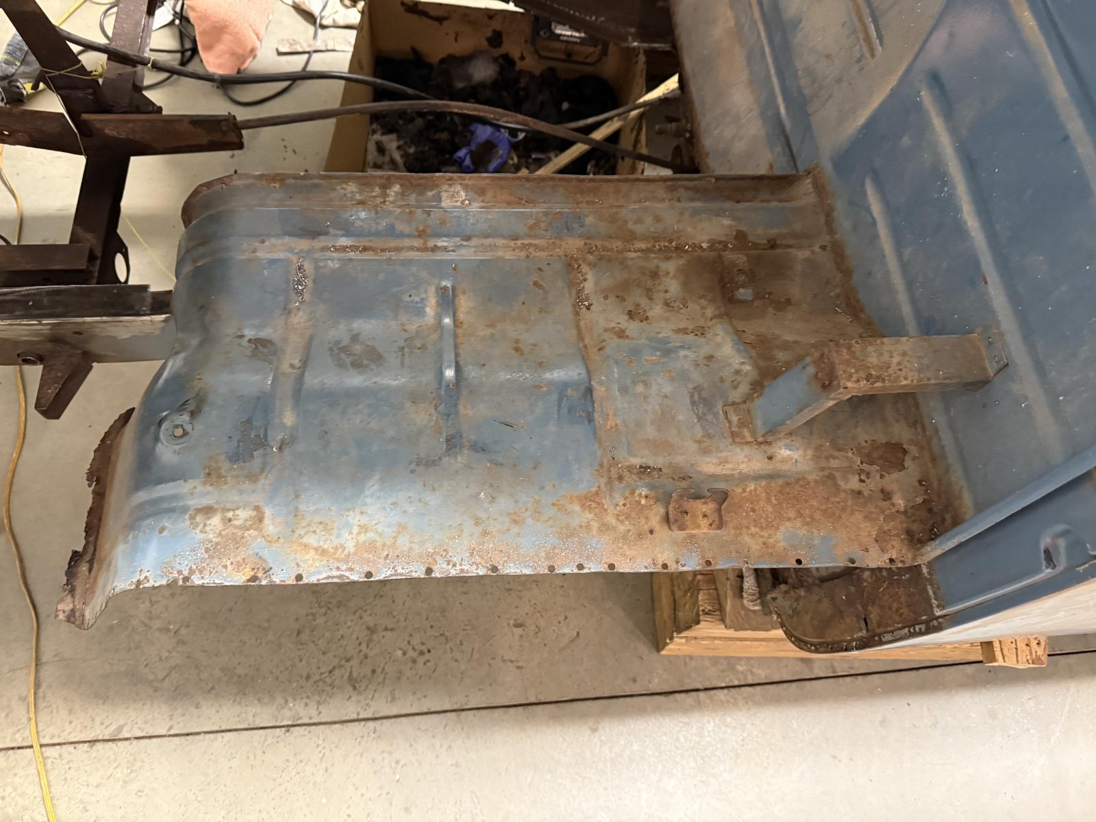

Was able to get some time in the shop today and tackle that passenger side frame. Measured 52 times and cut once!! Shocked Laughing Tedious and time consuming but I am on my time so it’s comin together nicely and correct!!
Should have the passenger side frame buttoned up tomorrow and then the drivers side which is just a couple small sections. After I will be taking care of the lower A-Pillars and Lower Front End Support to square up and stiffen that front end. Can’t wait to have that front end done so it can look like a Bus again!

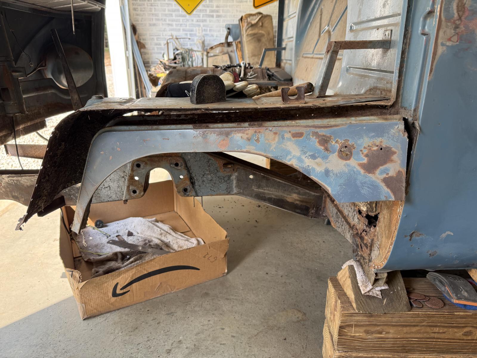

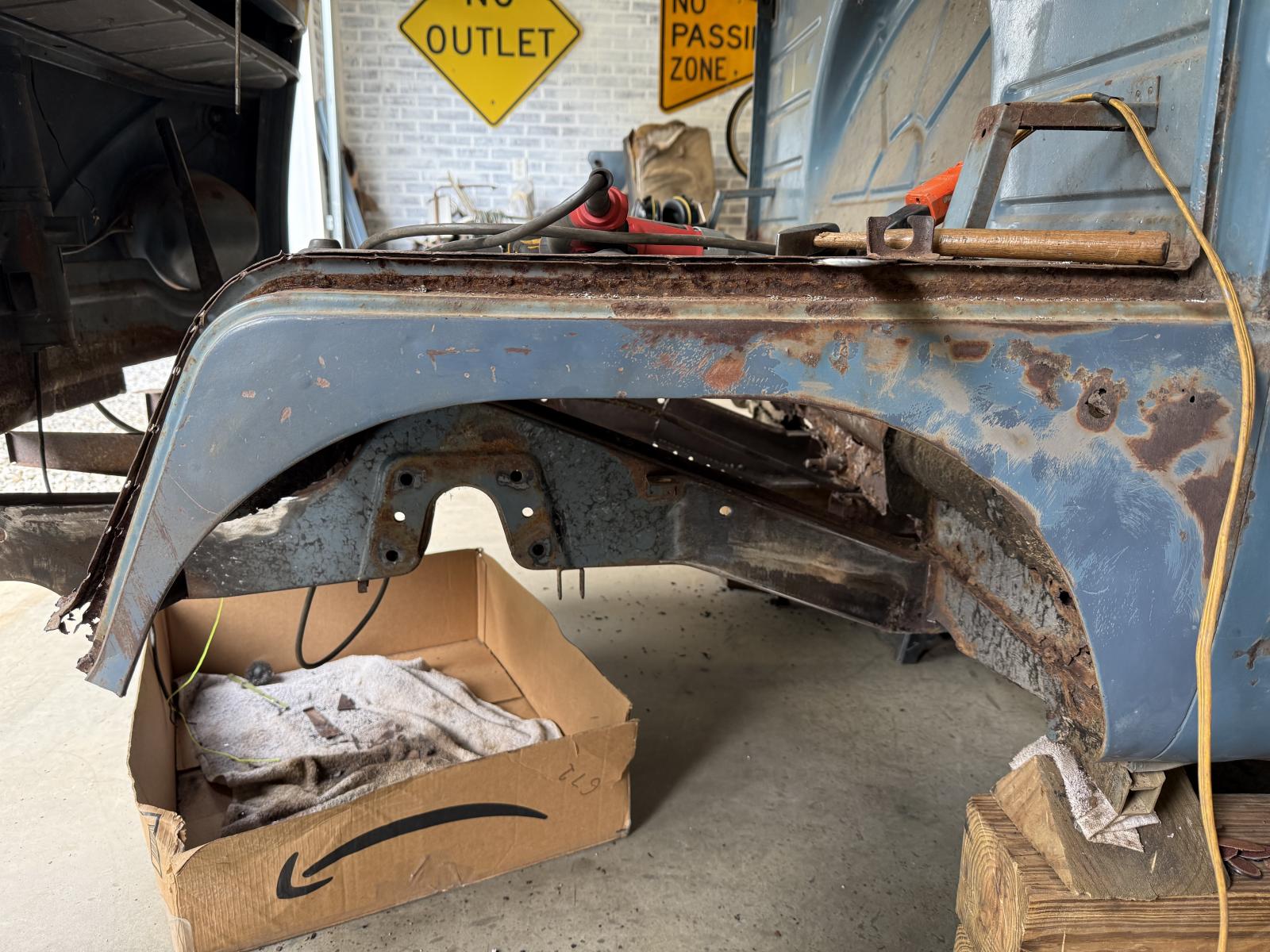

PostPosted: Tue May 20, 2025 7:30 pm    Post subject: Re: 1957 Dove Blue 11 Window Kombi Preservation Reply with quote

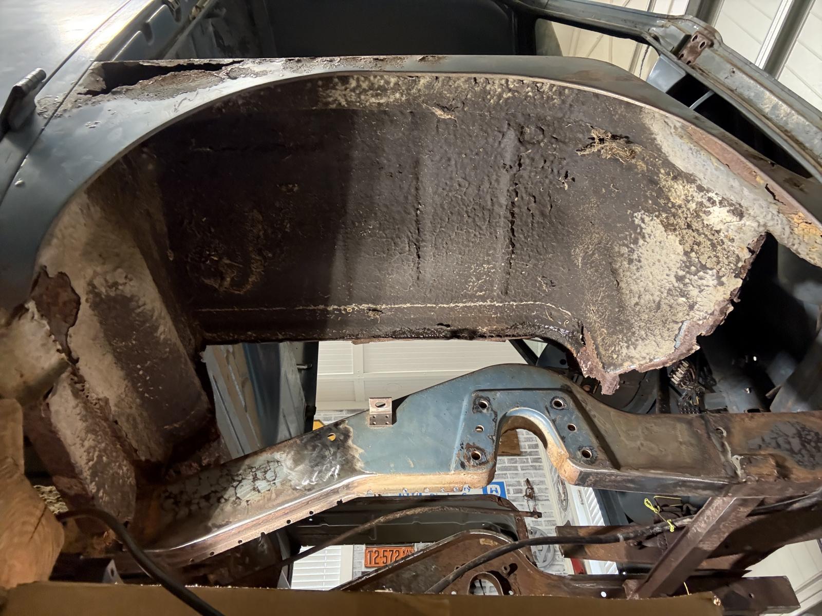

Passenger side comin together nicely!! Taking my time to make sure measurements and fitment is on point so everything lines up and goes back together easily! Should be starting on drivers side soon and should be easier repairs as that side is pretty solid. Can’t wait to start building this area back up, more pics and videos comin soon!! Cool Wink

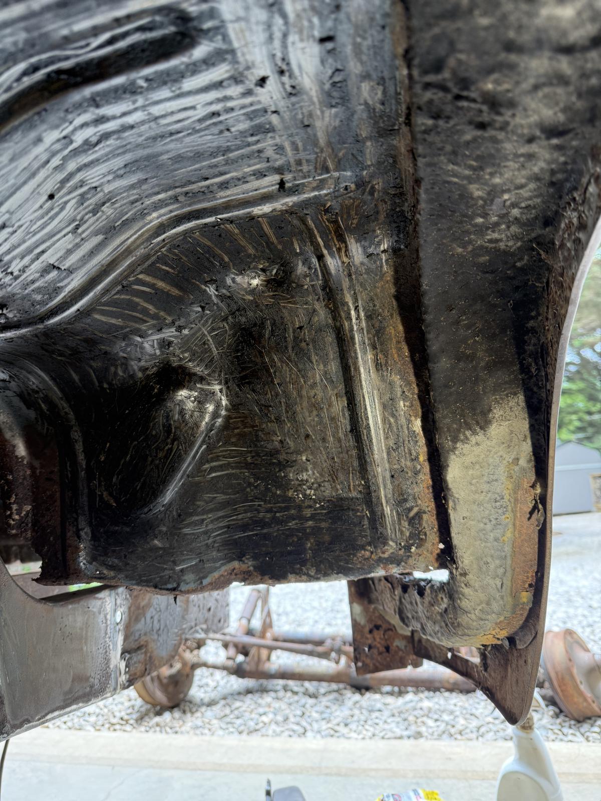

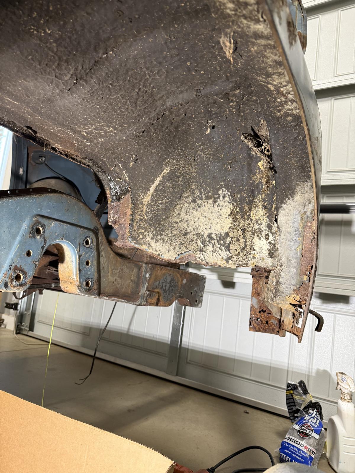

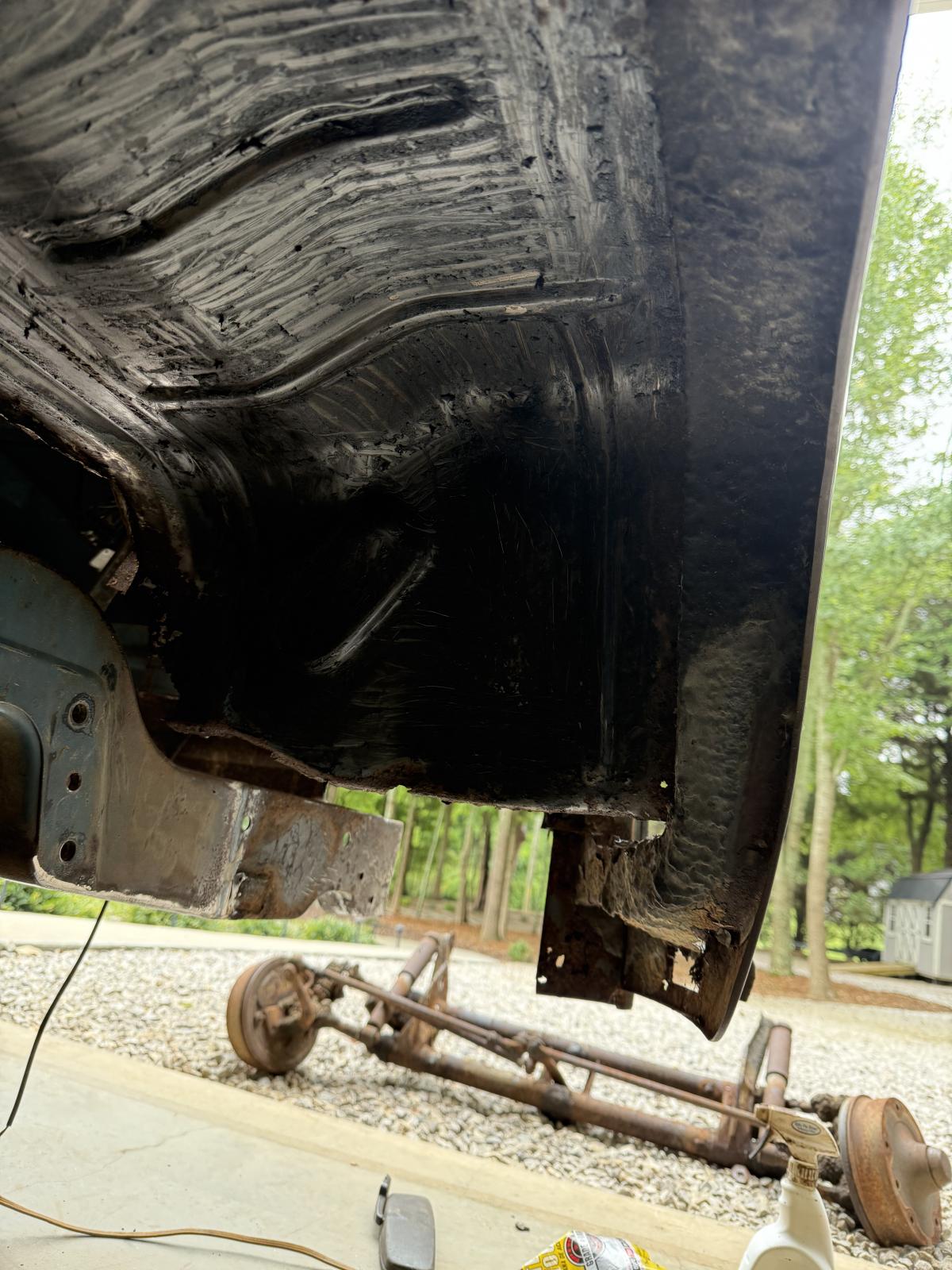

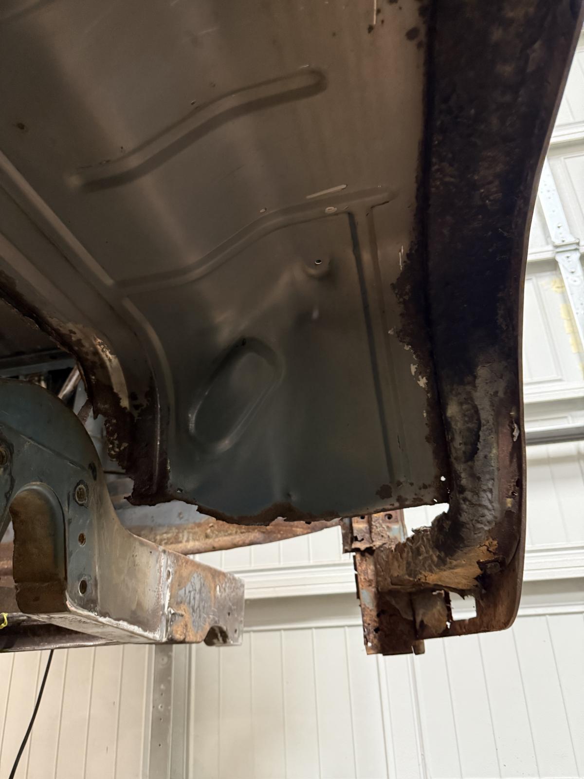

Was able to get this front lower cab section cleaned up and removed all tar to be able to see conditions on entire front end. Still some more prep work will be needed to get the frame rails ready, like sanding and paint on the inside of before inner wheel wells can be welded. I am ready to start putting this metal back, I absolutely love this part of seeing it comin together!! Here we go!!! Cool

PostPosted: Sat Jun 07, 2025 6:12 pm    Post subject: Re: 1957 Dove Blue 11 Window Kombi Preservation Reply with quote
What process did you use to get from "tar mostly scraped off" to "clean gray paint and zero tar? Is it in the videos? I didn't watch those yet.

PostPosted: Sun Jun 08, 2025 8:16 pm    Post subject: Re: 1957 Dove Blue 11 Window Kombi Preservation Reply with quote
I made the video so you can see the process but tar was thick and not warmed up but does come of very easy if warmed. Added the pic of the Prep All brand so that you have another choice that works just as well. Hope this works for ya Bud!! Cool Thumbs Up

ddutch
Joined: June 17, 2020
Posts: 232
Location: Nederland
ddutch is offline
PostPosted: Sun Jun 15, 2025 11:27 am    Post subject: Re: 1957 Dove Blue 11 Window Kombi Preservation Reply with quote
Nice to see you're making so much progress with this bus. Those repairs on the frame look good.
I hope you've put some adequate bracing around the nose section. Since you've cut out so much structural metal from the chassis, the floor and the front pillars, you'll might risk alignment issues later on.
