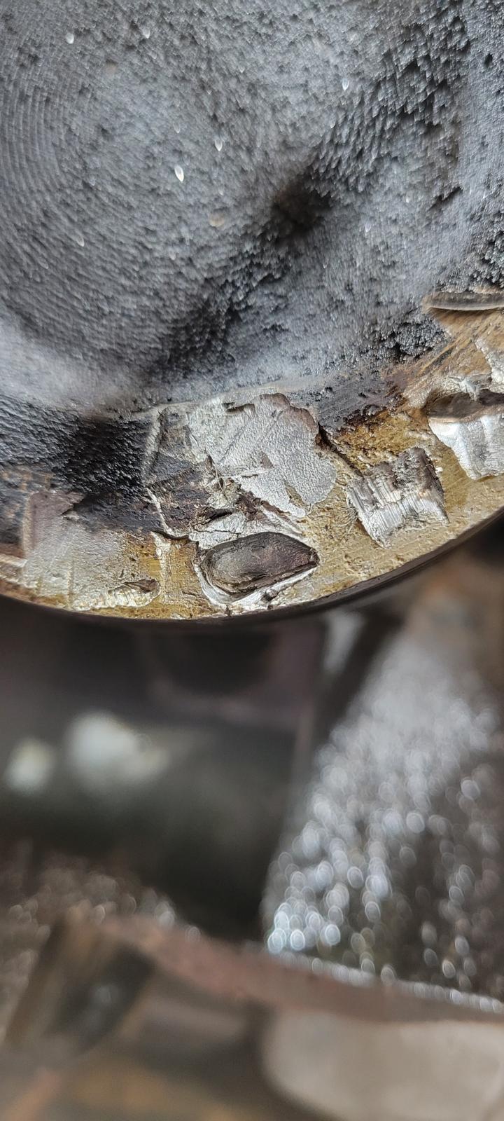

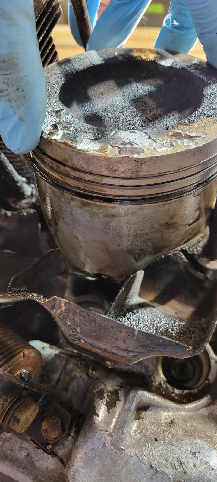

Not gonna run the piston!
Had just a few minutes, but was able to get the cylinder off.
The top ring, and even possibly the middle ring, are a bit pinched where the damage is. Top ring I couldn't even get to pop out, middle one moved with some encouragement.
Don't have time to read the comments since I responded yesterday, but here are a couple pics for your engine damage porn pleasure.

well, that answers that Laughing on the cheap, 1 new piston/cyl or if you're feeling frisky just to p+c's and heads

Yep! That's all we were waiting for! If the ring grooves are pinched all the way to the second ring....piston is done.
As Skills notes....if you can find a good used piston....go for it!
However, if just a quick fix is what you are going to do, I recommend pulling all four cylinders off and checking for scoring on the other cylinders and measure across the piston skirts. You may find that they are all on their last legs.

look inside the bottom and see if there is a makers mark. Look carefully at the cylinder and see if there are any scratches or dings from the shrapnel. Let us know.
Mahle rings are such that the oil control ring is 3 pieces, two rails and a spring. Kolbenschmidt factory ones are the oil control ring is two parts, a coil spring and an outer cast ring.
Be careful, the edges of the worn rings are often as sharp as a razor blade.
My GUESS is that the rod is not bent because the pieces had so little mass.

Oh man, I'm starting to have a hard time wrapping my head around what all I really need to do... Starting to go down rabbit holes and getting overwhelmed.
Haven't ever actually rebuilt an engine, and I struggle to digest the super technical stuff, and then I start seeing all kinds of things that I'm not sure apply... and time is very precious so it's difficult feeling like I'm wasting any when I'm trying to just put an engine together!
Anyway, that's where I am mentally. Here's where I am with the actual engine:
Pulled the cylinders and pistons off yesterday, finally. Doing so brought me to my first question:
Didn't think about wrist pin retainers before, but as I was struggling to get the first couple circlips out I realized it's probably best to replace them. Googling (albeit on my phone with gloves on at the time) was only yielding clips for Type 1 motors. Anyone have a part number for clips that will work for this engine? (Sub question: Circlips or the plastic cap things I also saw, if I can find some that will work?) This listing shows they will fit a '79 Bus but not an '80 Vanagon... https://www.jbugs.com/product/4074.html?utm_conten...PoEALw_wcB
Next question:
For the pistons and rings: I bought one that seems to be a match. I ordered both sets of rings that I could find, figuring that I'd just install whichever one fit my pistons better when it came to that time. (I was feeling optimistic about my own time capacities when I ordered them, so I thought I'd have both "on the shelf" for when I got to that point.)
Question is, would it be worth taking them to a machine shop and asking them to clean up the pistons and balance them? (I have to imagine they have the ability to be more precise than I do in my garage.) Maybe tap the skirts back into place? (Not sure I entirely understood that instruction.)
Last question(s):
Cylinders-I was also thinking about taking them to the machine shop and asking them to give them a quick clean-up honing. Again, I figure they can do a nicer job than I can in my garage. Anything specific I should ask for?
It was reading about honing pistons--trying to decide if I wanted to pay a shop to do it or buy my own honing tool and do it myself--that I started to see stuff about honing them oversize and using larger rings and all that that really got me to feeling this overwhelmed on all this! Please, I need help sorting all this out!
Originally, I was thinking I'd slap the engine back together, but since I got this set of rebuilt with better valves set of AMC heads and had to replace the one piston... While I don't want to do an entire rebuild, I want this top end rebuild to be pretty good and last.

PostPosted: Mon Jun 30, 2025 8:34 am    Post subject: Re: Expensive-sounding noise, time for a Subaru? heh Reply with quote
use a local machine shop. Have them hone the cylinders and glass bead, inspect the pistons. If the skirts are collapsed a little they can gently whack them with a rawhide hammer to massage them back. Don't you try it. Then wash the bores and pistons with hot soapy water to clean them. Make sure you read the instructions on the rings on how to install them. They are fragile, do not expand them anymore than needed to get them on. Lower ring first. Double check the spring expander to be sure it is on properly. Use a ring compressor to hold the rings compressed when you put them back. If you used a good snap ring tool you can reuse the snap rings. There are two sides - one side has a square edge and one has a rounded edge. The square edge goes out. Triple check them to be sure they are properly seated. Make sure you watch the direction of the arrows on the pistons. I use a carbide pencil engraver to mark piston and cylinder numbers so the same pistons can go back in the same cylinders. Mark the pistons on the bottom and the cylinders on the base so no sealing areas are compromised. Yes, I would have the shop do a rough balance on them. A little Black RTV is used to seal the based of the cylinders. Follow the pattern when you bolt the heads back on. Go over the torque settings three or four times. I let it sit 24 hours before doing the last torque. I don't do video chats on rebuilds but Robbie does. You may find someone in a local club who has rebuilt engines to help you do the final assembly.

PostPosted: Mon Jun 30, 2025 8:50 am    Post subject: Re: Expensive-sounding noise, time for a Subaru? heh Reply with quote
Thanks for that; it is helpful with calming myself down a little.
My snap ring pliars aren't the greatest... I am afraid that at least one of them is a bit "squixhed" in a little, as in I don' t think I could fully trust it to put the proper pressure in the groove in the piston anymore.
