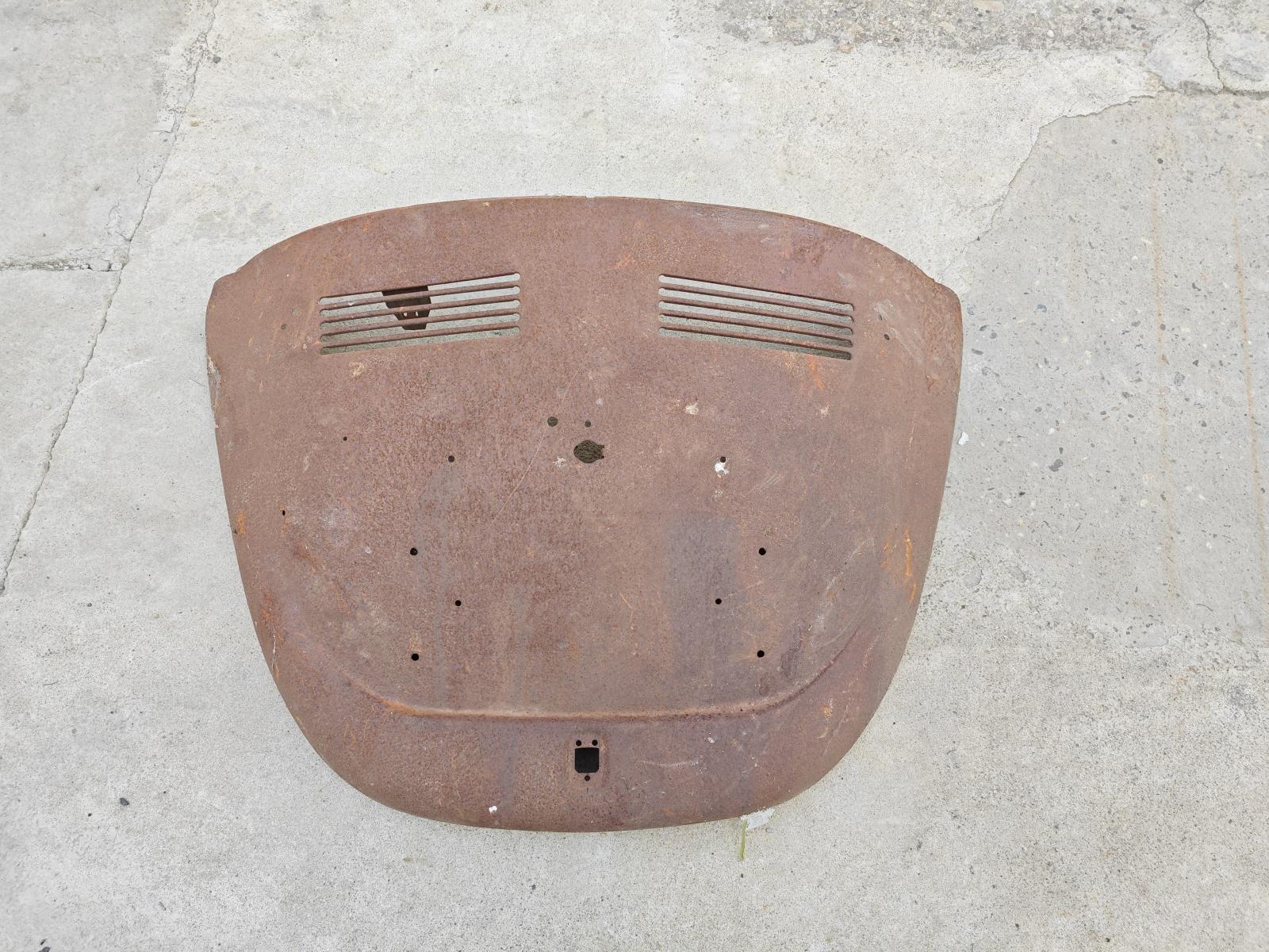

Preparing for the "long" gearbox. I received an engine hood for 1302 from a friend. I have another 65 engine hood. So, plan is to make a "convertible" hood. I have the measurements from another topic, fingers crossed I make this right Smile.

Good that you have measurements from a ~ '65 lid. Note that the vents from the 1302 are not "straight across" along the top line of the vents; they are higher at the inner ends so that they visually follow the top edge contour of the entire lid. By contrast, the vents are straight across on the ~'65. Here you can see this on a '65 lid (VOLKSWAGNUT gallery)-
Also evident on this early '64 (philippe)-

Hello Rome, yes, I will follow the layout for 65 hood, not the 1302 positions.
