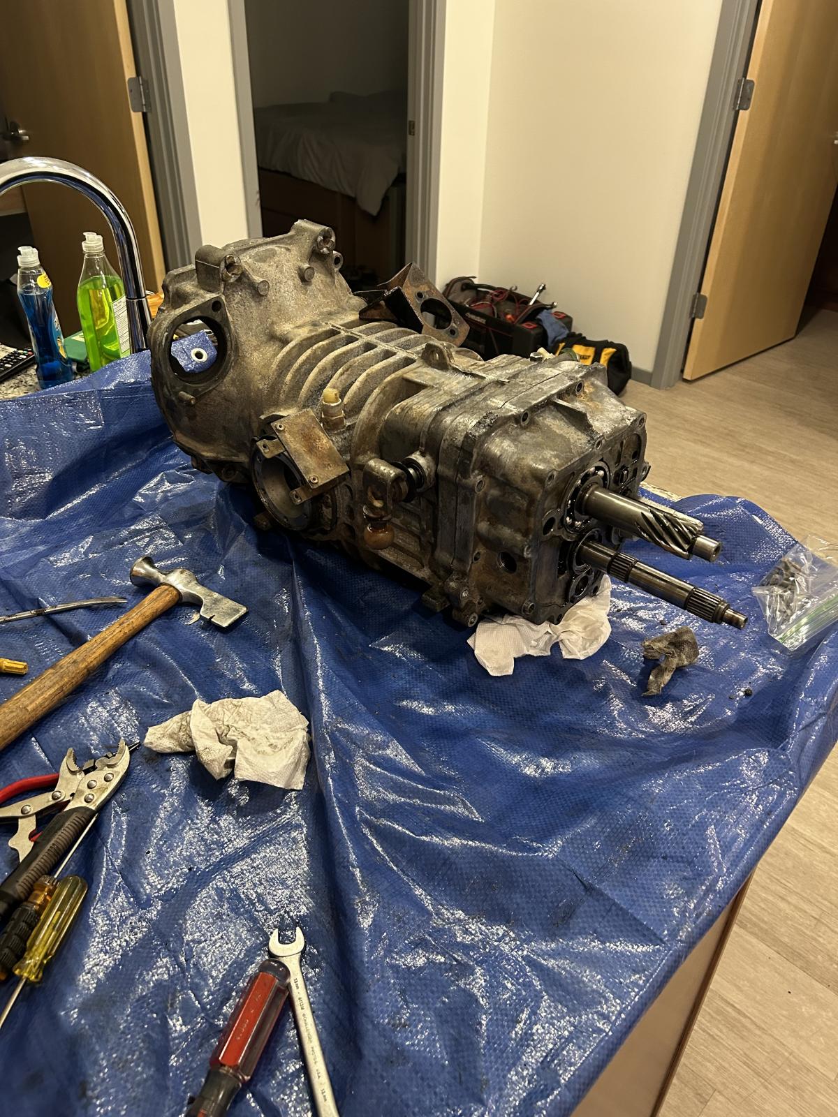

So the last week or so I've started tearing into the transmission and getting some work done to it. Thankfully, I have a cool roommate that doesn't mind me tearing apart a transmission on the kitchen counter or storing the pieces behind the couch Laughing It's a very small apartment too, but I guess it works well for a clean space Laughing
I ordered most of the bearings for it. I ordered a bit of the parts I needed from Van Cafe then I just placed a huge order with Weddle, the both love me as a customer I'm sure Rolling Eyes Laughing I decided to skip the idler bearings in the nose cone since they are a pain to do and rarely see loads. I am replacing all the mainshaft and pinion shaft bearings since those see higher loads, and the mainshaft gets less oil. I am also doing the tailshaft bearing. I also ordered the pinion nut tool but the sidescrew tool for the diff was out of stock so I may try to make something.
Overall as I've torn down the transmission, it all looks fairly good. I haven't seen signs of a lot of wear or anything wrong. Hopefully I don't find anything. I was also able to figure out why the locker didn't work. The selector shaft was seized and one I got the bushing out of the transmission, I had to tap the shaft out of the bushing with a hammer. It looks like the locker was hardly used.
Here are a few picture of the work and new parts. A new 3-4 slider and hub, front suspension bushing, some bearings, and misc parts. I had thought I heard the peace pipe was NLA but Van Cafe had it for a good price.

Progress has been slow, a lot of waiting on tools, realizing I need more tools and just been busy
I’ve been slowly getting it apart. I tried to make a side screw tool, I used epoxy and the old side screw lock plate. It worked for the one side but the other side was too seized. I put a grade 8 bolt 3/4” bolt on the oil filter tool and used an impact. To say the least, the bolt and nut stripped on the threads but the epoxy didn’t break Laughing so I had to order the proper tool.
I let the side screw soak in PB blaster and gave it a shot today with the proper tool. It finally came out with the impact. I got the diff out, got the pinion nut off, and got stuck again Confused Good news, the pinion bore is tight, bad news it doesn’t want to come out Laughing I’m going to try again with help tomorrow. I set it up similar to how the vw tool is supposed to look, but it is tight
And some more transmission pictures in my apartment. I will say this has turned into a bigger project than expect Laughing

While I applaud your willingness to tackle the transmission it should be noted that rebuilding a Syncro transmission requires some special tools and experience.
There's a reason Syncro transmission rebuilds are big $$$ with only a few specialized shops doing good jobs. If you get it wrong you could be destroying a very valuable transmission.
Why did you feel you had to take on this project? Was the transmission making noises? Any vibration associated with the driveline would have nothing to due with the trans and boils down to a proper alignment of the driveshaft angles.
Here's a link to the 1986 factory service manual for the Syncro transmission and front diff. (you can ignore the stuff about selectable 4x4 in the manual, VW never sold any Syncros with that setup)
https://www.thesamba.com/vw/archives/manuals/1986_vw_syncro_service_manual.php
This manual shows the major steps of rebuilding the transmission but it assumes knowledge of transmission work. Hopefully you knew to mark the various starting points before taking it apart.
It is extremely important to get all the precision measurements correct and to conduct the required steps to achieve those measurements.
Even experienced Syncro transmission repair shops can get these steps wrong due to the finickiness of German engineering.
Best of luck!

I’ve seen so far why they are expensive, tools and parts alone have racked up a pretty good bill on this project. I have all the precision measuring tool, micrometers of different sizes, dial indicators, torque wrenches, calipers, feeler gauges, bore gauges, and some other stuff I’m forgetting. I’ve mainly just had to get the tools for special parts of it.
I wanted to tackle it since I had to pull the engine for head gaskets, the locker was seized up, the trans was leaking bad so it was going to have to come apart a lot. I was also worried the driveshaft vibration had taken a toll on the bearings. I’ve also had to replace two mainshaft bearings in my VW’s in the last year so I wanted to get ahead of it. The transmission also has 175k miles so I wanted to get ahead of it before there was an issue. I also feel good enough with my mechanical abilities to tackle the job where I won’t screw it up, and hopefully I don’t Laughing
Thank you for the link! I didn’t realize there was that manual, I’ve just been using the Bentley for all the work. I’ll be reading into that a bit.
