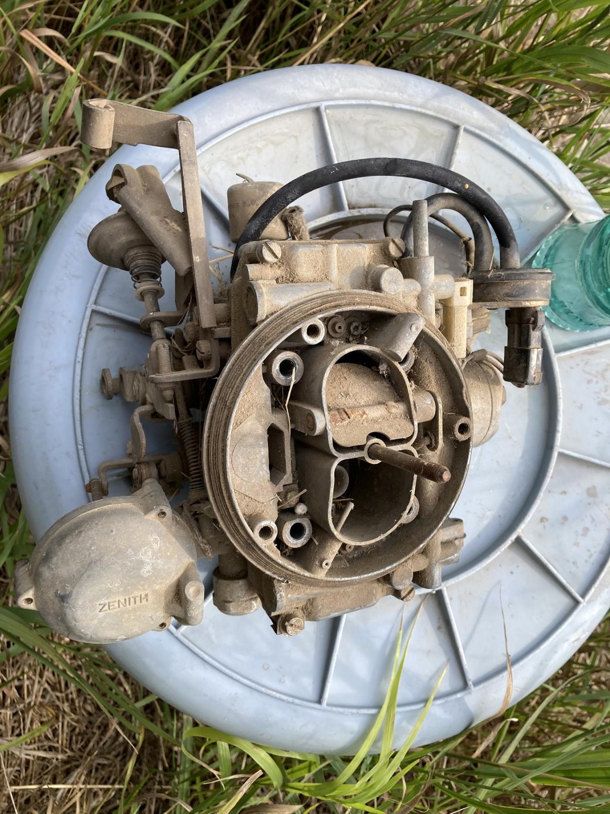

My '76 Rabbit came with a Solex/Zenith 2 barrel progressive carb. By the time I got it to work properly the throttle shaft bores were worn enough to cause erratic idle. I still have it and have wondered how it would have worked on an air cooled 1600.
That had to be be same carb. They were overly complex for a small two barrel.....well...at least compared to something like a Holly 5200 series.
They were a pain to get running right on the few I worked on.....and thats because they all had the moderate to high miles problem you describe.....worn out throttle shaft bores causing idle issues. It took me a while to figure out the same thing working on a few Dashers and Foxes......because I am less carb centric than injection centric.
For some strange reason I keep getting the recollection that this was not a progressive carb per-se....that the two eqyal diameter throats were geared together and opened at the same time. Ray

It is a bit of a complicated little beast. The secondary seems to be vacuum operated with a mechanical lock out from the primary it looks like. Ya, been many years since I looked at this thing...
Throttle plates measure out to be 32mm. I am with Modoc on this that it would not benefit a single port engine much if any but might work alright on a dual port. It would be a challenge to fit as is though with all it's warts and gizmos. Pretty bulky.
When I went turbo I pulled it, went to a '75 Sirocco intake because it had a Solex PICT 34 so had a simple single hole instead of the plenum for the progressive. Then I went Weber 40 DCOE draw through.
This carb hasn't seen service since then.
