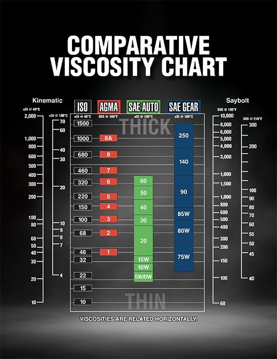

I don't know if it has been covered here yet or not but for all you heavier is better folks I am seeing ads now for 60wt "racing" oil.
Not my cup of tea but some may want to try it. It's gotta' make your car faster... no?

PostPosted: Tue Jun 10, 2025 3:05 am    Post subject: Re: Official "What oil / additives should I use" topic Reply with quote
In Mexico, it's pretty easy to find 25W-60 engine oil. The numbers are bigger, so it's gotta be better, right?
