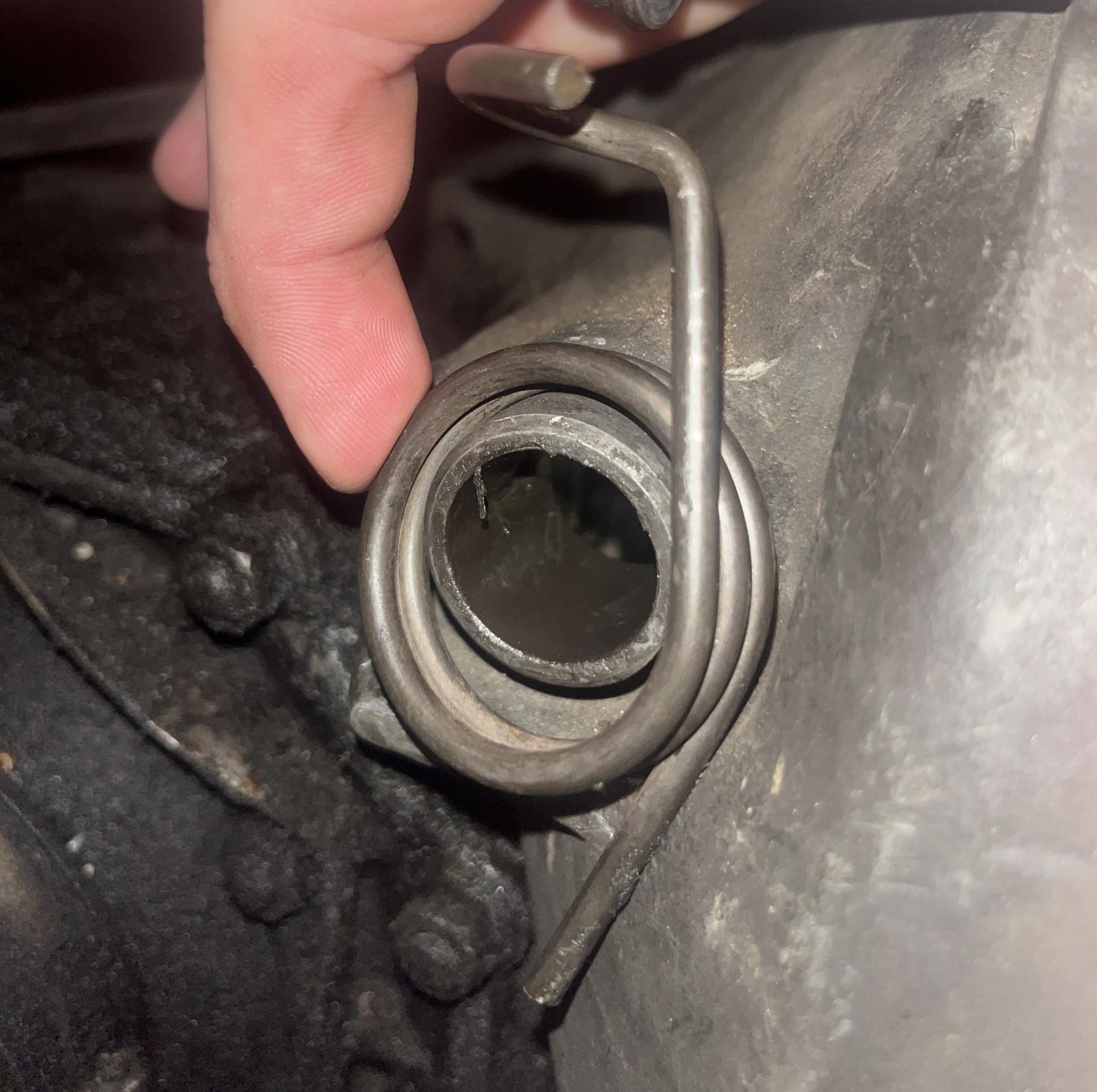

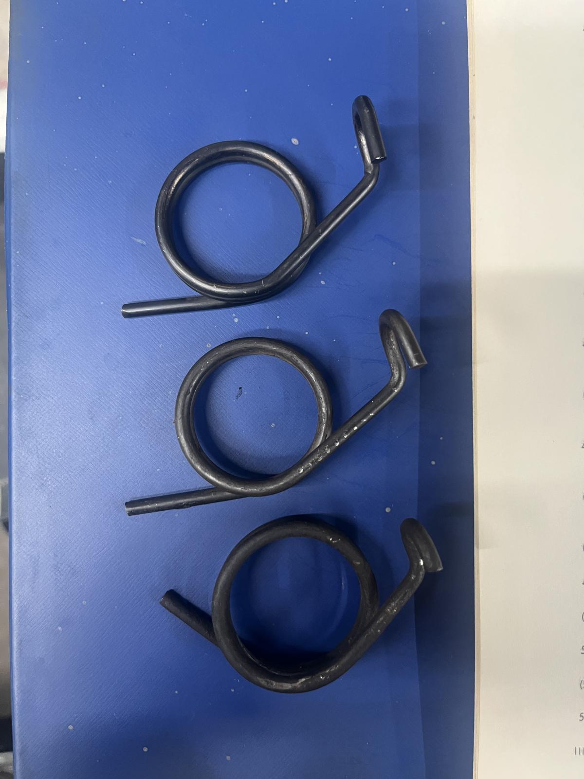

Anyways, onto the next issue I've run into. This is completely unrelated. I've been not enjoying how the clutch pedal feels for some time now but I'm just now deciding to do something about it. The spring is just very weak and felt bad. I had 2 (what I thought were good) spares. Well I was "testing" the fitment and saw just how off they were to the one that was on the car.
the bottom spring is the one that was previously installed on the car. The other 2 springs notice how the end are pointing down in a very dramatic different angle. When I test fit both "new" springs they were so far off from where they are supposed to sit on the transmission.
Notice how it is pointing straight down. I know it is supposed to be somewhat difficult to get into place but after watching some videos cause I was scratching my head. All the guys who replaced this spring it showed that the tail of the spring wasn't pointing that far down like the new ones I had. I checked the parts book and noticed that indeed there are 2 different springs. It changed sometime mid 1972 from what I can tell.
I have no idea what the other springs look like installed on the transmission or how they truthfully differ from the earlier ones, but I would be willing to bet that I have the later springs even though I bought them new from my local general vw parts store. Are the new ones the later ones that are sold? Does anybody have some light they can shine on this? Am I correct in thinking that I have the later ones or are the springs just that way?
