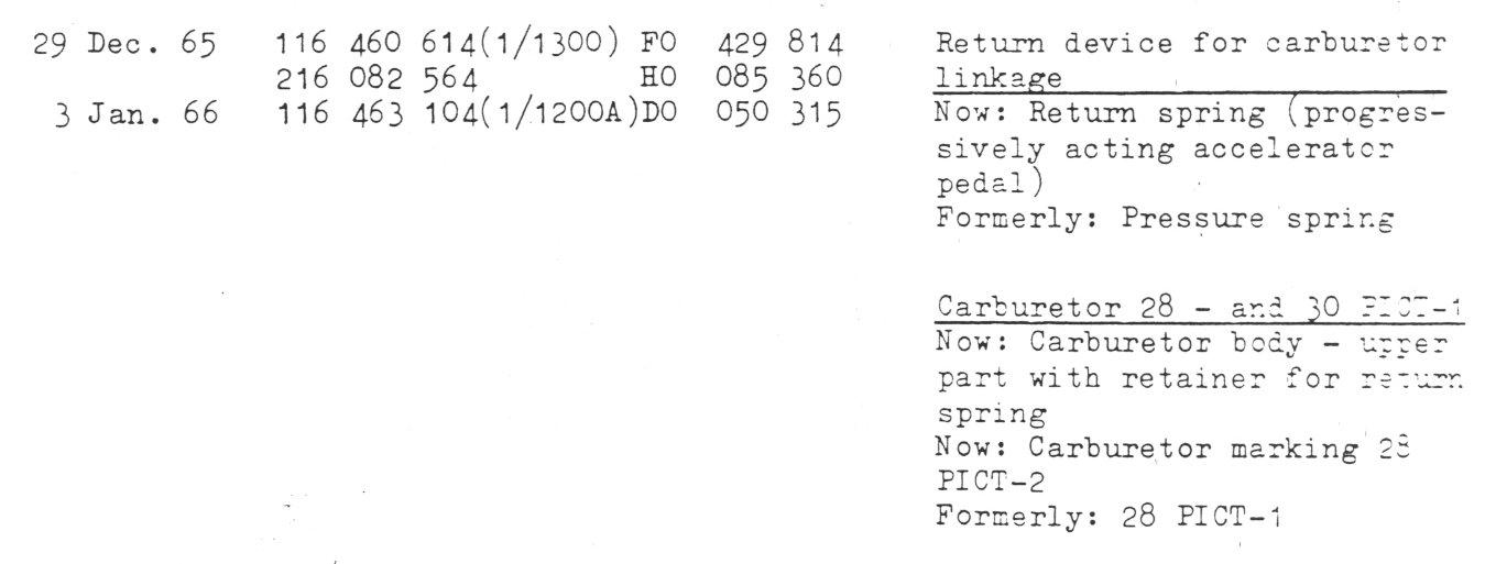

So for 66 buses, not 65 (but you could have a 66 MY that was made those last few days of 65 w/ these changes).
So according to this a 65 should have a 28pict-1 with no spring, and a spring at the fan shroud, correct?

Posts: 71578
PostPosted: Sun Jul 27, 2025 1:19 pm    Post subject: Re: Stock factory engine 1965 Reply with quote
70bus wrote:
- Without Guesswork states buses should have a 1500 standard from Aug 64 or perhaps Jan 63?
I think August, 1964.
January, 1963 seems to be VERY common for USA-Delivered 15/23-Window Deluxes so maybe standard for Deluxes only?
