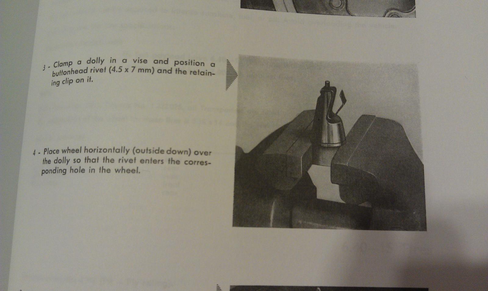

Next wheel problem, this is the wheel I swapped out with the spare, I read somewhere the hubcap clips are riveted in how do I remove the old rivit without damaging the wheel and once I buy new clips I am assuming they include a rivet which I know how to apply. Thanks again, making progress everyday.

Drill the rivet out from the backside of the rim. Be careful not to make the hole too big.I use a 1/8" bit, which is smaller than the rivet, but once drilled I use a small center punch to drive the old rivet through the hole.
I also grind the back of the rivet flush with the wheel to get rid of the mushroomed part of the rivet. Sometimes that is enough to make the rivet come out without drilling. Don't overdo the grinding, just remover the rivet mushroom.
You need a special rivet tool to install the factory rivets. I don't bother with that anymore, but I built a tool for it years ago. Now, I just use a small screw and a nylock nut. Works perfect every time, it can't be seen with the hubcap on, and if a clip breaks, it's much easier to replace.

Lots easier (and no risk of drilling off center) to either use a small chisel to chop off the rivet head or use a dremil cutting disc to do this if worried about slipping with the chisel and hitting nicely painted rims.
Then pin punch out the rivet remains.
See 1963-67 Workshop Manual, section B-10, page 3.

PostPosted: Tue Sep 04, 2012 2:25 pm    Post subject: Reply with quote
Thanks nice dolly:
