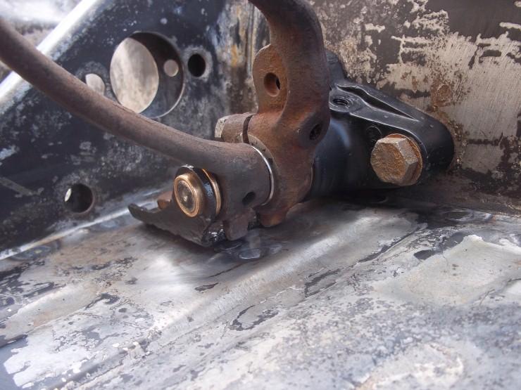

I'd like a pedal switch set up, but the one advertised earlier indicates it only works on '58 and up beetles. I have a '57 Oval with a roller pedal accelerator (I know we're talking brakes), but IIRC, the whole pedal assembly is different on Ovals. Any suggestions on options I might use? I may try a low pressure switch as suggested earlier, but don't want to bugger my threads in the dual MC I've installed creating more problems. And my Oval is still 6V.
zerotofifty
Joined: December 27, 2003
Posts: 3785
zerotofifty is offline
PostPosted: Mon Jun 30, 2025 8:25 am    Post subject: Re: Using motorcycle brake light switch for quicker brake lights? Reply with quote
You can make your own pedal switch, assure the switch can handle the current load. Also upgrade to LED bulbs for faster turn on time and improved brightness. On my 61 Bug I placed extra lights in the rear window, these are trailer lights, located in the lower corners, and serve as both brake and turn lights. For the oval, smaller lights than I used will be preferable so as to keep the smaller window more clear. Some but extra lights inside the body louvers that are below the window. Others mount a big brake light(s) on the bumper, although not as visible as a high mount, that too can be a big improvement in safety.
Stay bright, stay safe!!!!
Sorry About That Chief.
Give Peace a Chance.
Words to live by.
SixVolt Premium Member
Joined: January 04, 2004
Posts: 1143
Location: Cleveland, Ohio
SixVolt is offline
PostPosted: Mon Jun 30, 2025 8:30 am    Post subject: Re: Using motorcycle brake light switch for quicker brake lights? Reply with quote
zerotofifty wrote:
I have the 3rd brake light in the window and have upgraded to 6V LEDs in the taillight assemblies. (I know why am I running 6V?) Anyway, I need to figure out how I would make my own pedal switch? Would I just get a plunger behind the brake pedal that would activate a switch mounted on the firewall?
zerotofifty
Posts: 3785
PostPosted: Mon Jun 30, 2025 8:50 am    Post subject: Re: Using motorcycle brake light switch for quicker brake lights? Reply with quote
SixVolt wrote:
zerotofifty wrote:
Usually the plunger or a lever arm of the new switch is situated on the driver facing side of the pedal arm, so that as soon as the pedal is depressed ever so slightly, the plunger is no longer depressed by the pedal lever, and the switch is activated. To be clear, the activation is done from the rear of the pedal, meaning rear of car side, the side closest to the driver seat, the side furthest of the pedal from the firewall.
See how this one is done, as I described...
https://www.thesamba.com/vw/classifieds/detail.php?id=2140061
I own one of these for my 61 Bug I recommend it, well made.
I had at one time (35 years ago or so) even made my own, but mine was a bit delicate so I got one of these linked above when it became available. Note it is NOT designed for the pre 1958 roller type pedal cluster, but you should be able to modify it for that application I suspect, or build your own from scratch.
Note that this switch is not rated for the high current of 6 volt incandescent bulbs (6 volt bulbs draw twice the current of same watt 12 volt bulbs) However this switch will work fine on a 6 volt LED bulb as the LED bulb draws very little current.
I dont know how it fits with the old roller pedal set up, but you maybe able to modify its mount or make a new bracket to fit any sort of pedal assembly
When the pedal is at rest, the switch is depressed into the open position, as soon as the pedal is pushed for braking, the switch is released and the circuit is closed, the brake lights turn on.
There are some pretty creative folks on the Samba. Can you post a photo of your pedal assembly? Not sure how many of us can conjure up an image in our minds for imagineering purposes.
I have the pedal switch kit Keith sells in my '63 (still 6v). It's just a basic micro-switch. The bracket he fabricates is what makes it work on '58 and later. Any decent hardware store should have a bracket that can be modified (cut/bent/drilled) to work with that switch and your brake pedal. BTW ... IMO I think it is better to use a relay with this switch regardless of whether you have a 12v or 6v system and are using either incandescent or LEDs. The contacts in that switch will last much longer if they only need to carry enough current to trigger the relay rather than deal with the current needed to illuminate the bulbs.
I did find this photo in another discussion. Same as yours?

OldSchoolVW's wrote:
Certainly a relay would take load off of the switch and are often a good choice to do so.
However, since a big part of the discussion is on the time it takes to illuminate the brake lights, wouldn't a relay also increase that time? It takes a few mincroseconds to close that connection.
