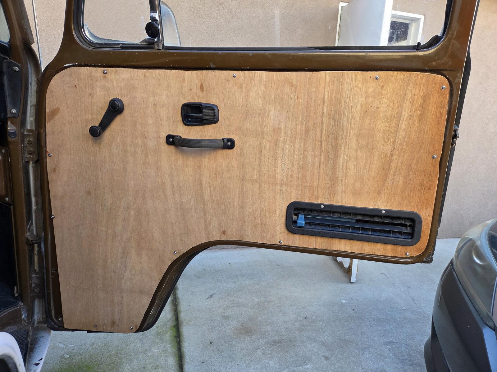

PostPosted: Mon Dec 08, 2025 12:00 am    Post subject: Re: T2 VW bus convert to EV Reply with quote
Sorry for the long delay in posting, There is still no delivery date for the EV conversion parts. To get an exclusion from tariffs the entire order must be shipped together as a 'EV kit'. The batteries are the long pole in the tent.
Thanksgiving and relatives got in the way of my hobby. Last post showed progress on converting the interior from shag carpet to minimulist transport. As a step back, 10 days ago thin wood side panels were ready for paint and the new rear ceiling was complete and painted.
Still to be completed are the door panels: sliding, passenger and driver. I bought the bus without any panels. When I saw the price of original equipment door panels I almost sh*t a brick. I decided that 'minimulist' included painted door panels. This was aided by the fact that I am frugal (some say cheap) so I traded OEM vs my time to make door panels. Cheap won out in the trade. I made templates for the panels from taped-together thick paper by tracing the door outline.
I used the interior 0.1 inch plywood to cut out the panel. Too bad for me, I cut the plywood blank 1 inch too short for the passenger and driver door shape. Yet another trip to home Depot. The photo above shows the problem at the bottom of the door panel. Below is a photo of the plywood passenger and driver panels after cutting them out from a 4x8 sheet. Yes they are mirror images. VW is no fool for production costs.
I used the same method for making a sliding door panel. I did not spend the time to look at how the OEM parts delt with the protuding door latches front and rear. Instead I ask myself "what is easist solution?" So I cut out around the door latch mechanisms Below is a photo of the resultant door panel, painted and ready to install. The light tan color will be used on the rest of the interior.
The door panels are going to be installed using 4mm screws and rivnuts in the door upolster holes. Rivnuts are similar to the plastic wall inserts used to hang pictures, but are rivited unto the door sheet metal. A Rivnut was installed in everyother hole, and on each corner. The revnut insertion tool is shown below.
The passenger door frame is seen below. Look carefully and you can see the 13 rivnut installed into the door. The passenger door panel was then test-fitted into the door. Two 4mm screws at the top hold the panel in place. This locates the panel so the other screw hole can be located and drilled.
That is all the progress this 2 weeks. I think next week will be more productive as I finish panel painting and installation

PostPosted: Mon Dec 08, 2025 4:52 am    Post subject: Re: T2 VW bus convert to EV Reply with quote
I’m a fan of rivnuts, but it’s gonna be a real pain for the next person to get those out. I usually self tapping screws with finishing washers to attach wood panels.
Smear some clear polyurethane on those panels ant they are gonna look nice.

PostPosted: Yesterday 10:07 pm    Post subject: Re: T2 VW bus convert to EV Reply with quote
Good news!! progress is being made at CanEV on the battery boxes and battery shipment. My previous build of an EV classic jeep I built and wired the battery boxes myself. The jeep used 3 battery boxes, one in the gas tank well, one in the back behind the seats, and one under the hood. This crammed boxes into each space but used semi custom boxes. The gas tank battery box was custom sized and built from plywood to fit the limited space between frame rails.
This VW EV conversion is going to use the latest design from CanEV. This is a semi-custom battery box that is pre-wired for both high amperage drive current and BMS cell monitoring. Having the BMS unit inside the water proof box both simplies wiring and protects the BMS ( not water proof) from the elements. This also allows simple cable conections between the battery boxes and the motor controller. The photo below shows the new battery box under fabrication. The white area is foam padding for the batteries, the front portion is for BMS and high current contactors. I expect delivery as a Christmas present.
Good progress is being made on finishing the upgrade to the bus interior. The sliding door panel has been finished, installed and looks good. of course I am not biased just because I did the work myself. The photo below shows the installed sliding door panel. The panel was painted before installation with the light tan paint I picked for contrast with the brown VW sheet metal. The paint choice was slightly influenced by the fact that I had a 1/2 gallon of paint on hand. Still to be done is touch-up the paint over the M4 mounting screws.
The fitting of the passenger and driver door panels is under way. After fitting 2 mounting screws to locate the panels, I used playbough to find the location of the remaining 11 Rivnut locations
This did not go as well as I planned. The playdough stuck to the metal door frame instead of staying on the wood panel. About 5/11 locations were marked, the rest of the playdough were still on the door.
The photo below shows a good playdough location indication. Even with good location marks the screw alignment was not perfect. The slight curvature of the door frame gave some mis location, ususally about 2mm or less.
I tried a film of grease to keep the playdough from sticking to the door. That did not work. Then I went to celephane packing tape and that seemed to work better. Below is a photo of the passenger door panel after test fit and slight modification of the vent hole size.
Still to be completed is the final installation and fitting of the driver door panel, painting of the panels, and final painting of the interior panels to match the sliding door
