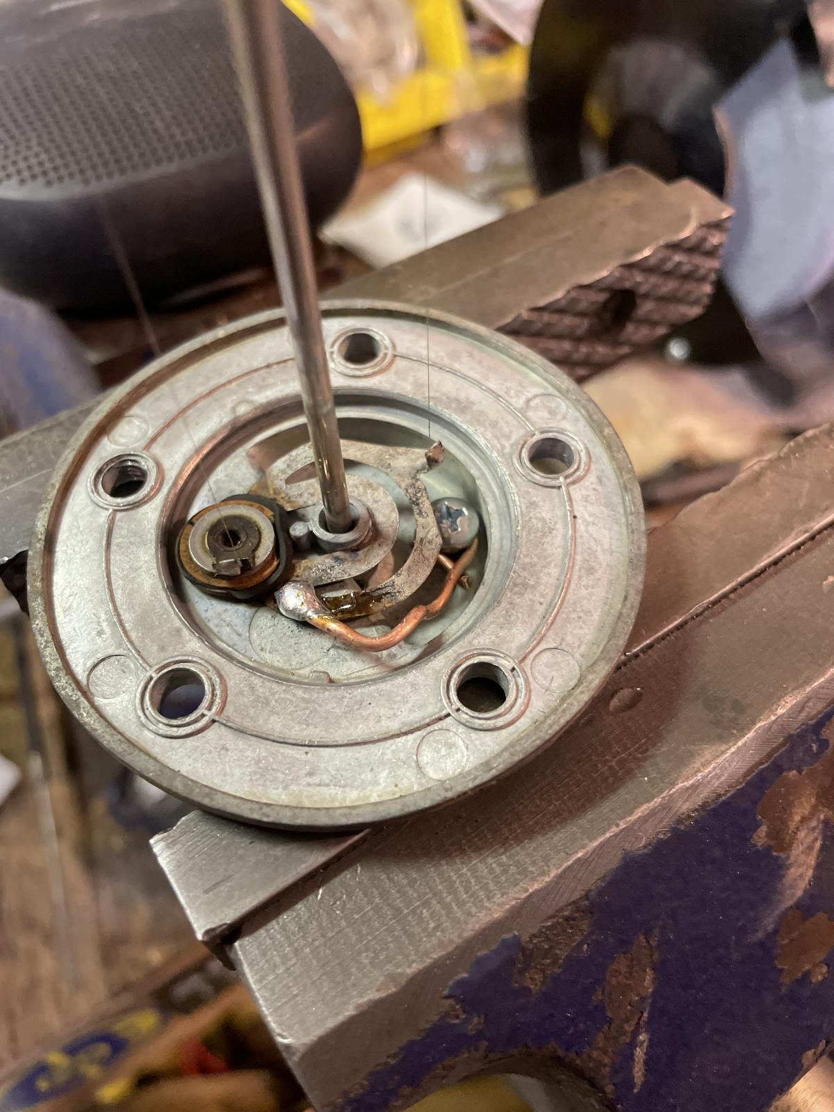

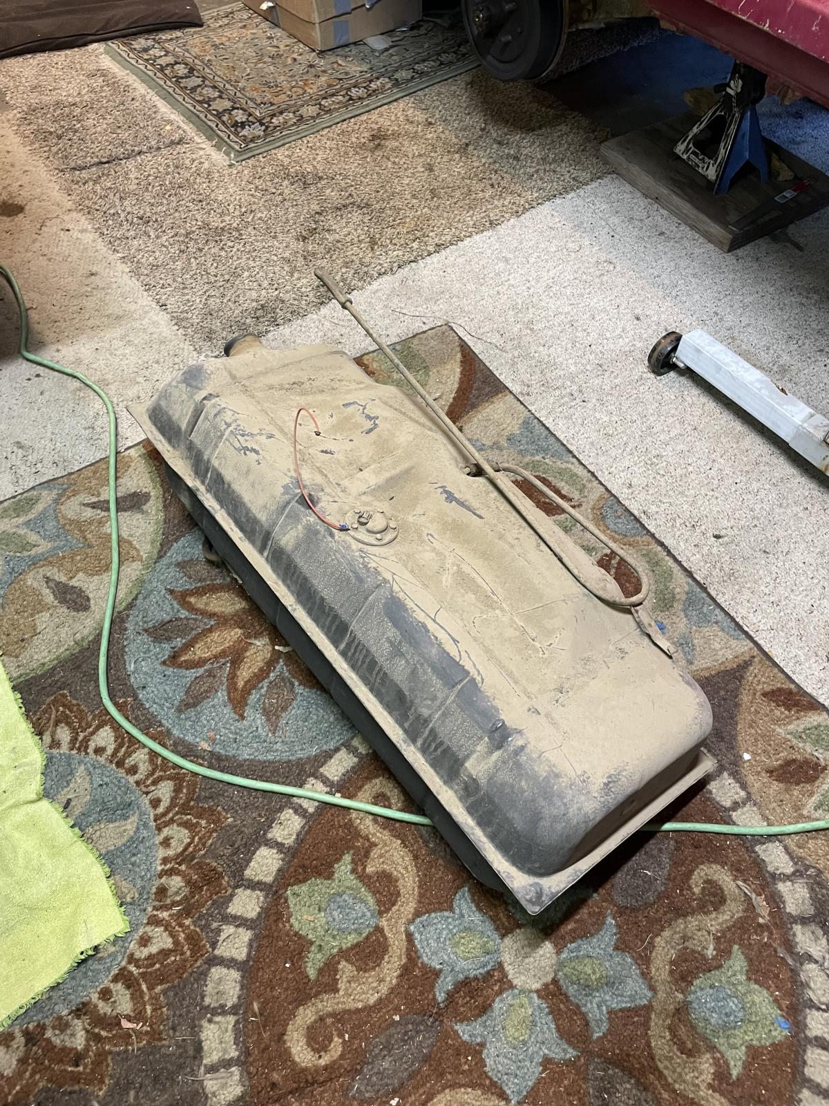

Good day. Drove the beetle to the ski resort and shredded 8-12” of powder all morning. When I got home I adjusted the brakes on the beetle and worked on Stew. I worked on the full flow layout for a bit, I feel like I got a decent layout planned and need to do some more research.
Then I turned to the fuel tank. Unfortunately the studs that hold the straps down broke while attempting to loosen them. Bum deal, but I’ll figure out a work around. Upon removing the tank I noticed it was aftermarket, probably why it didn’t fit very good and it sucks that there’s no sock on it. Somewhere along the way a ground wire was installed on the sender, I’m guessing it stopped working at some point. The exterior of the tank was filthy, but the interior looked pretty good. I pulled the sender and preformed Telafords repair. I don’t remember what it does, but I know it makes the sender work. Then I scrubbed the exterior of the tank and cleaned the interior with acetone and some chain links. I think I’m gonna order a new filler hose and tank to body seal.
While I wait for the parts, I’m thinking maybe I’ll crawl back in the tank compartment and clean it up some. I vacuumed it today, but it could use a good wipe down.
Filthy tank
It cleaned up pretty good
Interior of the tank isn’t bad, bummed about it not having a sock
Sender repair
I’d be more bummed about lack of slosh baffles. Not sure if any aftermarket ones do, tho. I’ll have to dig my Wolfsburg West one outta the rafters and check. You can put a screen on the fuel tap. And the sender always has a ground attached to it, but possible PO moved it somewhere different than stock.
Did you test the sender after repair? I managed to get one messed up by holding heat to it too long…

^At this point I’m not worried about not having baffles or a sock. The tank is clean, that’s the most important to me. I will be using a metal fuel filter not a clear plastic one. Who knows what type of service this is gonna see and if it becomes an issue I’ll look for a new tank. But, for now and most likely forever it’ll be fine.
I did test the sender repair with a meter and it worked as it should. If it doesn’t work when I get it all back together, I’ll deal with it then. I do have the ground wire and leaned more about it after I posted about it, good looking out!
