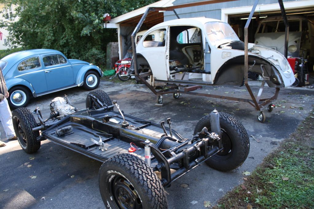

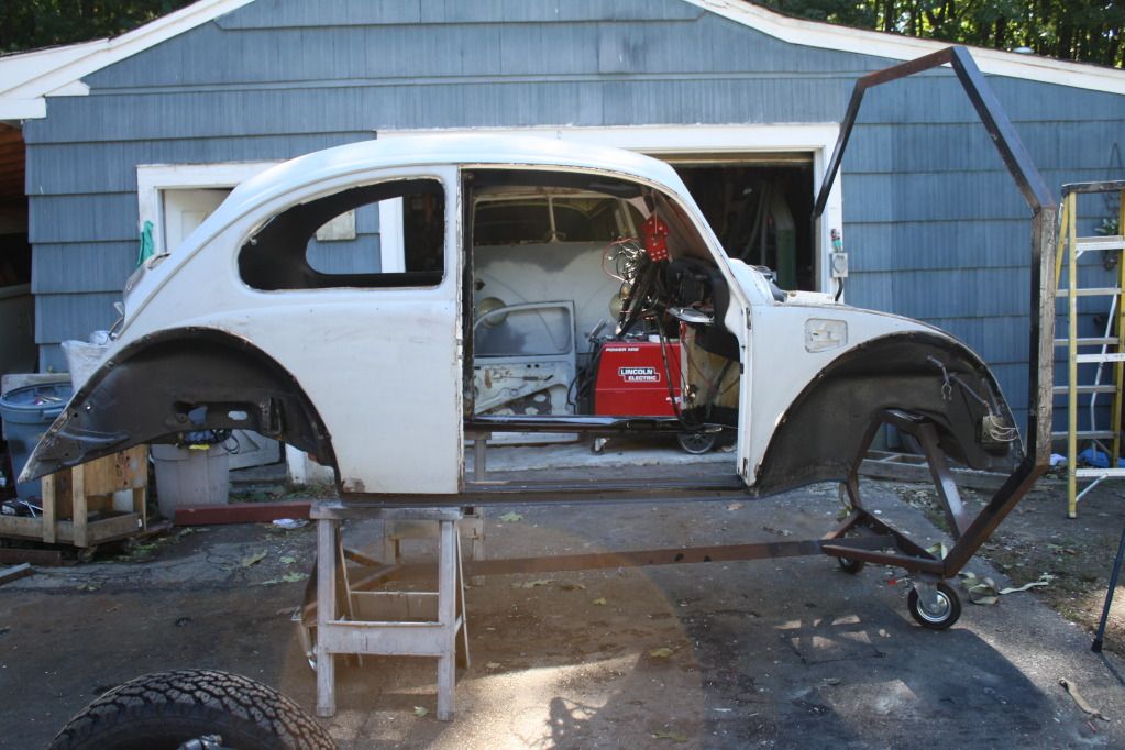

Made some great progress over the weekend!

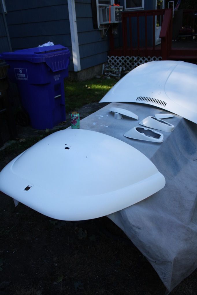

I was able to get a little paint on a few miscellaneous bits on saturday.
There were some runs, and some missed spots. I'm going to have to re-paint a couple things. I'm going to wait until the rest of the car is ready for paint before that happens.

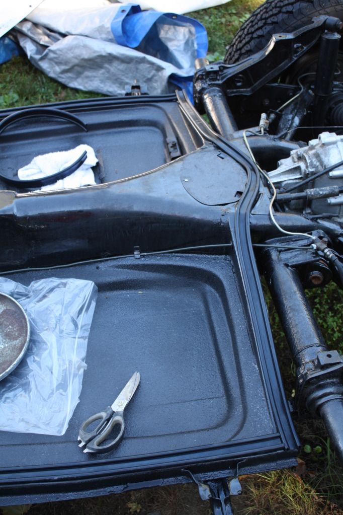

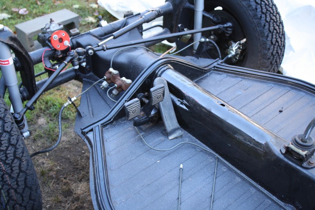

Installed my body-to-pan gasket (held in place with a little butyl tape)
I'll let these pictures speak for themselves...
Body back on! Wooo!
Had some slight trouble with the bottom of the heater channels hitting on the seat rails. A quick slice with the cutoff disk took care of that.
Now I'm trying to get the body all bolted back on. I should have chased the threads beforehand, it's turning out to be a little troublesome. Luckily the holes in the floor pans and the heater channels line up pretty well!

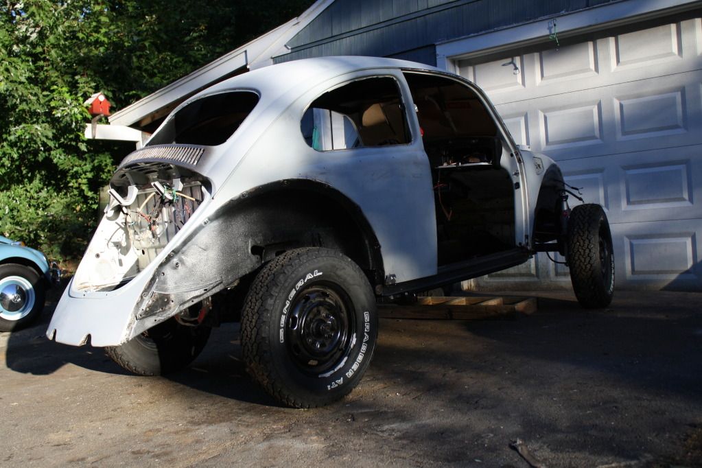

PostPosted: Sun Sep 30, 2012 4:58 pm    Post subject: Reply with quote

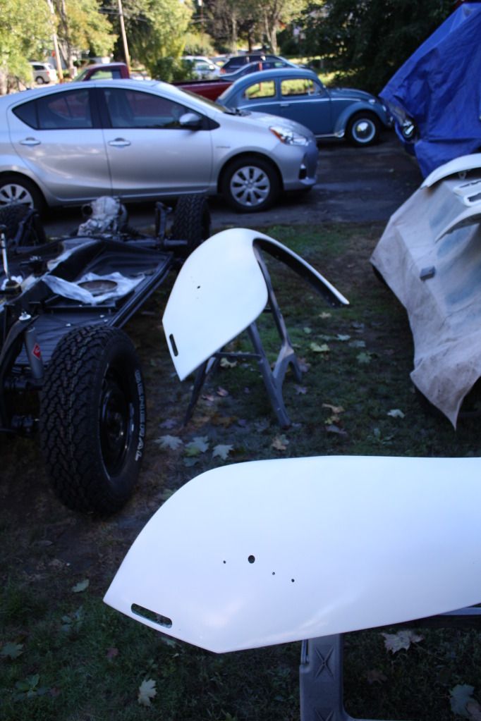

I bolted up my front fenders the other day so could work on them more easily. I snapped a quick pic, it really shows how radical it's going to look Twisted Evil
It's been raining the past few days, so I've been doing stuff like fitting the rubbers into my pop out windows.
