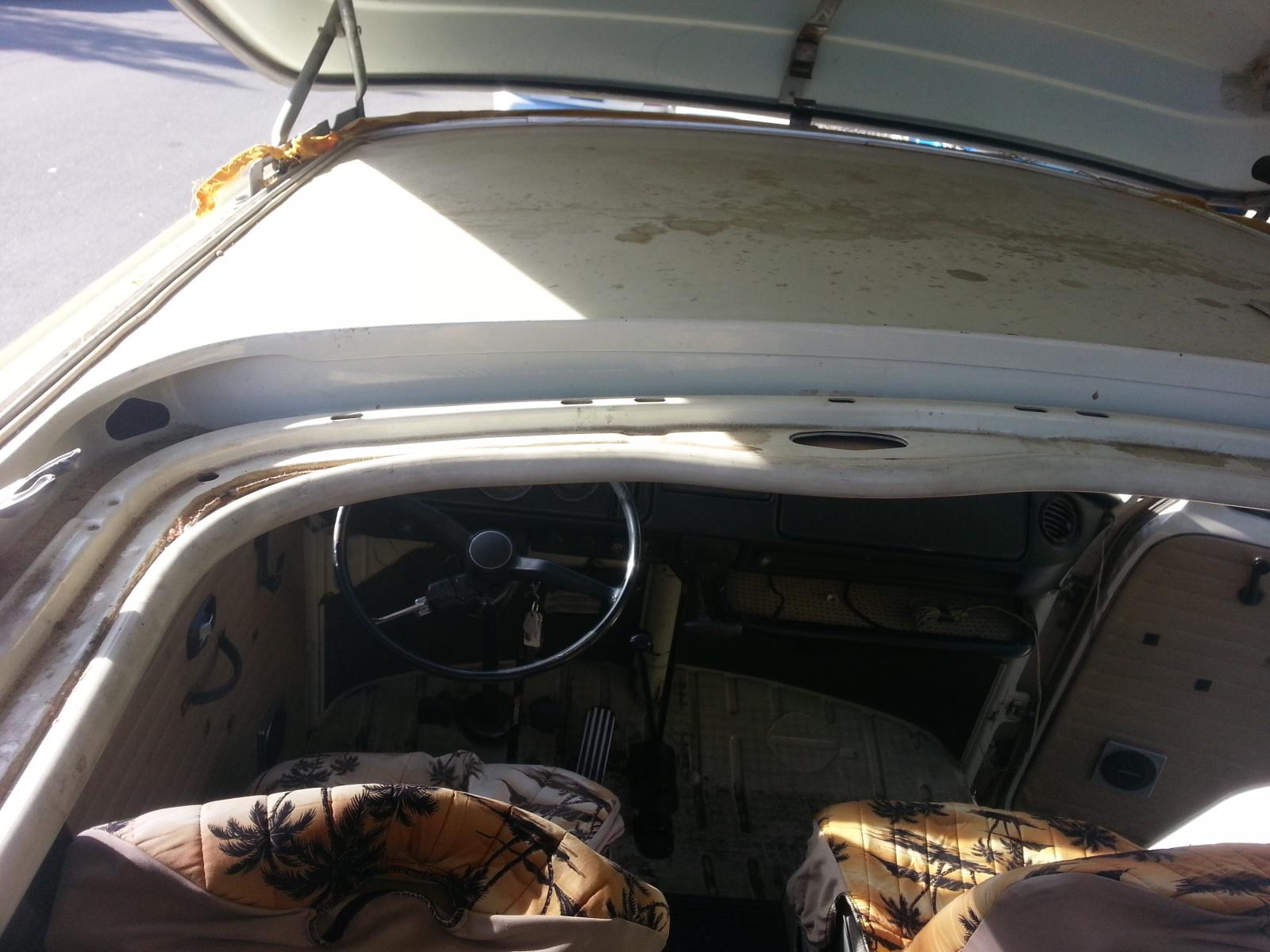

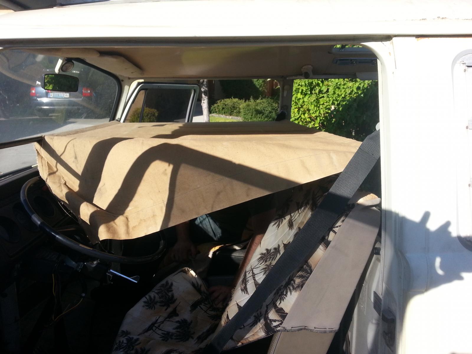

What are the bars on the hinge things in the top of the pop up? Also is there supposed to be anything up there besides more head room?

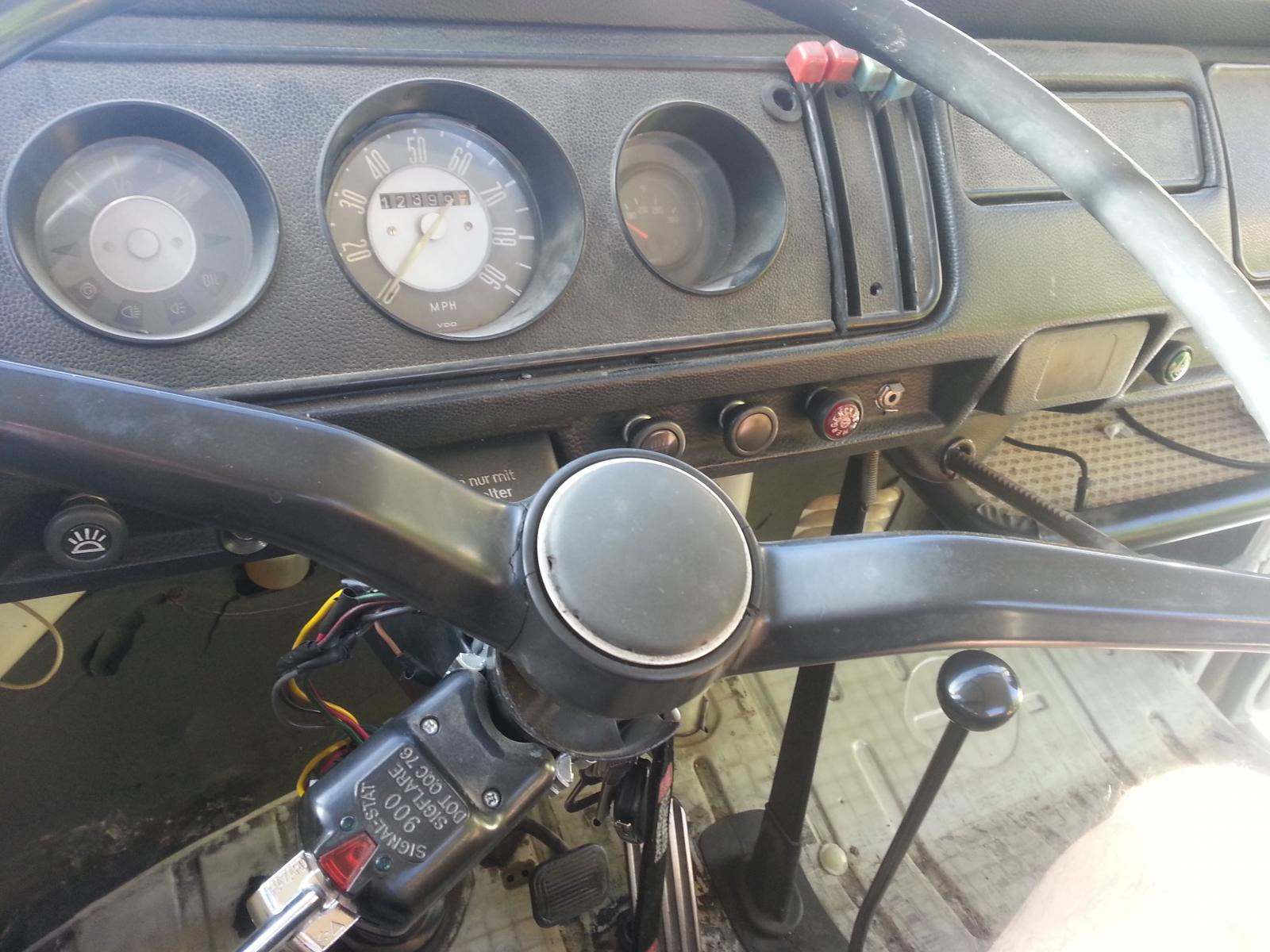

Man.....with all the 70's popping up lately, I feel like we need to start a 1970 club! What is the deal with your turn signal switch?

not sure. Some hack job aftermarket turn signal attempt.. Not sure how its supposed to look or what supposed to be on there but there are a bunch of wires. Most of the lights work.

It has a folding hammock "cot" up top needs cot material to be sewn on. I think Porsche 944 front disc brakes fit. The aftermarket kits to make them disc are pretty spendy and rare! Looks like it's a single port 1600 which should get a little better gas milage. Be nice to rebuild it as a 1971 Dual port engine though! Keep your eye's open for a rebuildable core complete dog-house engine! (Got to have the 3 point rear mount holes in the case!) Or if you have a good dual relief case you could just buy the dog-house fan shroud etc and put dual port heads on. The Dual DRLA or IDF carbs are the way to go on these early bay window busses like ours.
It great that you got a camper! So nice to have a camper! We never want to drive our other cars.
