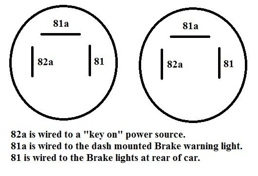

113 945 515 H brake light switch 2 prong
68-69 T2 Three 2 prong switches. Two switches for brake lights, One switch for brake warning light.
70-79 vehicles Without brake warning light
113 945 515 G T2 brake light switch 3 prong
70-79 T2 vehicles With brake warning light
Spanner Size: 24
Width [mm]: 24
Length [mm]: 48
Thread Length [mm]: 9
Thread Size: M10x1 konisch
Mounting Type: Plug Connection
Number of Poles: 3
Operating Mode: Electric-hydraulic
Brake Light Switch Wiring
1968-69 Brake light switch wiring
1970-71 Brake Warning Light - Early Syle - Push Red "B" To Test
From 2-terminal to 3-terminal, brake-light switch & warning-light upgrade circuit
Key to diagram
A = electric switch inside brake-circuit-failure warning-light unit
B = 3-terminal brake-light switch
C = Dual-circuit brake warning lamp
a = blue cable to brake-circuit-failure warning-light unit's
internal switch-terminal 61 (shared with ignition warning light)
b = black cable to fuse-box terminal 15
c = brown cable to Earth (i.e. Ground in USA parlance)
d = black/red cable to brake lights
Parts Diagram
Brake Light Switch Technical Article/ Eric Huelsmann
http://www.huelsmann.us/bugman/brake_light_switch_tech.htm
http://www.airheadparts.com/vintage-vw-parts/vanag...13945515-h
http://airheadparts.com/vintage-vw-parts/vanagon-s...13945515-g
