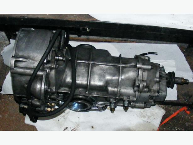

PostPosted: Wed Jul 06, 2016 4:27 am    Post subject: Official WTF Transmission do I have/should I get thread Reply with quote
Focus will be on Type I swing and IRS from 61-79 and Type II from 61-67 EXPORT (U.S.), other markets varied considerably. I wont go into 60 and earlier split cases, 68 and later bus boxes, automatics, or autosticks as those should be topics all to themselves.
Additional info on available gear ratios both stock and aftermarket will also be discussed as some regular posters seem to cut and paste their response to “freeway flyer” questions without giving any usable information beyond stating that it’s a marketing term originated by a now bankrupt business.
Sorry still no trans code listing but since the majority of axles you will come into contact with today are far from virgins The likelihood of the components being what the were when they left the factory is very low which makes the codes virtually useless.
Pics have been collected from various sources, ads, gallery, google images etc. If your pic is used and you wish it to be removed just let me know and Ill find one to replace it or list owner info if provided.
This other transmission thread has been going on for some time now with great info but since its in the offroad forum many don’t even know it exists.
http://www.thesamba.com/vw/forum/viewtopic.php?t=143138
Ill copy the basic identification info from the first post here as the pics and descriptions are pretty good and add a bit more specific data that people seem to ask for over and over.

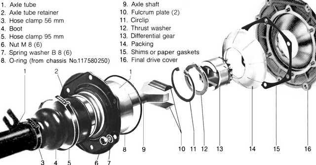

Short Axle / Short Spline up to 1966. 3 5/16 inch from bearing sholder to spline end
Long Axle / Short Spline 1967 only. 3 15/16 from bearing sholder to spline end
Long Axle / Long Spline 1968 only.
Two sets of axle tubes:
Short tube 3 3/8 inch from spring plate mounting surface to backing plate mounting surface
Long tube 4 5/8 from spring plate mounting surface to backing plate mounting surface

*Note: The one on the left is from '75-up, and the one on the right is from '73-'74. As far as I know they are the same except for the case differences.
Found in the '73-up Bug. They have a 3.88 R&P ratio.
