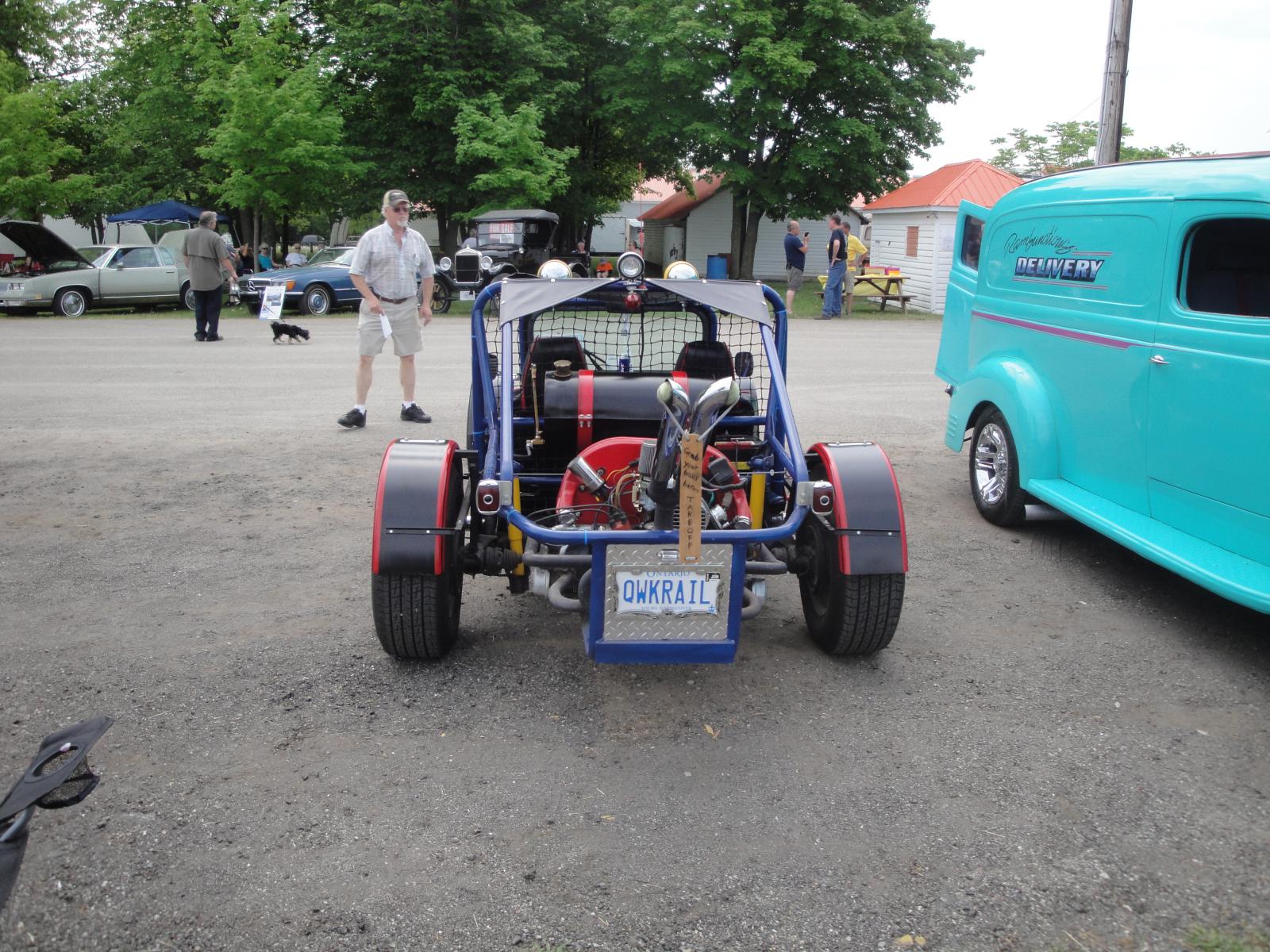

I saw this shortened cable on a Dune Buggy at a show I attended a few months ago. If you zoom in on the cable you can how the owner cut the cable and reconnected the shorter pieces:

I'm curious if he experiences any issues from the lack of Bowden tube....
Any idea of the purpose of the cross cable with the turnbuckle?

PostPosted: Thu Aug 25, 2016 6:39 pm    Post subject: Re: Shortened Clutch Cable Reply with quote
I didn't have a chance to talk with the owner, the picture was taken not too far from you, in Smiths Falls.
But I did get some more pictures of the Dune Buggy:

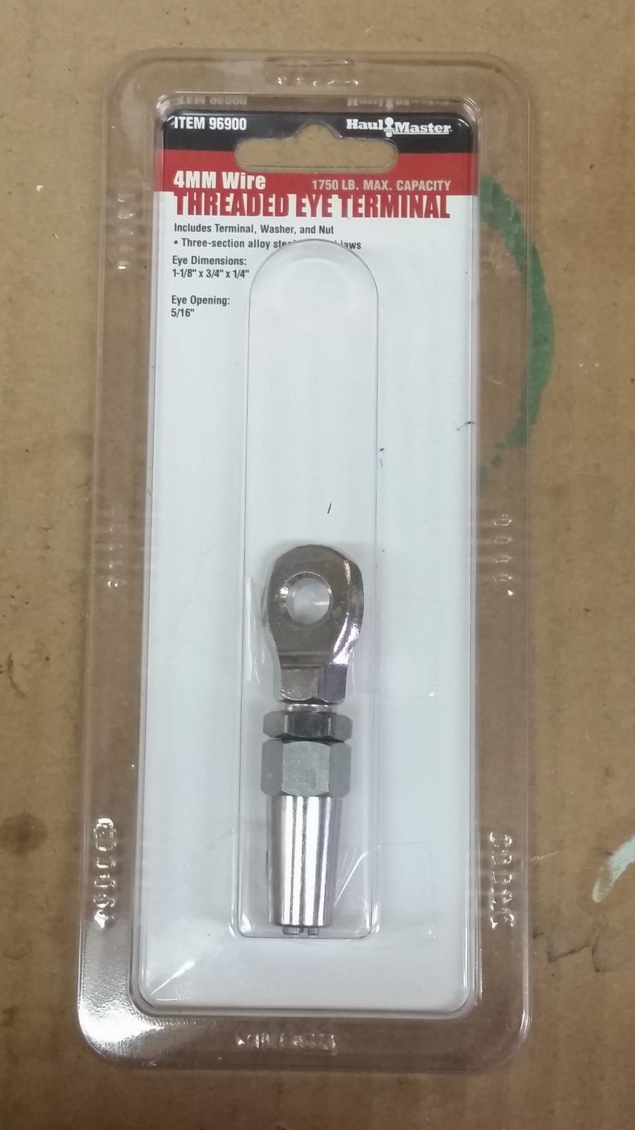

Here's what I came up with to shorten clutch cable. Happened to see the cable compression clamp at Harbor Freight. Cut off the eye in bottom of picture. Welded on bolt. Rethreaded stock clutch wing nut to fit. Has been on for about a year no problems at all with a long clutch arm and Kennedy Stage 1 plate.

Only problem is when ever I see this fix I go to HF site and can never find the silly cable clamp........

PostPosted: Fri Aug 26, 2016 8:24 am    Post subject: Re: Shortened Clutch Cable Reply with quote
Dale, I agree on trying to find this clamp at Harbor Freight online. I just happened to see it while browsing at my local Harbor Freight store. Seen them and thought maybe it would work for shortening clutch cable with a little work. If I recall it was not very expensive. If it didn't work not out mucn $.
Next time I go into me local H.F. store I'll see if they still have them and if so I'll get and post the H.F. Item #. Incase anyone else is interested.
I know this style clamp is also available at some marine, sailing rigging stores but they are rather expensive.

PostPosted: Fri Aug 26, 2016 7:49 pm    Post subject: Re: Shortened Clutch Cable Reply with quote
I went to HFT and i could not locate the cable compression clamp.. can you post a pic of what it looked like before you cut the eyebolt ?

PostPosted: Fri Aug 26, 2016 9:26 pm    Post subject: Re: Shortened Clutch Cable Reply with quote
They look like this.
http://www.harborfreight.com/media/catalog/product...e_8481.jpg

PostPosted: Fri Aug 26, 2016 9:55 pm    Post subject: Re: Shortened Clutch Cable Reply with quote
Yes, that is the exact same one in the posted link above. Still could not find the H.F. Part # online. I will post part# if my local H.F. store still carries them.

PostPosted: Sat Aug 27, 2016 5:35 am    Post subject: Re: Shortened Clutch Cable Reply with quote
Look for swageless stud. All I had found were stainless ones that were pretty salty....Pun intended.... Laughing

PostPosted: Sat Aug 27, 2016 3:44 pm    Post subject: Re: Shortened Clutch Cable Reply with quote
Stopped by my local Harbor Freight today they still stocked the cable fitting.
The H.F item# is 96900. Cost was $7.49. These are also stainless steel. Tried using item number on their website search. There it was. At least with the number if you stop by a H.F. store they can look it up and see if they stock or can get it.
Usually in these stores not many clerks really know what all they stock. They are located with the rolls of wire rope and accessories. Picked another one up myself for parts box.
