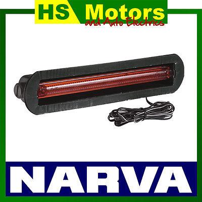

PostPosted: Thu Mar 09, 2017 3:21 am    Post subject: Re: Third brake light Reply with quote
Old post, but I have just mounted this at the bottom of my rear window. Wiring through the rear demister vent and double sided tape of the light to the glass means no extra holes.
It is slightly longer than the rear vent by about 20mm. The LED bulb can be rotated to suit the angle of the screen. I've got it mounted but forgot to take a photo of it. Will take one next time I'm there with it wired up. The 'box' minimises any reflection off the glass.

PostPosted: Fri Mar 10, 2017 1:54 pm    Post subject: Re: Third brake light Reply with quote
Here is it installed, Narva part No 84650BL.
