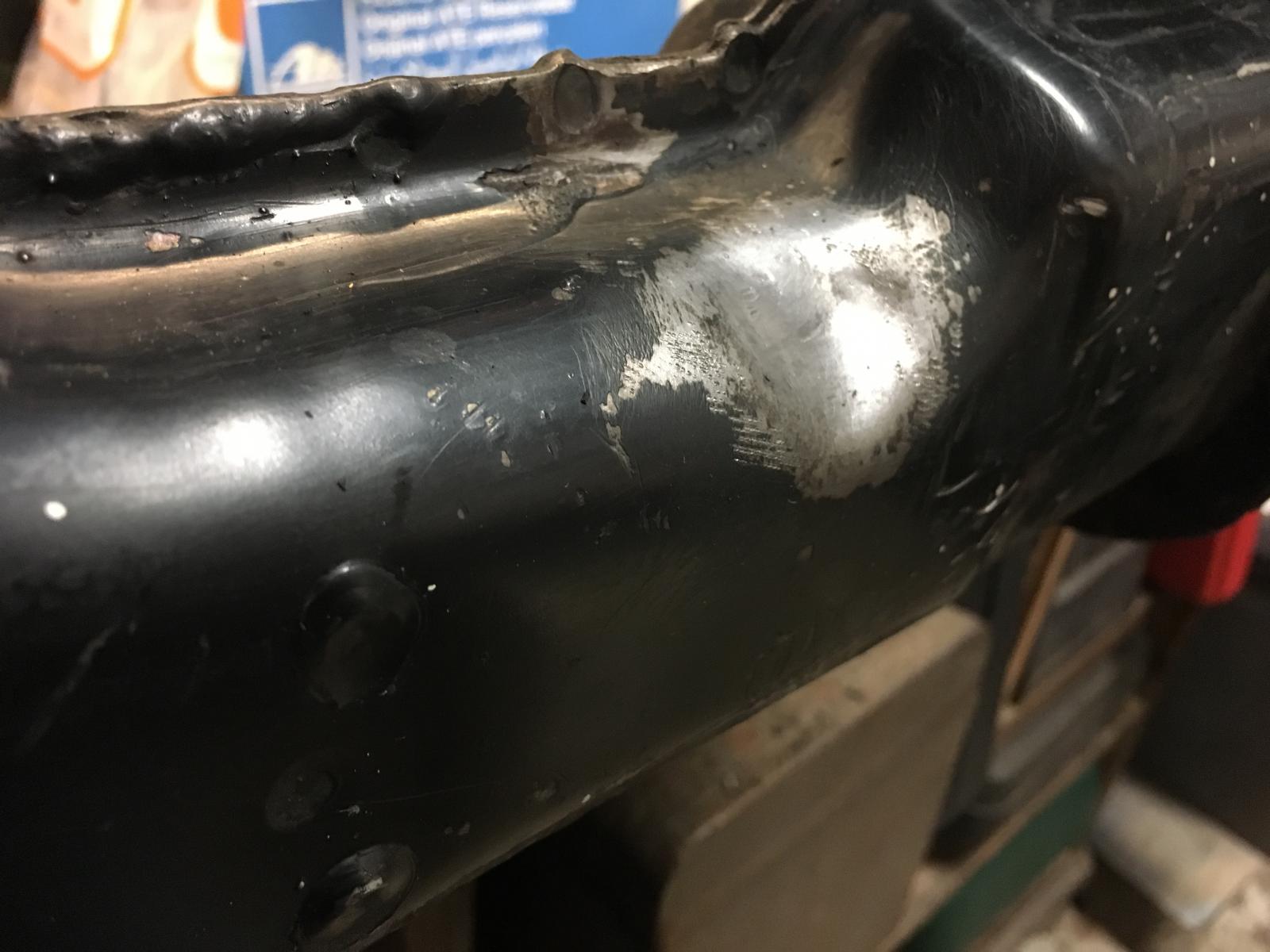

I also picked up a really nice, low mileage front beam at last! While cleaning it up, I uncovered a dent (just slightly larger than an M10 bolt head) in the lower section just under the steering box mount point. First I thought no biggie.... until I tried removing the torsion arm and rod. It pulls free from the splines just fine, but the dent prevents the the spline end from passing so I can’t extract the assembly from the beam.
Would you more experienced folks weld a bolt and try and pull it out or what might be the best way to remove that dent?
Here is the rascal causing trouble and also the original inked serial number and a stamped #2 - anyone know of the serial number is specific to a car or year? Does the 2 signify anything?

You might want to talk to Mario about it. I only say that, as you could weld a bolt or something into the dent, but you'd need a rosebud tip on a torch to pull it out. The big problem is the inner bush right next to that dent is phenolic, and might burn from the heat needed to get the dent out. Yes, I do realize there's a needle bearing inside for the trailing arms to sit on/in, but the bearing sits in the phenolic bushing. If Mario can get you a NOS bushing and a reamer, then I'd try and fix it. Otherwise I'd return it. That's just me though. I'll let the others chime in as well, and see what they think (like Tram and or Pedro).

Thanks Bob. I should clarify that the beam did not come from Mario. I found it from another of the sellers at the show. I’m thinking I can just tack a bolt on the dent and pull it with a slide hammer.
Do you think the heat from a tack weld would damage the inner bush?
I measured the trailing arm and bush location. The bush is about 17cm from the thrust surface inward and placed in the lower inner section. The dent is 14cm from the thrust edge and on the outer beam housing only so I’m thinking it will be ok. Thoughts?
Put a wet rag between the dent and the bushing. Closer to the end of the bushing to keep heat off the bushing, and you should be ok. Try to limit the amount of heat/time it's hot. Then give it a go. You might get lucky and it'll move just enough.

I know from experience that the phenolic bushings in there won’t survive the 400F or so associated with a powder coat oven,
So be careful.
Unless you can find another bushing to push in there afterwards..
It would surprise me if you can get that dent out without a lot of heat,
Unless it’s a good distance from the bushing.
Maybe there’s room for a wet rag or that asbestos packing that welders use..?
Might be able to get a bolt welded to the bottom of the dent,
And then grab it with a slide hammer..?

I -think- it was ‘Yabbadubbadoo’ or someone in Oz who had made these bushings?
Ideally, you would put in a whole new set of bushes, right?

I wound up making inner bushings out of oil impregnated bronze.
https://www.thesamba.com/vw/forum/viewtopic.php?p=...ze#7984686
So be careful.
Thanks for the info. The bushings and trailing arms are in good shape, show no significant wear. Inside of the beam is very clean and packed with grease so that will be fun cleaning. My plan was to clean and paint the beam not powder coat it.
I’ll shove a wet rag in there, weld up a bolt on the dent and pull it. The dent is not at the bushing location.

Dlglobal1 wrote:
So be careful.
If everything is good clean and tight, I'd be tempted to leave the dent alone. It would be a shame to screw up an otherwise clean beam.

Progress is progress....finally finished restoring beam #3. The dent came out very easily. Welded a bolt and gently rocked it until the dent was gone.
I cleaned all the old grease out and checked the bearings and bushings which were like new. I used Superlube which seems very good. Cleaned and plated all the original bolts, new ball joints and it’s ready for install.
